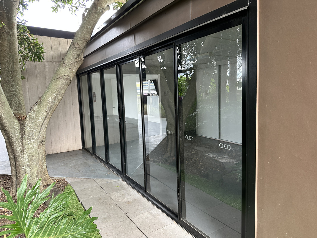

Post by Sockeye » 24 Nov 2022, 11:01 pm
Any input how to reinforce the giant glass wall of the workshop?
As a basic measure, a translucent film would be easy enough beginning.
Any additional physical barrier that comes to mind?

Steel mesh, still see through and still lets light in. A roller shutter would be better but dearer. Security door can be placed where needed.

Post by Sockeye » 25 Nov 2022, 8:54 am
Building a wall is an option, but messy and expensive.
I am thinking of translucent film on the panels and security system as a bare minimum.
Shutters or crimsafe screens are a second line possibility.

Post by Lazarus » 25 Nov 2022, 10:15 am
Sockeye wrote:Building a wall is an option, but messy and expensive.
Sorry Sockeye, I was being needlessly facetious, a crimsafe setup would probably be the go.
Still have a reasonable amount of light but less likelihood of some clown throwing a brick through that expensive plate.

Post by Die Judicii » 25 Nov 2022, 10:41 am
Heavy Reo mesh panels that can be bolted to the floor (? concrete floor) and ceiling behind the glass.
These can easily be removed (yourself) if and when necessary.
If you put in a security system make sure the camera/s are clearly visible on the inside of the mesh panels pointing towards the glass, as yet another deterrent.

Post by Sockeye » 25 Nov 2022, 1:31 pm
Well. The workshop is attached to the stand alone garage. The structures are deep inside the backyard and not very accessible/ visible by strangers.
Visual security is one of the primary issues here as any bad guy would be able to look through the glass and see a big ass safe inside the workshop.

Post by Blr243 » 30 Nov 2022, 8:06 am
If u use stick on security film that makes it harder to smash and harder to see inside , remember to think up possibby some improvements / additions eg extra heavy duty hasp and staple with good padlocks to the lock And hinge points .. you may have to think hard and improvise here. A three foot pinch bar with a long slender point angled at the correct angle will put tremendous force on any system and theieves will be inside in a flash
