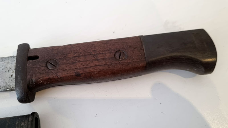

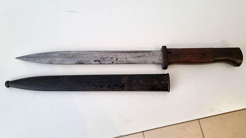

Hey folks,
I'm debating restoring my grandfather's WWII bayonet.
The blade is in pretty good shape. Virtually all surface rust, no pitting on the fingernail scrape test.
There's a bit more texture to the metal of the hilt. A bit of dimpling around the outside of the crossguard.
On the scabbard, about 40% of the paint is missing, and covered with surface rust where the metal is exposed.
Restoring the scabbard I guess is simple enough. A soak in a paint solvent, a scrub with fine steel wool, and a layer of paint.
Ditto for the blade, a scour with a rust solvent.
The hilt I'm not so sure about. There are nooks and crannies in it where the bayonet mounts, and also just beneath the cross guard. The screws through the timber.
Too complicated for a manual scrub without missing corners or damaging the wood further. Is there something suitable to soak it in to bring back the steel in the hilt without affecting the wood?
I'm no expert in such things. Interested to hear what people would suggest on methods of restoration for the various parts if I were to go ahead.
Cheers.
Lorgar

Evaporust rust is your friend. That stuff is amazing though dear - but it works! I de rusted an 1855 Lorenz muzzle loader (ex US civil war) with it and found a shootable antique under the rust.

Restoration will destroy the value of the bayonet, not that Spanish Standard Modells have a high intrinsic value but being your Grand-Fathers the sentimental value is beyond money. You want to preserve the bayonet for the future, as Noisydad said evaporust is good, but water is just as good and cheaper. Remove the grip panels (unscrew carefully, and tap the pommel with a hammer handle or piece of hardwood until the panels loosen, do NOT try to pry them off), then boil the bayonet and scabbard in water for about half an hour to convert the rust to black oxide then carefully card off with 0000 grade wire wool, or preferably brass wool, and fine oil (3 in 1 will do) then wipe off the panels with Renaissance wax and re-assemble. This method will stop active rust without ruining the original finish and preserve the item for future generations (hopefully of your own Family) to enjoy.

Sorry, missed a step. After carding, soak bayonet in kero or WD40 for a couple of hours to remove any water from the release button etc.

I am not familiar with evapo-rust but I suspect it is a water based chelating agent with similar properties to a 1:9 mixture of molasses and water.
Chelation, unfortunately in this instance, will remove every last skerrik of iron oxide from from the underlying steel.
A better way might be to immerse only the steel parts in a 10% to 20% solution of phosphoric acid dissolved in distilled water.
It will turn the rust back into iron and some of it will remain in the pitts and crevices in the steel.
