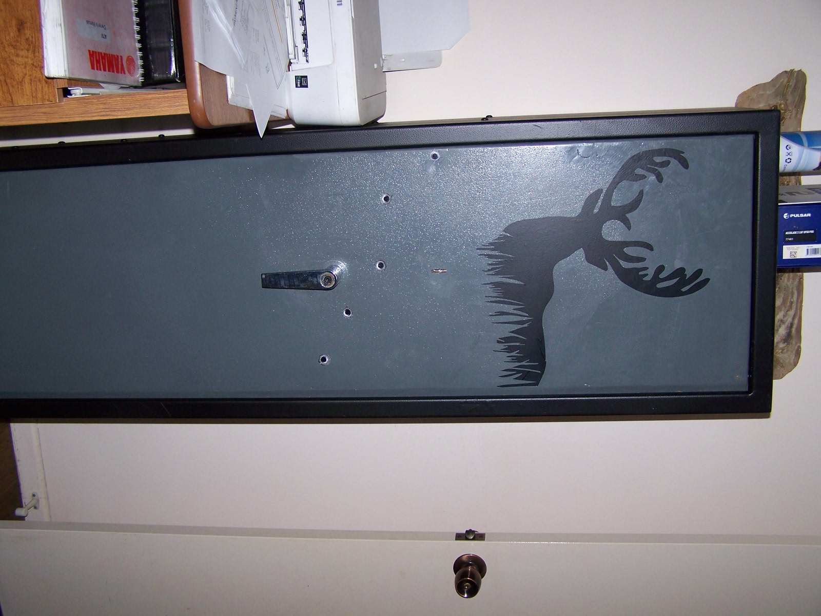

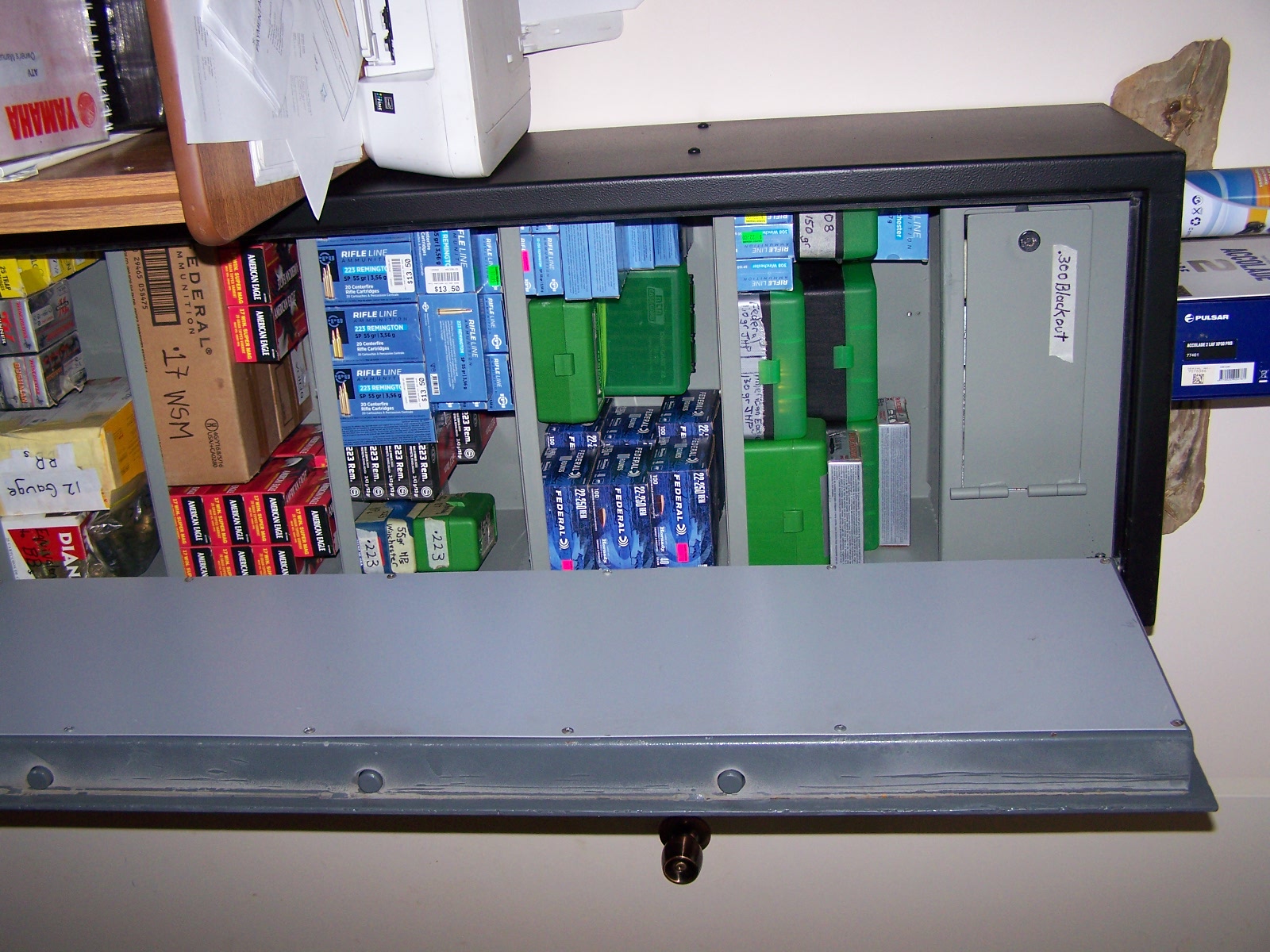

Post by Die Judicii » 28 Sep 2024, 1:42 pm
This used to be a cheap commercially manufactured firearms safe.
Now modified to 6mm walls, 12mm door, 20mm base.
Stores all my ammo.
Posts: 4036
Re: Options for ammo safes to store pistoles in
Post by Zman » 28 Sep 2024, 3:52 pm
Die Judicii wrote:This used to be a cheap commercially manufactured firearms safe.
Stores all my ammo.
I like it, Looks like you riveted plates to the sides and door?
Post by deye243 » 28 Sep 2024, 4:14 pm
I hope you have about the equivalent of about 2 square feet of vent holes drilled in that safe if not I would love to be about a 100y up the road if you have a fire .
I remember a bloke in SA that lost half his house because of that same sort of thing
Post by Die Judicii » 29 Sep 2024, 2:03 pm
Stores all my ammo.
Nope, all the extra plates were plug welded on and ground flush, although not all were perfect and some are still visible on the surface. What you are thinking is rivets are the dome heads of bolts that hold the shelves in place.

Post by Oldbloke » 02 Oct 2024, 11:43 am
deye243 wrote:I hope you have about the equivalent of about 2 square feet of vent holes drilled in that safe if not I would love to be about a 100y up the road if you have a fire .
You are 100% correct.
If your ONLY concern is security, by all means use a heavily constructed safe/box.
HOWEVER, be aware that if you do that you are making a bomb. (W.A. must be run by idiots if its true a safe is mandatory.)
The recommended way to store ammo, powder etc is in a container that will VENT in the event of an ignition. House/shed fire is a perfect example.
Lightly built wooden or thin steel containers are ideal. I use the old school steel lockers, they are well vented and hinges are light weight. If it's steel, ideally it should be earthed in some way. BTW concrete is a very poor conductor and cannot be relied upon as an earth.
You just have to look at packaging manufacturers use. Its very light in construction. They are required to comply with dangerous goods requirements.
