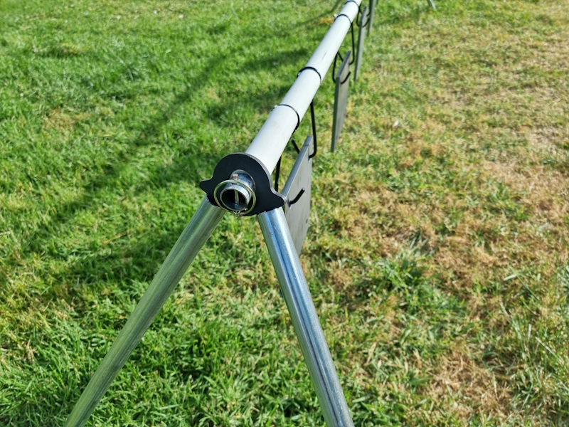

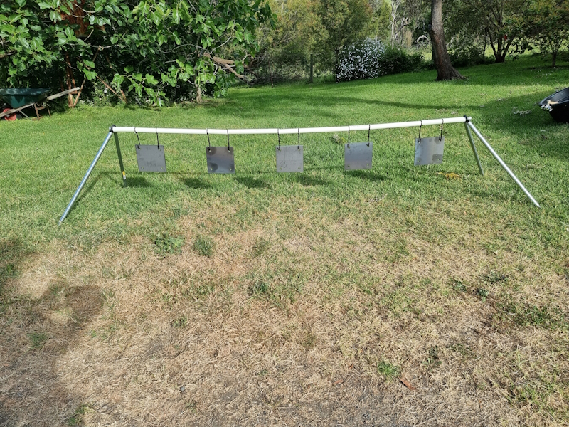

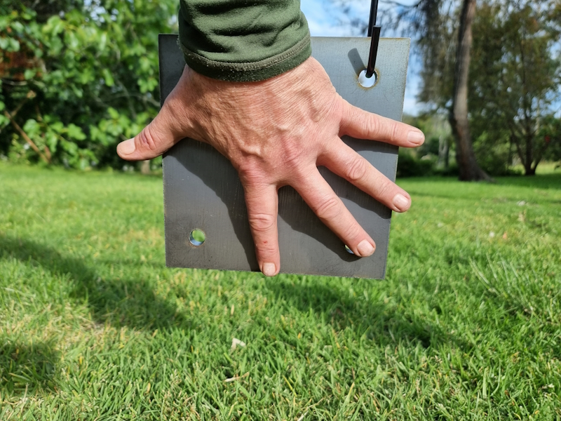

I put together a target rack for practicing Cowboy Action. They're generally shooting at 400mm by 400mm plates either square or diamond from about 3m to maybe 10m at most. I don't really see much value in practicing on targets as big as that under 100m, it's not going to improve any practical skill, other than hip-shooting. So I want to practice on plates about 200mm square (a quarter of the size of the Cowboy plates). Surdex do column foot plates so I grabbed some today. 200mm by 200mm and 10mm thick, with a 10mm hole in each corner. I bought some 8mm plates a few years ago but they only had 10mm today, $23 each (they also do 12mm). I couldn't find them listed on the website but the invoice calls them "BPP Base Square 200x200x10 4xHole".
It starts with the Temu rack kits with two Y-pieces and six hooks each. These would be very easy to make out of 20mm by 5mm flat bar if you're happy to do some grinding and welding, but for the price they're a very easy way to go. Temu prices can be all over the place so if you're happy to trawl through listings you can probably get them cheaper. The hooks are a luxury really, some fencing wire would do the job just fine, perhaps even better. The hooks are open so I'm not convinced the plates will stay on with .38 Special or heavier. I shot some 8mm plates hung on chain last week with the .38 at about 25m and it wrapped them around the bar, these might just pop off the hooks, I'll find out soon. If they do I will probably swap the hooks for fencing wire.
I decided to space the steels at 500mm centres so I cut (wood saw) five lengths of poly 140mm long for spacing between the hooks, and four 350mm for spacing between the targets, with two more at 150mm to keep them from migrating to the ends of the rack. I cut the pipe (battery angle grinder) to 2500mm and threaded them all on, then drilled (battery drill) a 5mm hole through each end and put lynch pins on (just because I have them, three-inch nails or tek screws would work just as well). I cut the second pipe into four 750mm legs. I'll have to get another length of pipe to make the big single-plate rack legs. I didn't bother drilling holes to lock the legs on figuring there'd be enough weight in the targets, but I'll find out if those are needed soon enough as well. It took me about ten minutes, I did it while waiting for three 60-litre drums to fill with water. Hopefully I can get out tomorrow for some testing.
Two 3m lengths of one-inch galv steel tube for $22.20 each - https://www.bunnings.com.au/metal-mate-25-4-x-1-2-3m-galvanised-steel-round-tube_p1130457
A 3m length of 25mm poly pipe for $20.20 - https://www.bunnings.com.au/holman-25mm-x-3m-class-12-pvc-pressure-pipes_p4770099
And a pair of target rack kits from Temu for $35.50 each - https://www.temu.com/au/---steel---kit--1-2-shooting--set-for----g-601099656979956.html
Plates $115
Pipe $44.40
Poly $20.20
Rack kits $71.00
Total $250.60 (I still have two Y-pieces, two hooks and a length of 1" pipe about 480mm long to make another rack for a large plate - perhaps a plow disc)

Post by bladeracer » 15 Nov 2024, 5:53 pm
I ended up drilling the legs and put R-clips through to retain them, just to make it a one-hand job to move it around.

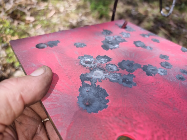

But I finally managed to put some lead spatter on them. They're going to be mint I think. This was just four fifteen-round tubes with the Henry .22, double-taps and what I think Cowboy calls "Continuous Nevada" where you simply run back and forth across them with no doubles - 1, 2, 3, 4, 5, 4, 3, 2, 1, 2, 3, 4, 5, 4, 3. I'll have to try Shorts for 22rd runs. At about 12m as fast as I could hold a sight picture, no misses. With the .22, the targets barely move at all.

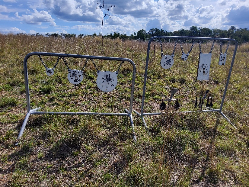

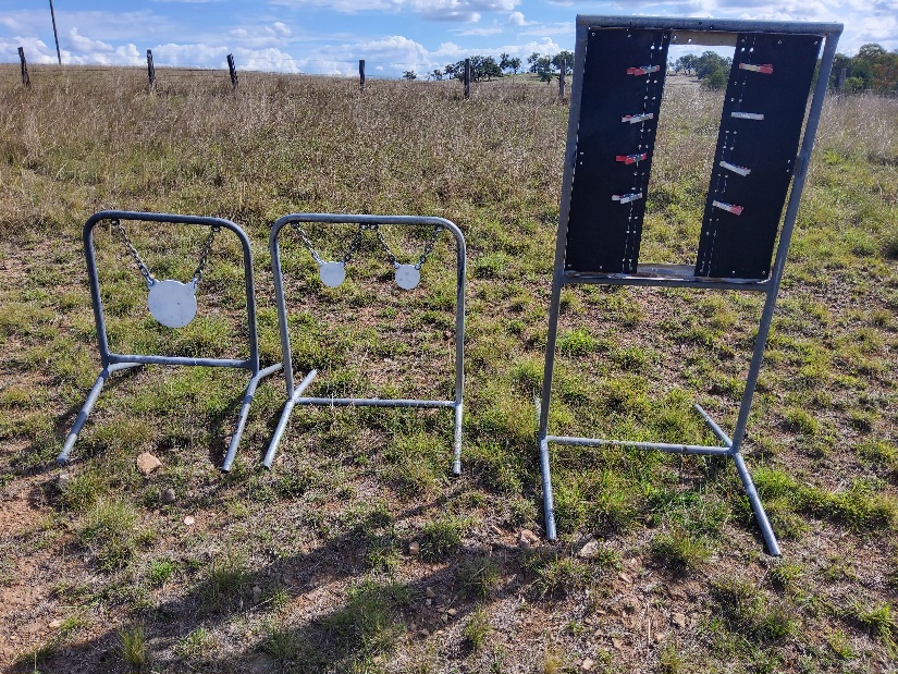

Everything's wet here mate. Heaps of storms over the last week, one dumped 92mm. Dams all running over for summer. Don't need firewood atm, air-con is the go with the heat lately.
I used to use mild steel offcuts (MS250) but unfortunately 243, 308 punched holes right through that at 100m, so I gave up and used Bisalloy offcuts from the coal hoppers and buckets we made. Lately I've just taken to buying Bis500 2", 4", 6" and 12" 10mm thick shooting targets online. They handle everything however I shot a hole through one just checking a 300WM before going off for a walk the other day.
Example below, the squares are 25mm thick and have the chain welded to them. They are shot almost through, whereas the Bis is just pockmarked.

Post by Wapiti » 17 Nov 2024, 6:14 pm
These frames are just made from 25nb galv pipe (med, sched 40). The chain is from a bucket of transport chain, high tensile stuff, and I just used small, rated bow-shackles that fit the holes cut in the round bis plates. Bunnings sell the bow shackles. The chain is just welded to the pipe.
When they can swing, that really takes a lot of the shock from the hit of the centrefire bullets.

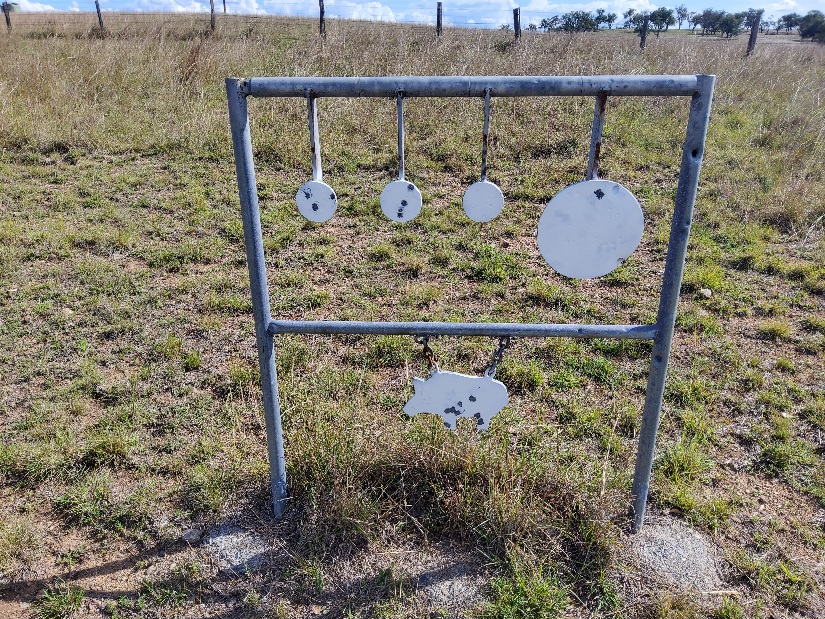

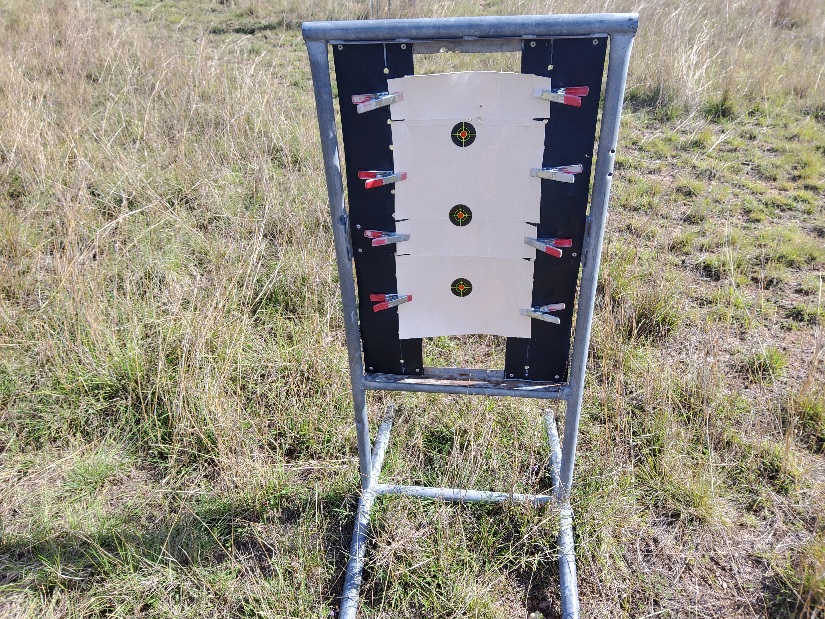

Post by Wapiti » 17 Nov 2024, 6:18 pm
This is a second frame that I use for testing loads, The black poly on the sides has slots cut in it for the spring clamps.
The poly is cut from offcuts of the 3m thick black poly sheeting we use to line the yards for the deer, they freak out if they can see through the cattle yard panels.
I used to use ply bolted to the frames, but it gets all splintered and rots and then the staples don't hold the targets in anymore.
I just use the boxes that large Weet-bix comes in, opened up and I stick 25 and 50mm stick-on splatter target circles on them, depending on the magnification of the scope. You can get a ream of A4 sheets of these off Ebay really cheap, and the postie drops them off.
I don't eat cereal, I use the Weetbix to train bull calves and young stags, they love them.

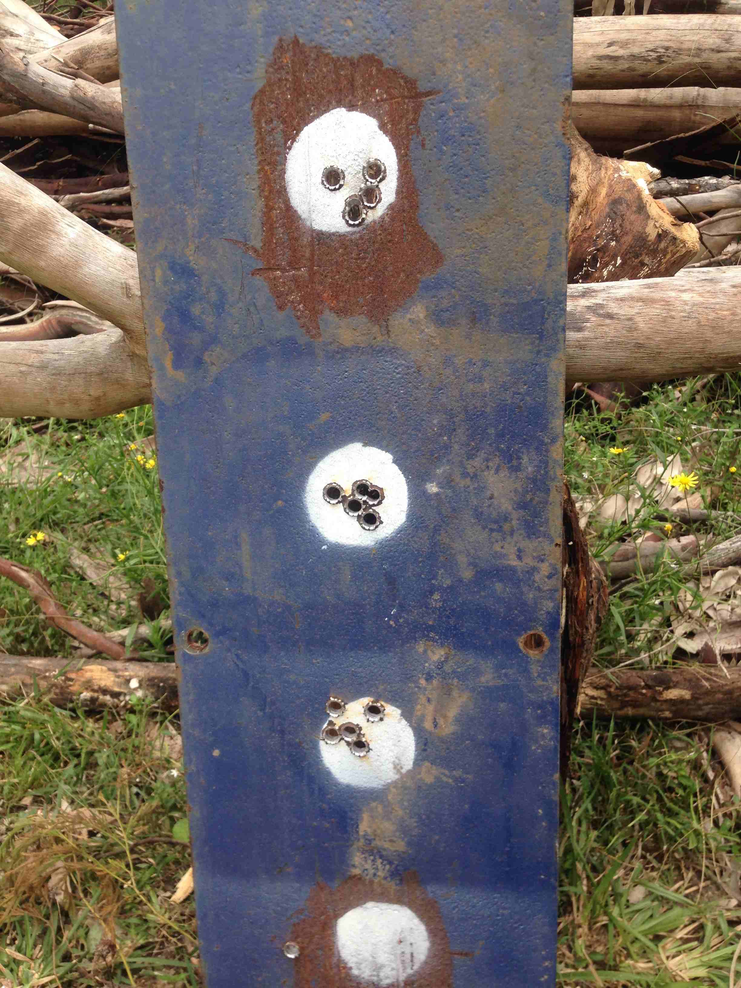

And a 20-year-old target frame across the dam from the house, it's pipe too. The targets are 12mm mild steel plate, and have 50x12 flat bar welded to them so they hang sufficiently lower that the top where they pivot when hit (32nb pipe slipped over the 25nb pipe, so they swing).
The pics are crap to comply with the size limit here, and you can't see it but each target can swing individually.
A mate came out with a 38-40 Winchester 95 and hit the big circle twice, dented it badly.
Mild steel is for rimfires and pistols under 44 mag.

We put some jacketed 158gn .357's on the plates today at 18m and they left pretty good craters, so we we'll restrict the .357 to the AR/BZ plates. The .38's did no damage at all.
The poly pipe I used to keep the targets separated was fine with several hundred .22's, but the .38 shrapnel just blew the pipe apart. So I'll have to replace that with steel pipe, or use hose clamps, but then I'll need a tool to disassemble it.

I gave up and just bought the Bisalloy in the end. I'm not into experiments, like what's been said, shooting holes in stuff is to be avoided.
I cut some boar shapes out of 12mm MS250 and hung it on chains from my usual bent-pipe frames, and at 500m, lasered, my 300RUM 220gn M'Kings and 338LAPUA 250gn M'Kings punched right through it without a clang. Gave up and used head-sized balloons stapled to logs.
With Bisalloy and Hardox, the higher the number the more wear resistant but the more it's brittle. So think of Dozer cutting edges, they are usually Bis 80 or similar because they take big hits without shattering. Bis 500 like is in shooting targets shatters out holes that look just like a punch has made the hole when hit with high speed high-energy bullets, unlike MS which melts from the high heat from the impact... as you see the frozen star crater that is formed when shot.
I have a 12mm sheet of Bis 80 and I reckon a few pig targets cut from it will be the go, yet to try that. I was surprised when Bis 500 targets became popular, I think 300 or so may be better.

The .264 WinMag gives my 12mm AR500 plate a hiding but not enough weight to consider passthrough, suprisingly the .222 impacts about the same as the .264 leaving 2mm deep craters. The 45-70 hits hard but just splats without any imprint on the steel, all the other calibers about the same.

I didn't measure the .357 Mag holes but they were very noticeable, the caldera around them makes them at least 2mm deep I would say, but I didn't notice any deformation to the back, it is 10mm thick after all.
Yes, I already have a lot of BZ/AR targets, I'm just looking for mild steel for practicing close-range Cowboy shooting, and for long-range targets that don't need to be hard. I have a 1200mm square of BZ450 5mm plate that I'll eventually get around to cutting up for smaller close-range targets but I want to make a bunch of long-range targets that I can leave out in the paddock. The targets I have now are a decent ute load to cart out.
A full 2400x1200mm sheet of mild 5mm plate is $350. It's big enough to give me twelve torso-size plates of 600x400mm for $30 each. I could put half of them out at 400m+ for high-velocity scoped rifles and half at 50m to 200m for open sight .22LR and lever-action practice.
