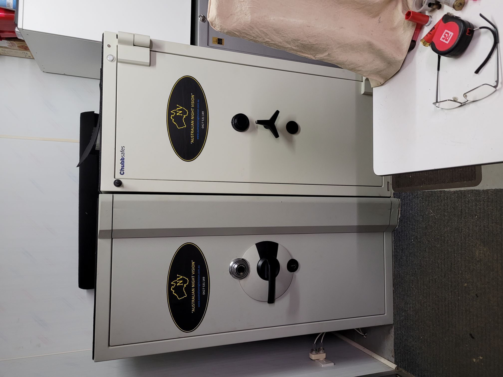

Re: What's the CHEAPEST Solution of a 150kg Safe?
Post by niteowl » 15 Mar 2025, 9:15 pm
Not the cheapest but 1164 KG each
safes a.jpg (245.72 KiB) Viewed 12594 times
