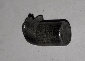

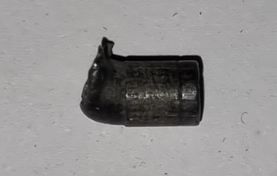

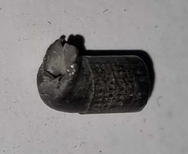

Dirt works well, but the mound will get blasted away, as the mound flattens you will get bounces across the top unless you keep rebuilding it or keep your targets very low to the ground which requires a much taller mound than you really need, and it's bloody painful digging all the bullets out of it afterwards. The "old dam wall" they always talk about during the safety lectures works great, unless your father-in-law buried the water pipe an inch beneath the surface :-)
Sleepers or logs also work well but will be blown apart over time.
A very deep pile of tyres works very well, but has a high degree of randomness built into it, some bullets likely will be bounced away, though how dangerous they might be will depend on the situation. I prefer to shoot where there is nothing around for many, many hundreds of meters in any direction just to be safe, in which case there's really no need for a bullet stop, they'll expend themselves bouncing across the paddocks (see Mark&Sam's videos for example, no back stops at all).
The best I've found is sheet rubber, as used in mining conveyor belts (don't use the steel-reinforced stuff). The surface is pretty flat once you build a supporting frame. It's incredibly self-healing for bullets up to .30-cal (.35"+ starts to tear chunks out). Even shooting hundreds of 5rd groups of .22LR in the same places doesn't tear a permanent hole through it. If you build individual frames they're reasonably manageable, making it portable, you can put it 50m from your shed for testing, then put it 500m down the paddock to catch your misses when shooting gongs. I use 12mm rubber in 1800x900mm sheets, spaced 40mm apart. Each sheet with a 25mm steel angle frame weighs about 30kg. Seven sheets have stopped everything I've fired at it. I swapped the front sheet to the back last year as it had well over 30,000 bullets through it and no longer felt as effective. Two 12mm sheets will generally stop .22LR at 100m, at 50m use three just to be certain. Six years ago I paid $270 for the ten sheets cut to size. The cows can kick it over and spend days trampling it without doing any damage at all. For air-rifles I use seven sheets of 3mm rubber in a 600x600mm frame - I think I paid $100 for a 3000mm roll 1000mm wide, but it was new stuff.
And, being portable it doesn't constitute a "permanent range" as is opposed in all states.
What a great idea using portable rubber conveyor belt sheets. I live near the power stations too, so I'll have to try that one out!
I have a few questions if you don't mind:
1. How thick did you go on the steel for your 25mm steel angle frame to hold up the 12mm rubber sheets?
2. You mentioned that .35"+ starts to tear chunks out - would this also be the case for a large bore air rifle, e.g. an Airforce Texan .357? (maximum of 400 foot pounds based on https://airforceairguns.com/product/texan-357-caliber/)
3. Do you ever reclaim the lead slugs and cast your own?

I think the angle is maybe 2.5mm, it's not heavy stuff.
Yes, I would think the air-rifle would do similar damage to the .38 Special and .357mm bullets.
Yep, main purpose of using the rubber sheets is that the bullets fall to the bottom for recovery. You do get quite a bit of fragments of rubber as well, but it's a whole lot cleaner than digging them out of the dirt.
Yes, I cast bullets. I need to do a big casting session quite soon.
