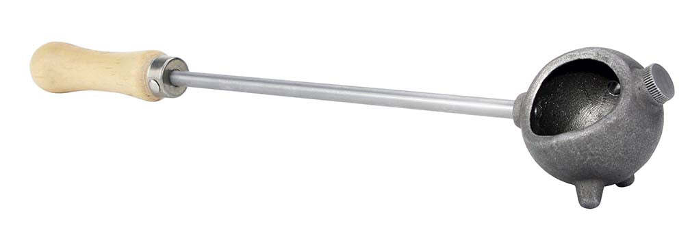

Very nice being able to cast your own slugs for an air rifle. I think you want pure lead for those, the same as muzzleloading rifles? I know a lead lighter that probably has more pure waste lead for sale (I can give you some to get you started). For smaller bullets, say under 250gn, I like the Lee bottom-pour melting pot, for heavier bullets and slugs I find a ladle gets the alloy into the big moulds faster. Lyman do a ladle with a pour spout to fit the sprue plates - it's an excellent tool. https://www.midwayusa.com/product/1010226746
Don't do your melt on a kitchen stove as lead dust will settle on all the surfaces around the area, get a gas camp stove and do it in the yard. For starting out or doing small test batches I just use the ladle and heat it with a gas torch.
