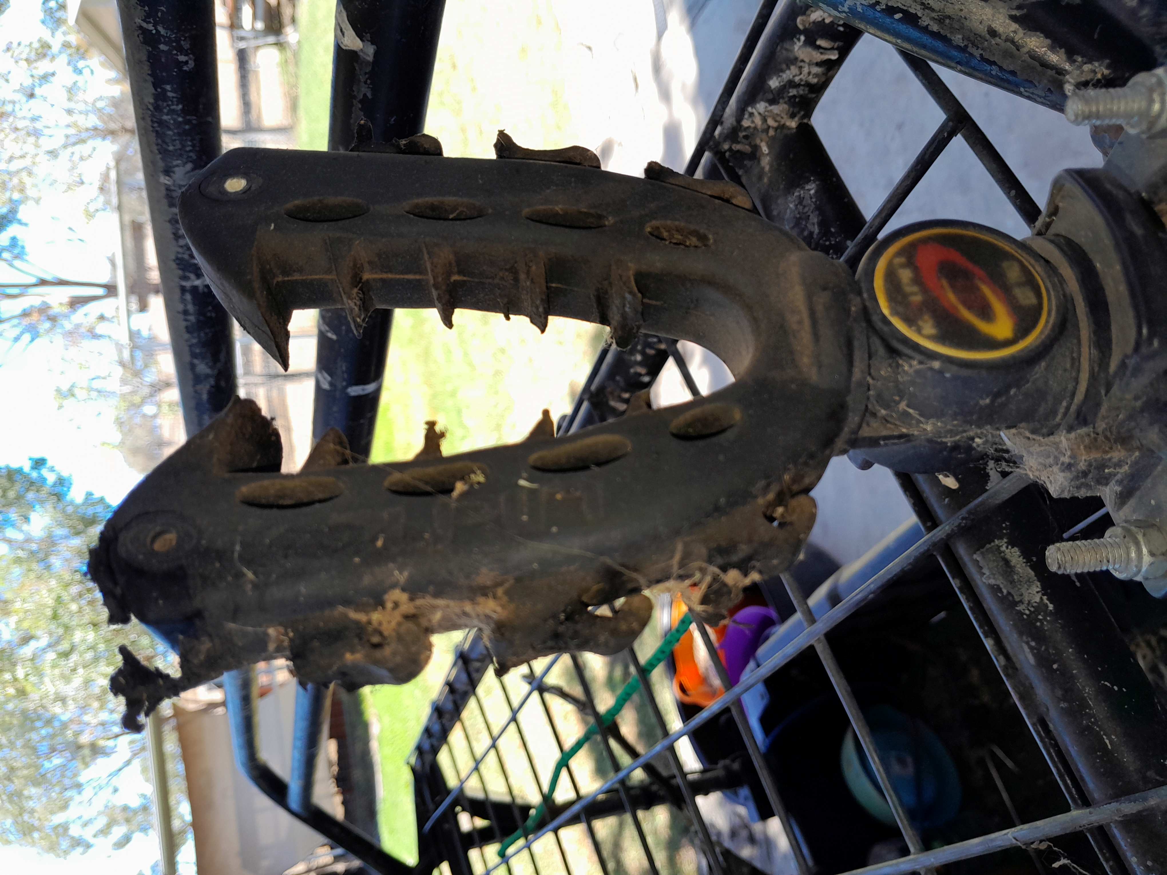

Any of you blokes with SxS buggies or quads might be using these rifle grips. The issue I have with them is that after maybe a year of being installed, and even kept in the shade, the rubber starts to go sticky and comes off on everything. Then it starts to separate from the poly base frame underneath.
I've replaced too many of these things of different brands, all Chinese made and haven't found a better alternative.
I'd already repaired the ones that were really bad, but here's a shot of one up top that I stick a big brushcutter in to knock over pine regrowth, which is starting to deteriorate.

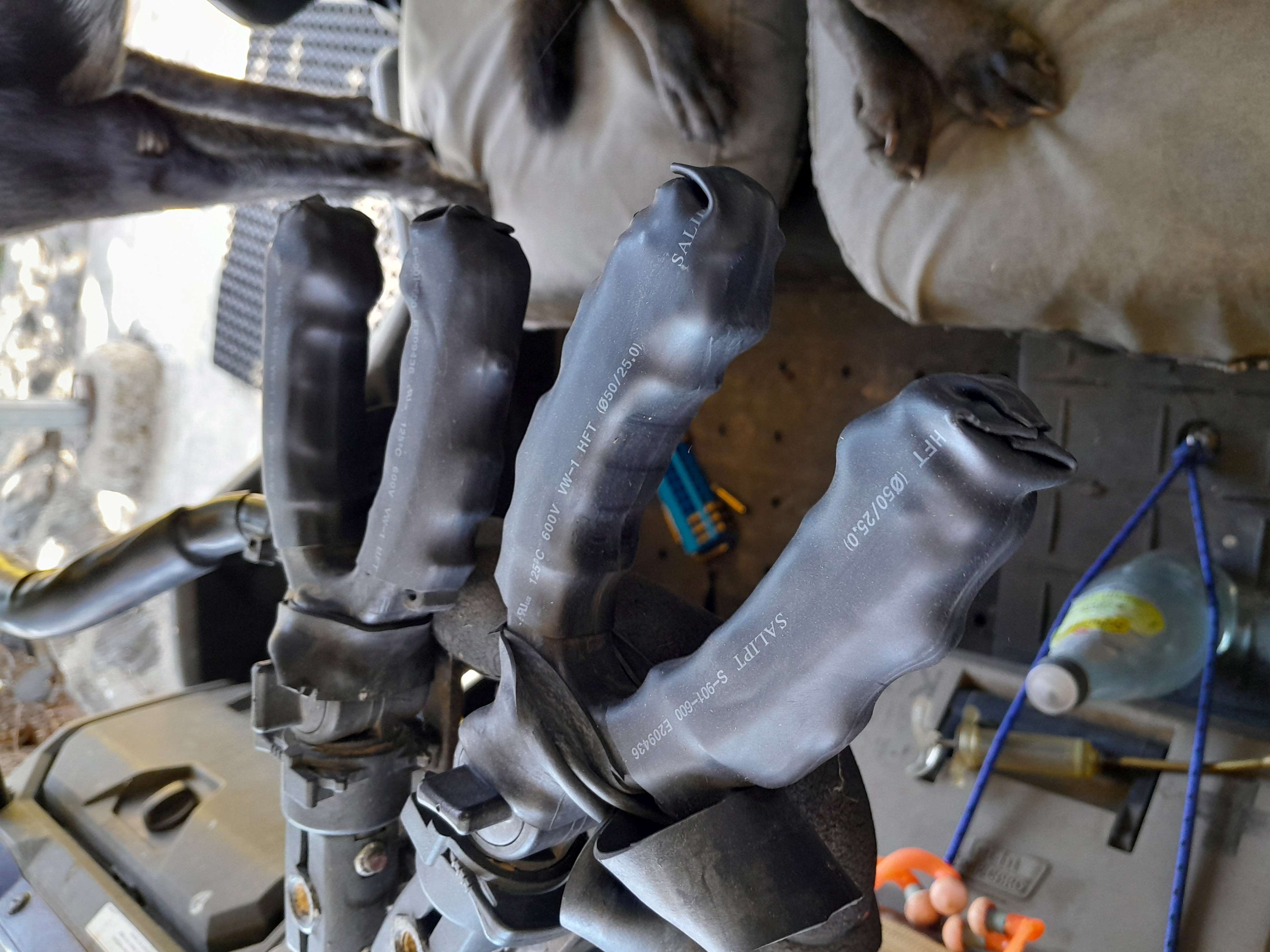

Before they completely sh*t themselves, you can grab some large heatshrink and cover them at the first sign of the rubber starting to go off. As said, it happens to me before a year is out but if you are pulling rifles in and out daily as is usual here, the moulded rubber in the ribs and grabs starts to tear pretty quickly.
If you cover the grips with this heatshrink, in my cases 50/25 will do all types, the shape it forms to around the grips over the high spots and valleys holds the heatshrink on permanently and it does not degrade.
50/25 means the heatshrink is initially 50mm i/d, and when heated with a hot-air gun shrinks to 25mm i/d.

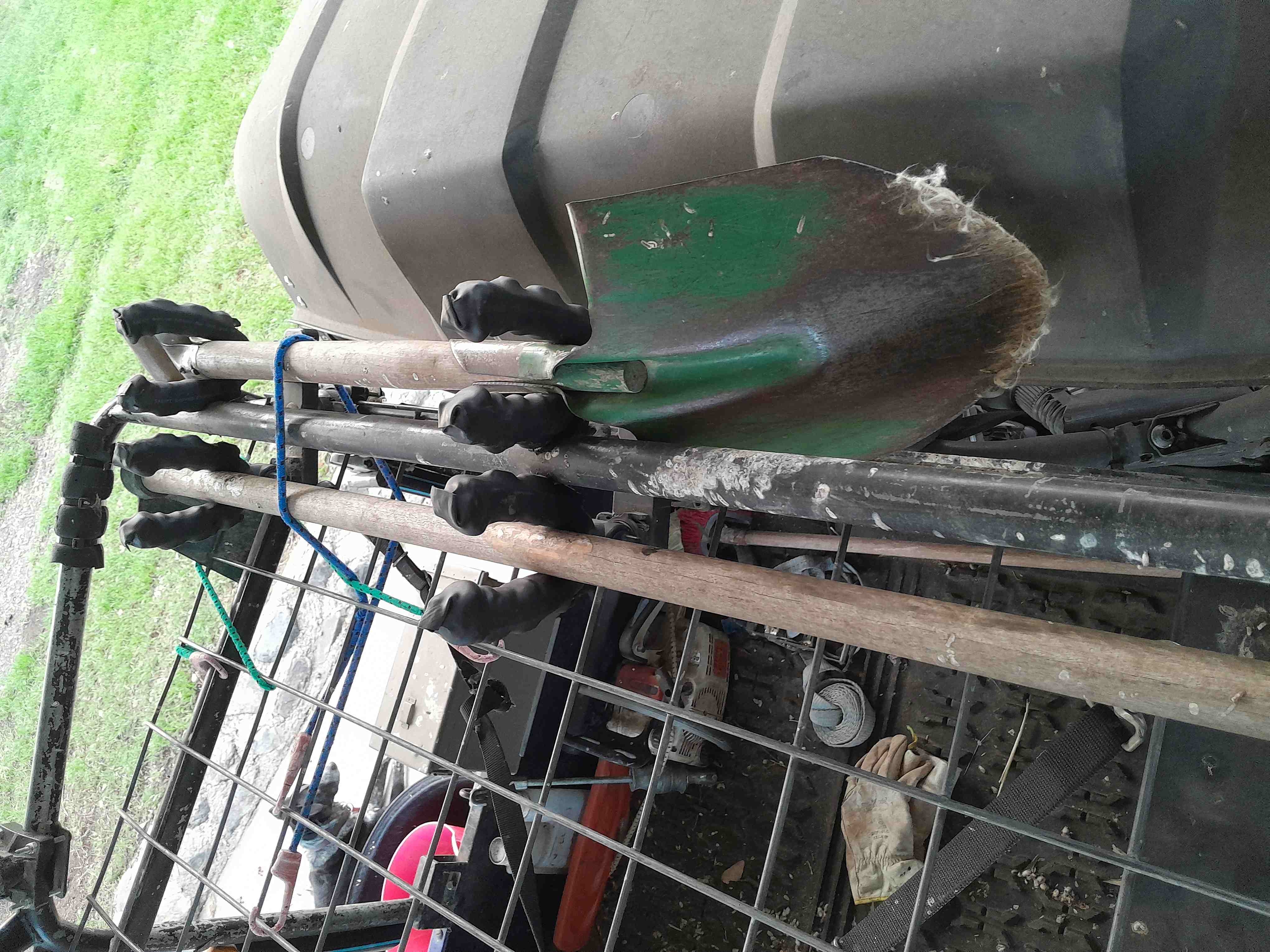

I use these rifle holders not just for rifles, a SxS running around has to have certain things on it always not just for hunting but many other jobs, and the grips really deteriorate fast when exposed to the sun. Up top here is a long hoe and a camp shovel. Actually these might now be extinct, Australian-made Cyclone tools.
Heatshrink is easy to get sent to your door off industrial supplies, I buy it by the metre from Ebay in many sizes. It's good to fix and protect things, not just to cover wire. Might give the handy ones of you that get out a bit, an idea.

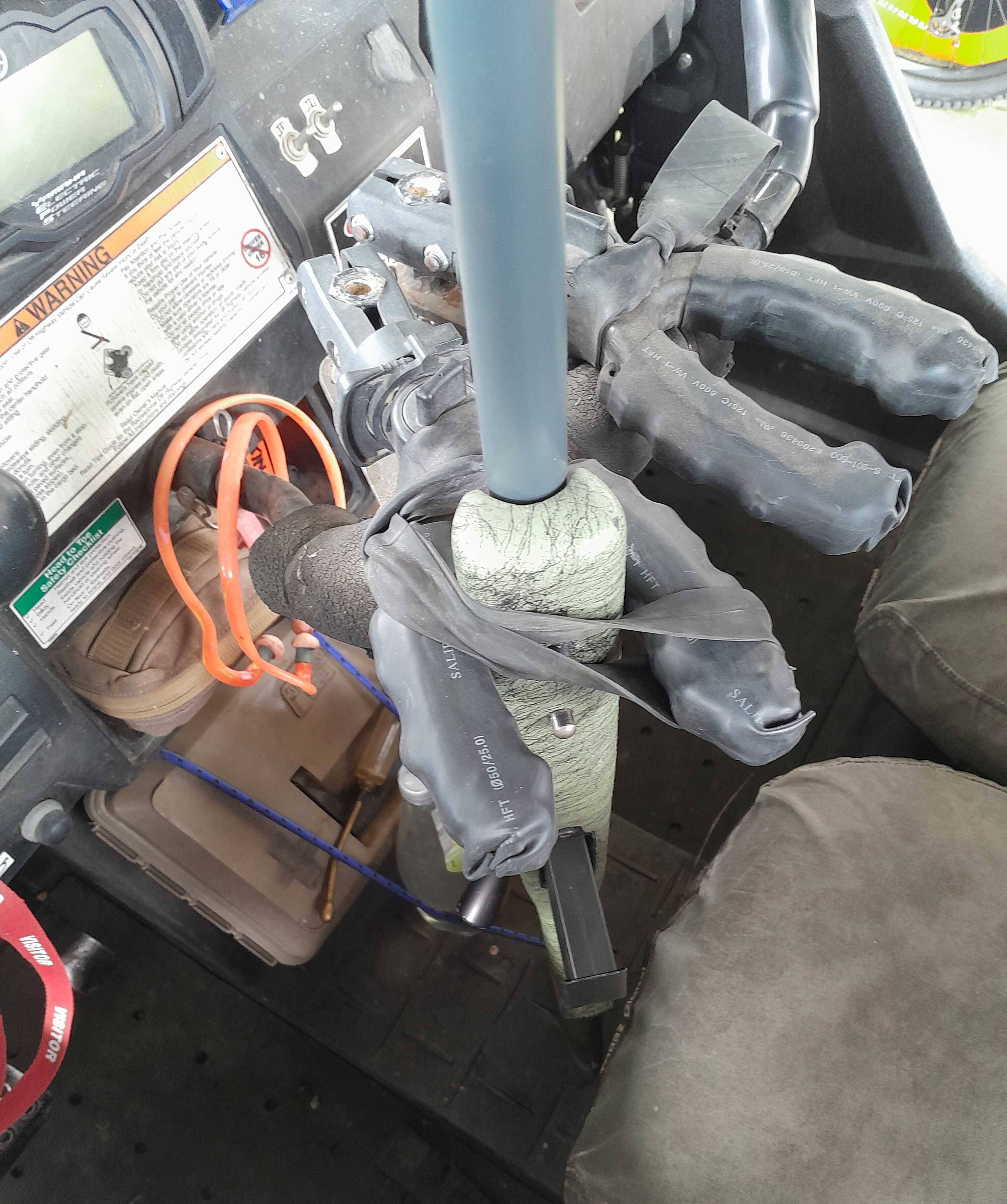

Another thing that sh*ts itself with these rifle rests/gun grabs is the pathetic skimpy rubber stretch band that is supposed to hold the guns in or stop them leaping out when you hit a bump.
These chinesium things look great for a few months, but then start to go off in a strange way and you come back and they are lying in bits on the floor of the buggy. Or snaps and your Swarovski lands upside down on the only big rock in the paddock.
A way around it is to cut big rubber bands from a large 4WD inner tube, like the kind you find in the 750/16 split rims in poverty-pack Landcruiser utes.
Cut then about 25mm wide with good scissors and loop them the way I have them in the above pics I posted, or feel free to do it some other way.
If you drop in to a good friendly tyre place, they will give you whatever is in the bin. But remember, smaller diameter tubes will be too short.
Farms always have a selection of tubes, because a lot of times tyres get cuts too big to plug, and quad bike tyres don't take internal Rema radial patches very well.
And avoid the crap Chinese-made tubes, because in the light they will just self-destruct as all Chinese stuff is designed to do.

Post by Wapiti » 21 Mar 2026, 9:35 am
This is the example of using inner-tube offcuts to stop the rifles falling out, or jumping out.
Sure I have my rifles upright because they come out quick and store without taking up any room like this, I like this SxS because it is a 3-seater and doesn't have the ridiculous useless centre-consoles that nothing fits in.
Same would apply having them horizontal.

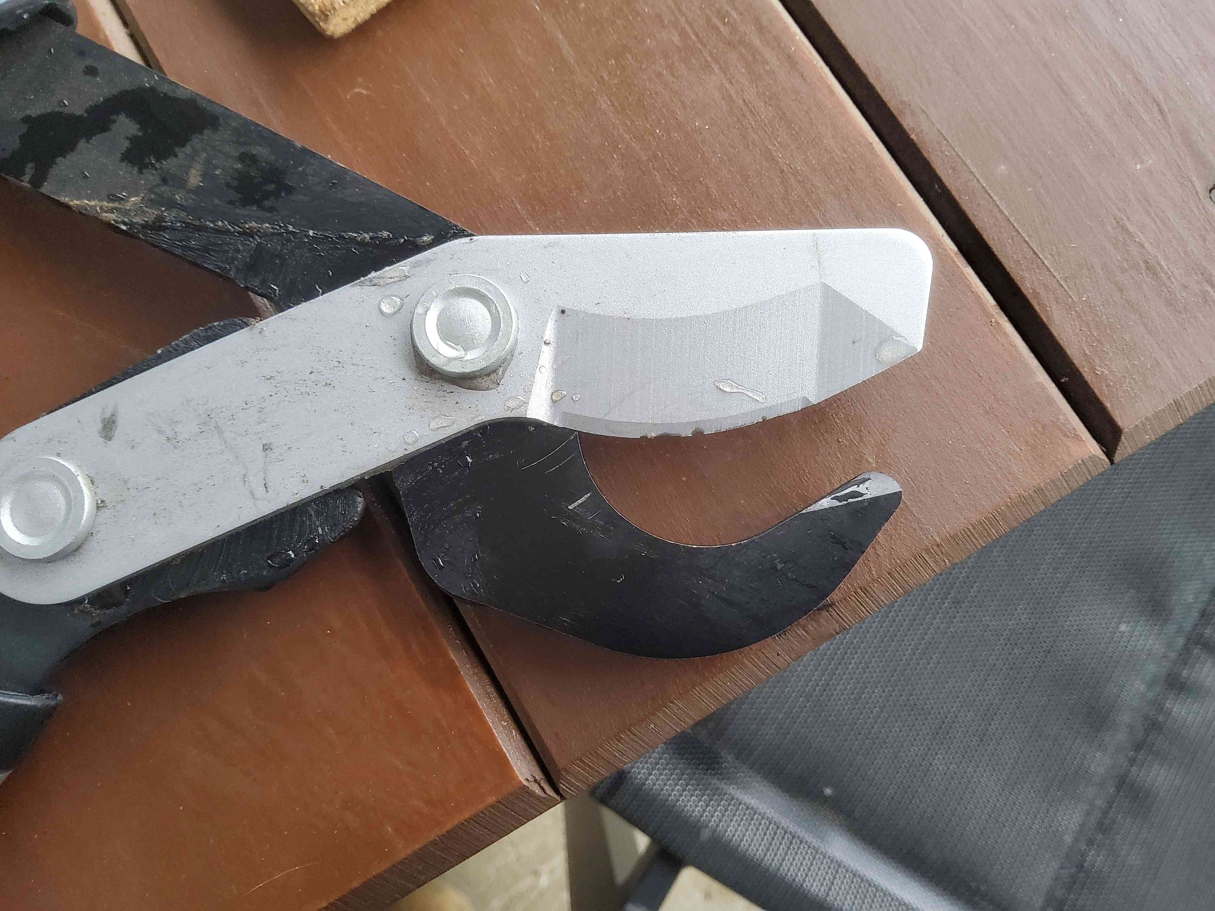

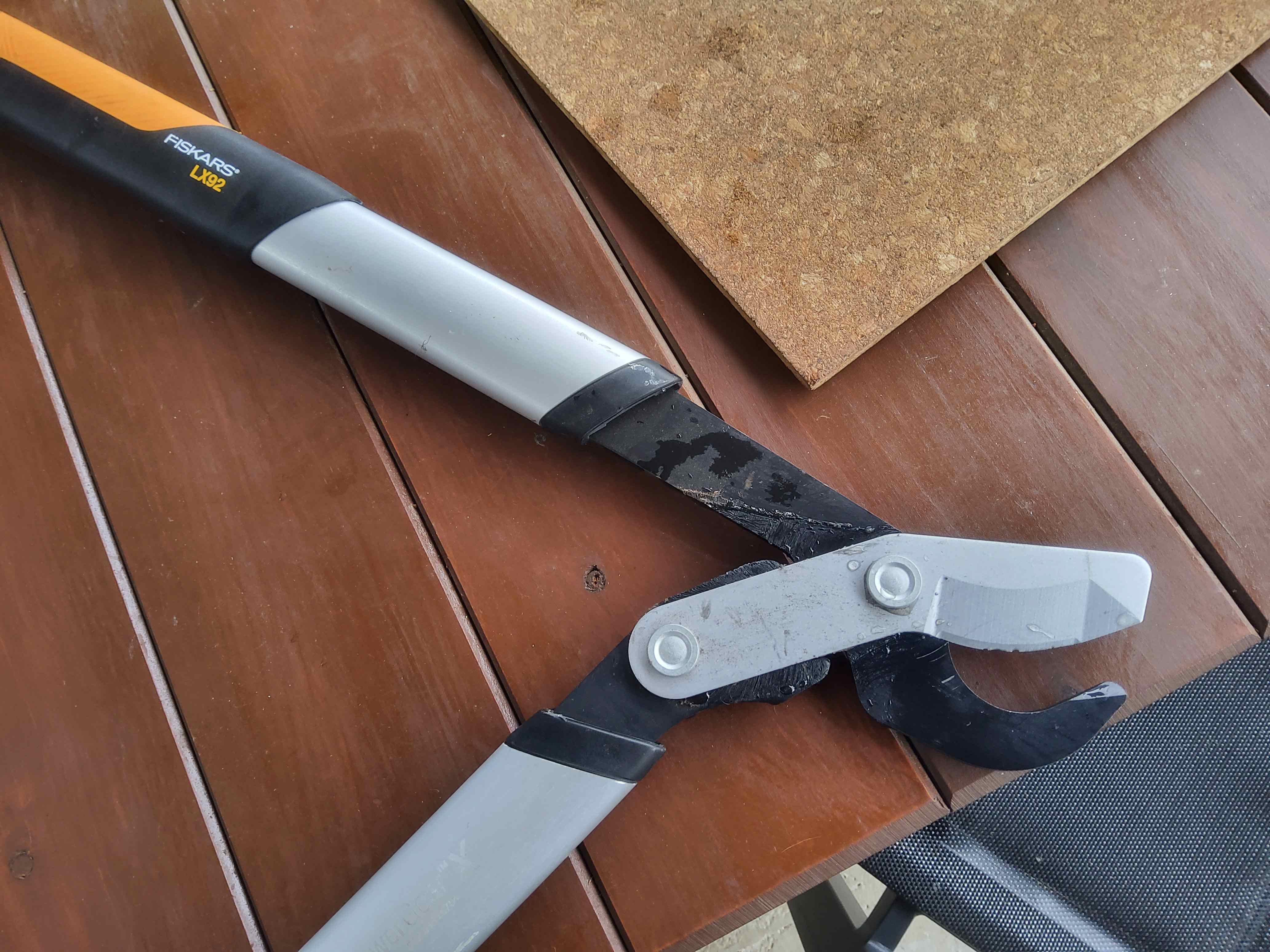

On the Chinese issue, we finished the day with another tool failure.
The wife and I went for a spin to get a deer for a batch of jerky and Biltong, and we had the deer hanging off the buggy rack. We do all the dressing and major cuts there and take the sections back to bone out properly at the house.
When I went to clean off the brand new Fiskars cutters that I use to cut off the feet below the calf muscle - have to give them a wash and oil afterwards or they'll rust - I noticed these chips off the cutting edge.
The old cutters that have lasted me doing this for 30 years were a few pairs of the old ones made in Finland, and FFS now they are made in China and NEVER chipped or deformed no matter how thick the bones were I ever cut. They just wore out from being sharpened.
The Chinese POS they now make, failed cutting two thin, freshly killed fallow deer's tibias. F*cking hopeless.
I had recommended Fiscars for this job to others because once upon a time they were made properly, do not be disappointed by buying sh*t that costs $75+ and is made by incompetents in China and sold by thieves here at European-quality prices.

For tool steel to chip like the pic supplied by Wapiti,,,, I'd go so far as to say caused by yet another short cut.
Hardened,,,,, but skipped the tempering process.
