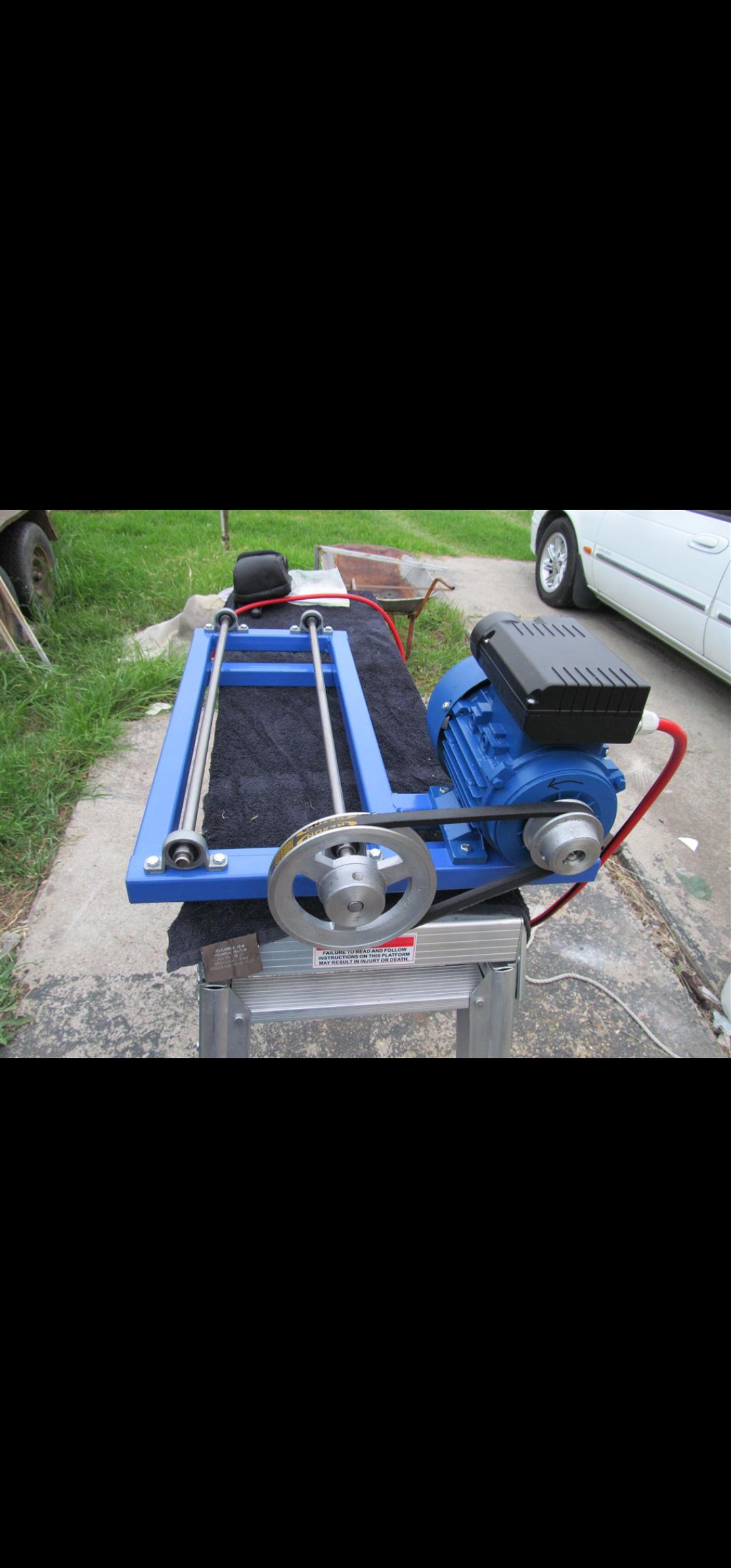

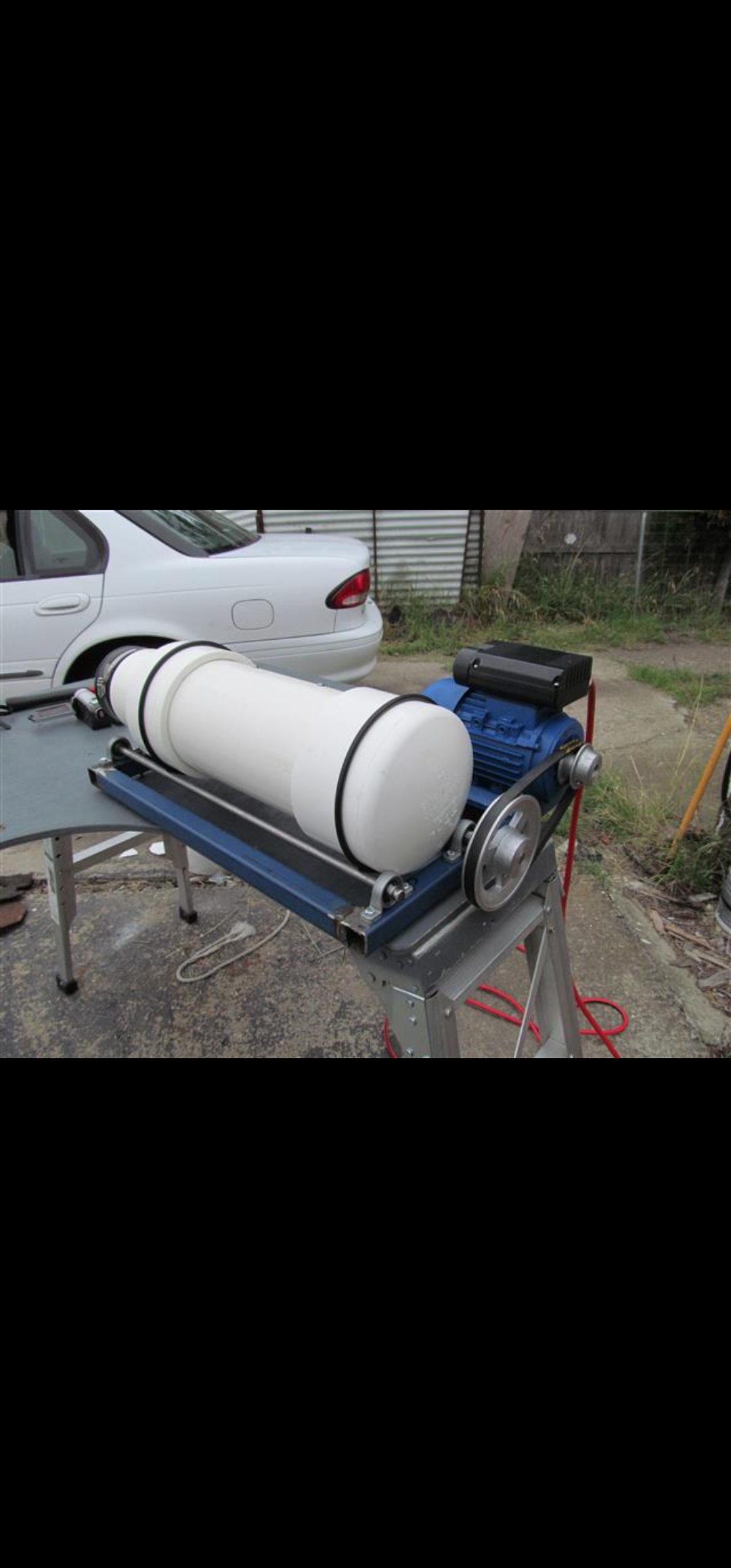

Ok well after not being able to find a pin tumbler that comes in on my standards I thought i would make one so here it is .
And after paint

nice it does look like you have more rapped up in material then it would cost to buy one but if the stuff is laying around you are good

Maybe not, Wrenchman, if you dabble in making stuff, sometimes you have most of the stuff that can be repurposed and some spare time.
Too many people spend it on the couch bending the elbow that is giving them diabetes and staring at the TV allowing Alzheimer's to develop, I'd rather be exercising the brain and the hands in the shed ...
On most of the big names brass tumblers... quite frankly they work but have a few faults. One being crap.
Mate that's a super professional job, right down to the pillow-block bearings and shafts, pulleys etc.
Working out the speed via the pulley diameter/motor speed, did that work out how you wanted it?
And the drum itself, is the cap a screw-on with seal, I assume it is?
Is it pressure poly, and I'm really interested in where you went to get the plastic-work too.

You must have not read the last paragraph in my post I couldn't get one that came up to my standards I believe things should last a lifetime and I couldn't get one big enough I can put around five or six hundred 7mm Remington Magnum cases in this tumbler God only knows how many nine 9mm ones will fit

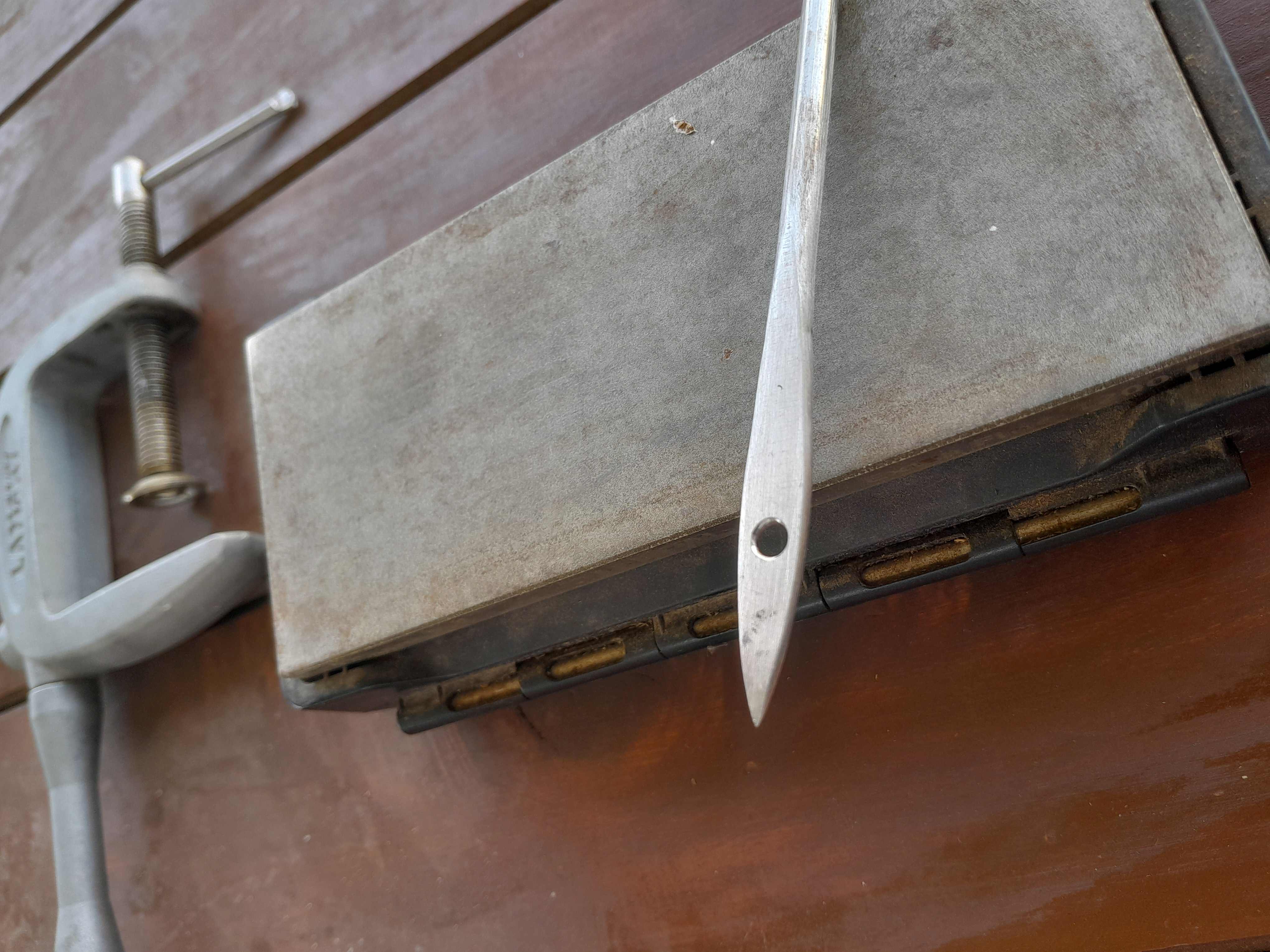

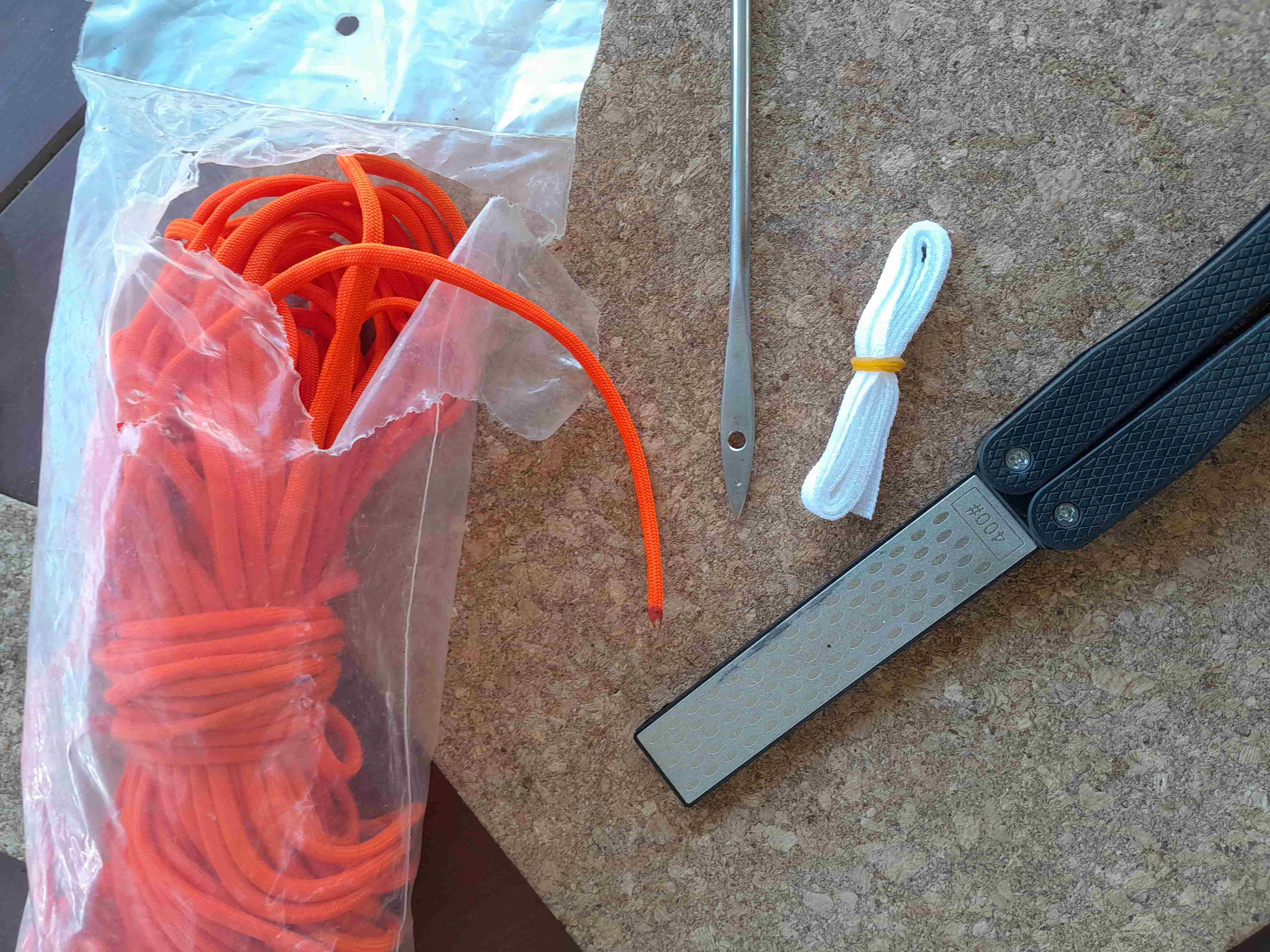

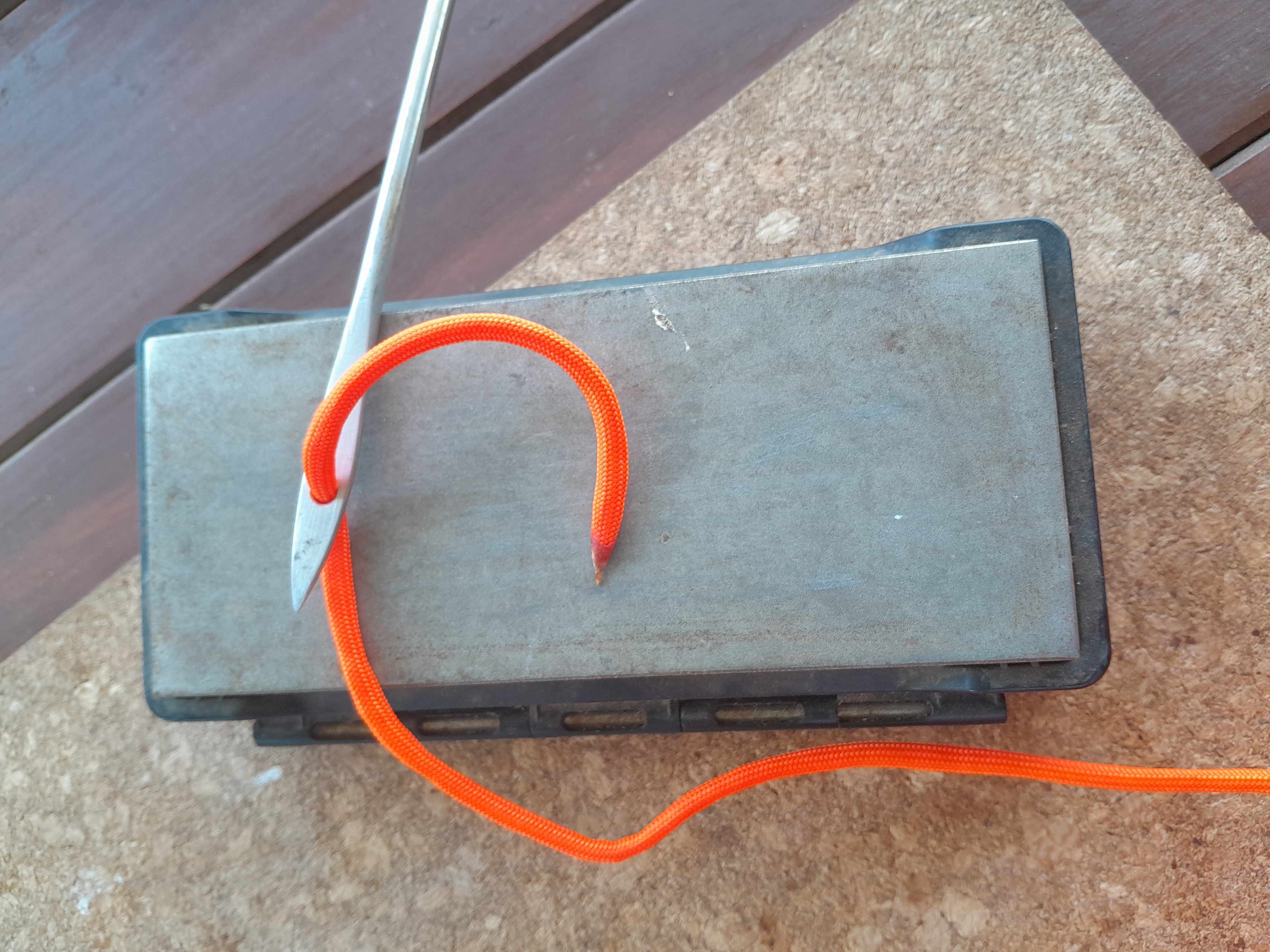

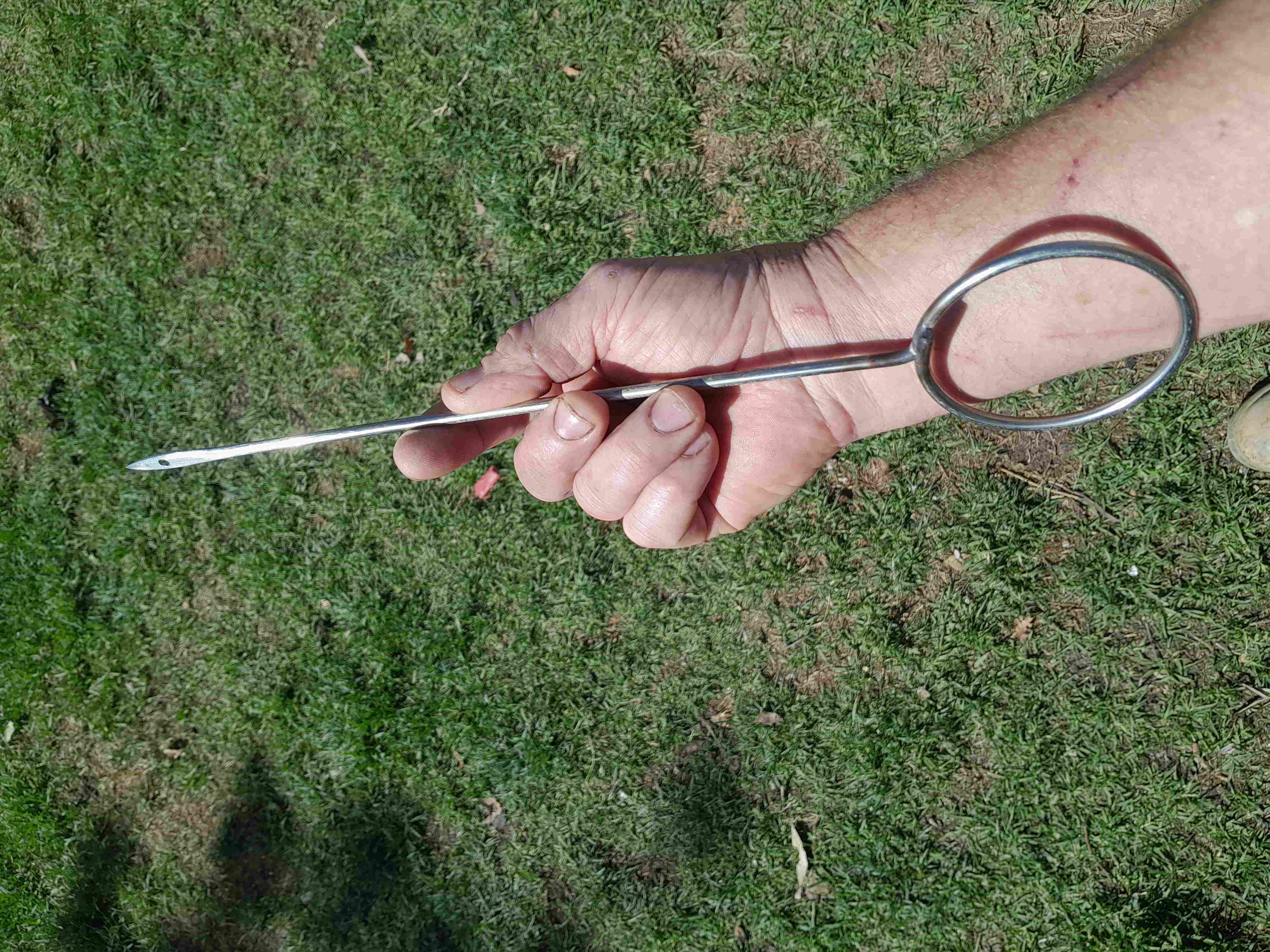

This morning I had to knock this thing up in a hurry.
It's cut from a length of 5mm 316 SS rod, heated up and flattened then ground and sharpened to what looks like a giant's sewing needle.
Just something else that yesterday, I never knew I'd need today and I'm just glad I had the gear to make, real fast.
It had to be sharpened really sharp. Think, like a dagger at the tip but definitely not sharp - smooth in fact, from the hole and down towards the handle.
It takes either nylon tape, or paracord.
In this case, orange paracord so that, from a distance, we can see that it is still there, working. Think giant stiching thread.

I wouldn't normally ever take pics of this stuff, it's normal stuff that surprises you on the land but in this case because I had to make this tool and because Deye started this thread and so far no more pics of homemade necessities I thought I'd show youse guys.

The tool is inserted on both then right and left bottom of her vulva, pushed upwards the full length, to come out between the top of her vagina between it and her anus, swaps to the other side the same and out the bottom.
Then you tighten the paracord (or tape but that's what a vet uses and is cheap sh*t) and knot it securely. But not too tightly.
So now, she can still freely urinate, but never have a calf and if she did, she'd probably push out all the way to the cervix and although some sick farmers will do it and kill the cow to get a calf, we won't.
So this what this home-made tool is for. And it needs to be SHARP, man.
