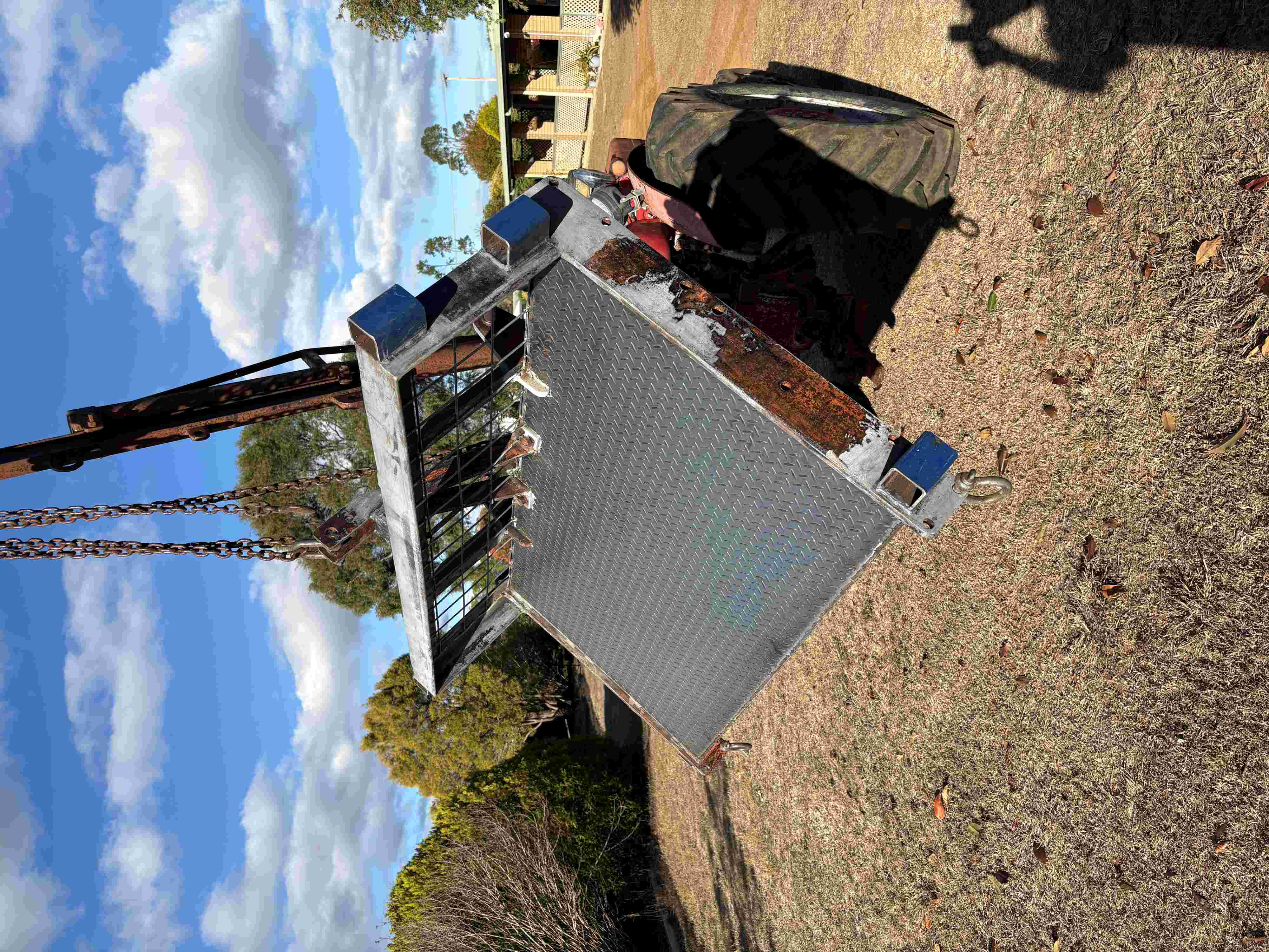

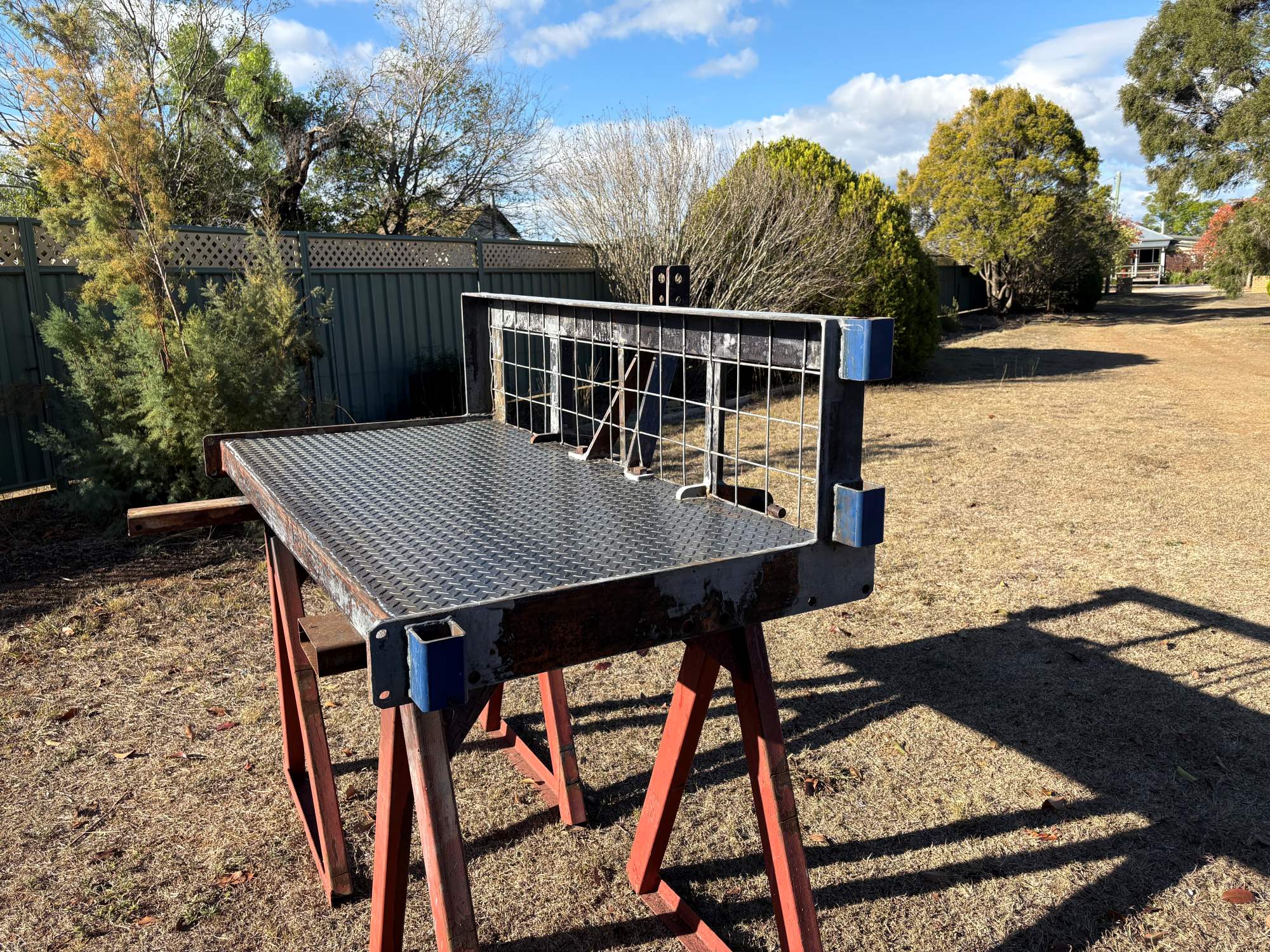

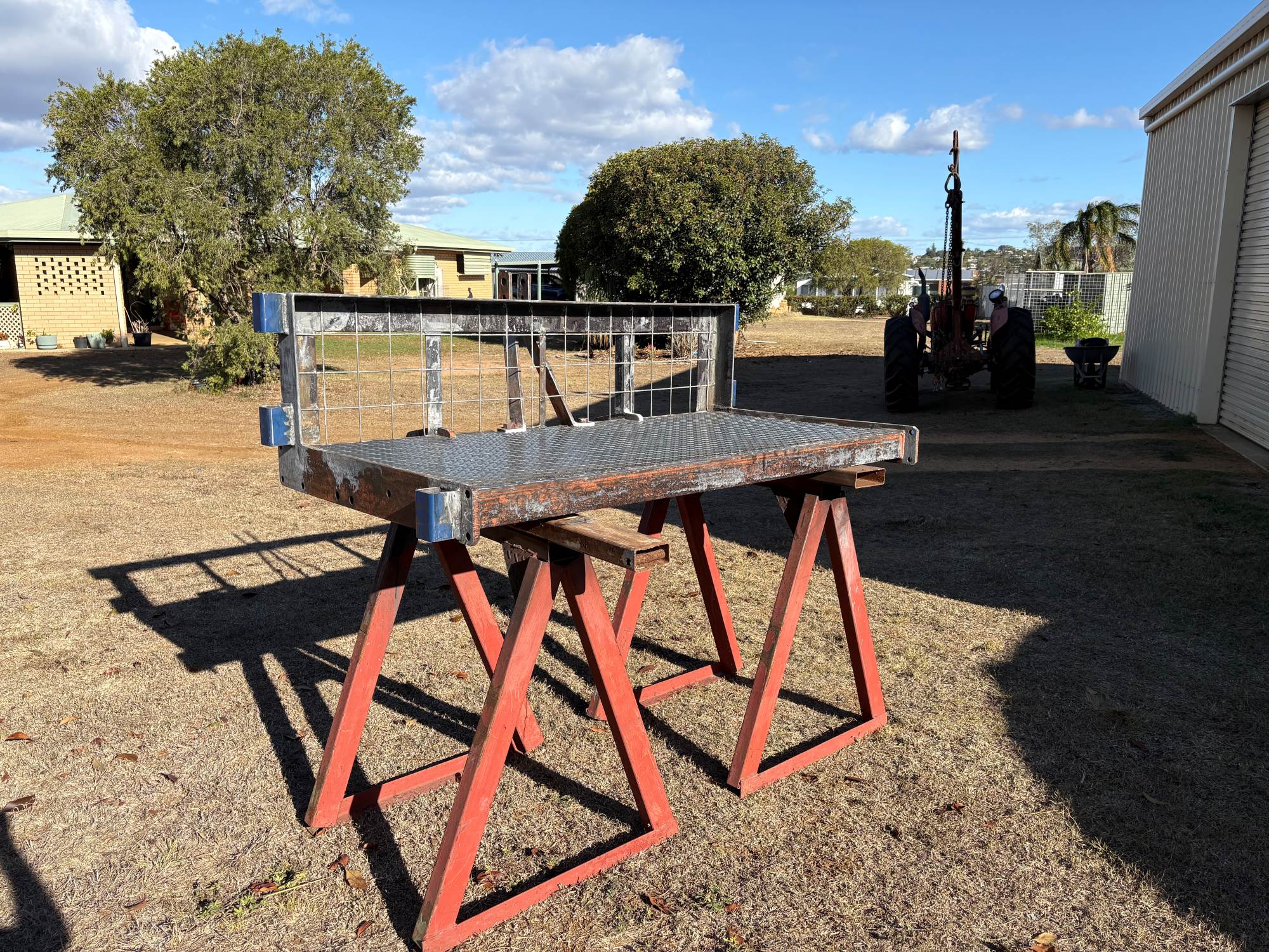

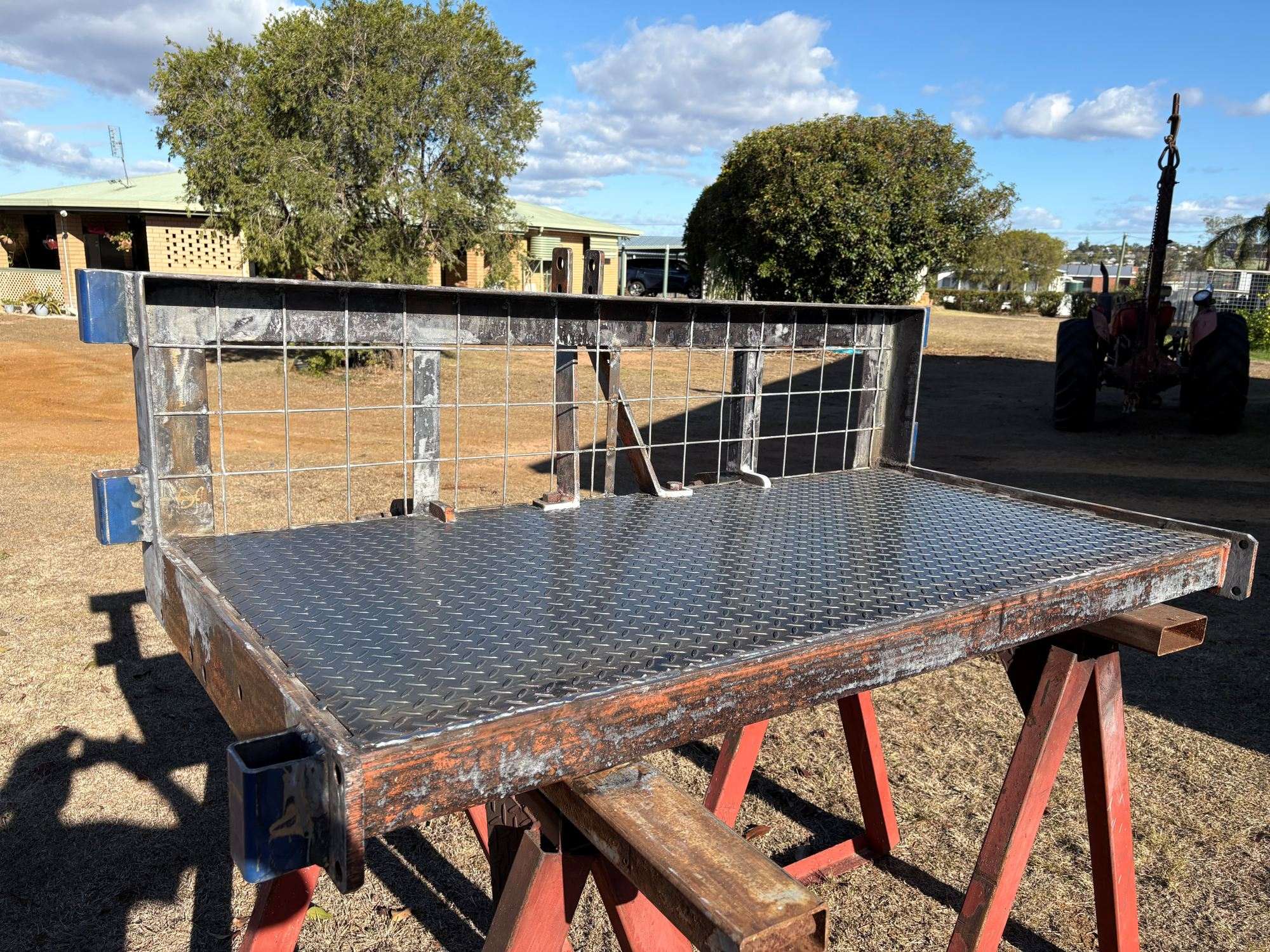

Here's a few pics of a work that's been in progress for a few days.
Ready now for a final wire brush, and wipe down with Prepsol and thinners, before 3 coats of primer.
Then a further 3 coats of Caterpillar Yellow.
I've gotta make a few things to retrieve some dollars after having unexpected and previously unknown accounts land on me.
Will post further pics when it's completed.
