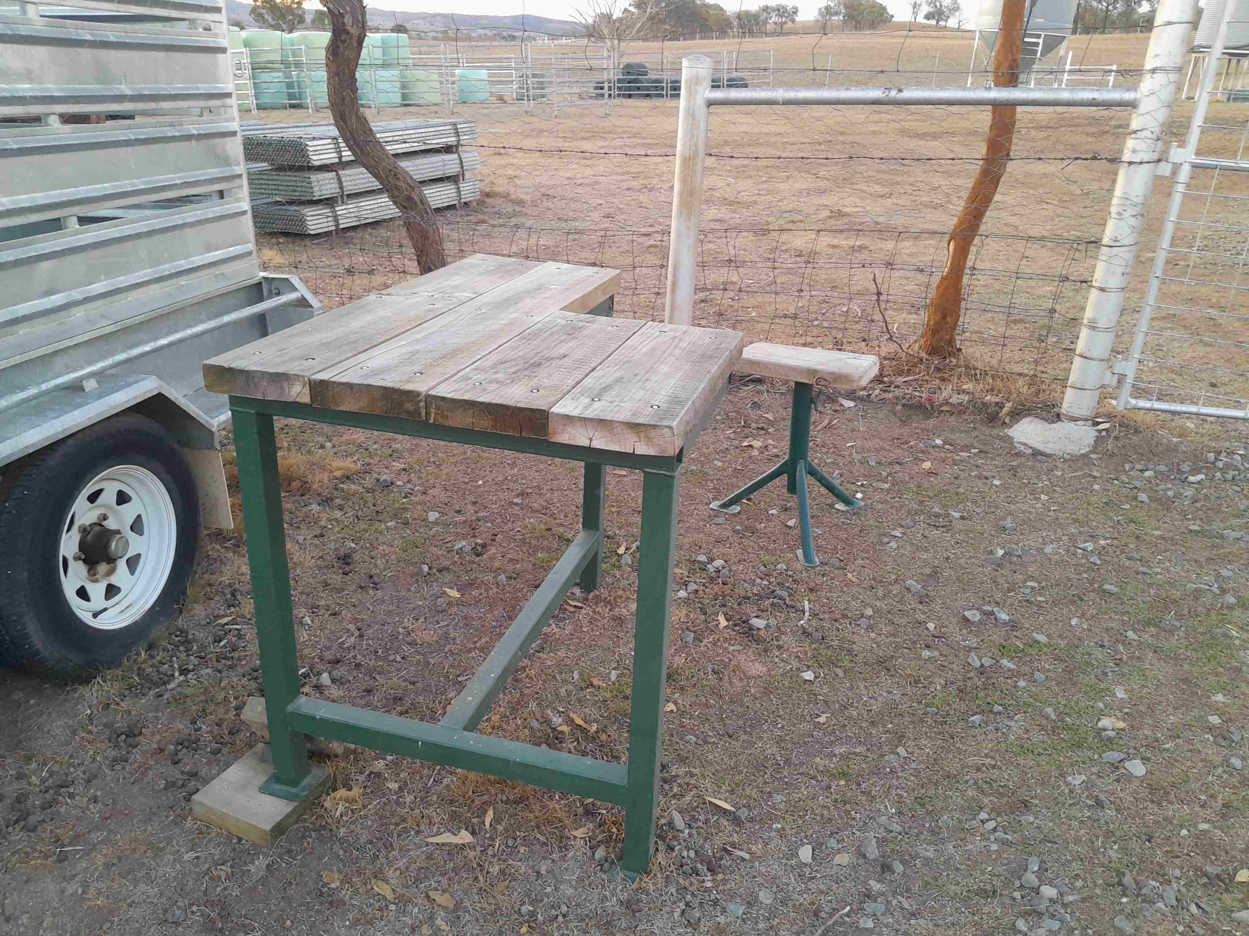

Here's a crappy, right-hand shooter benchrest and stand in the farmhouse yard.
It's made from a 50mm box section frame that came under a big pack of cattleyard panels. Just sleepers screwed to the top.
The seat slides up and down and can be set at any height for different size people.
If the rain that's supposed to arrive tomorrow or Thursday comes I will set it up with an adjustable front rest that's part of the bench.
Otherwise, BYO benchrest to sit on the top.

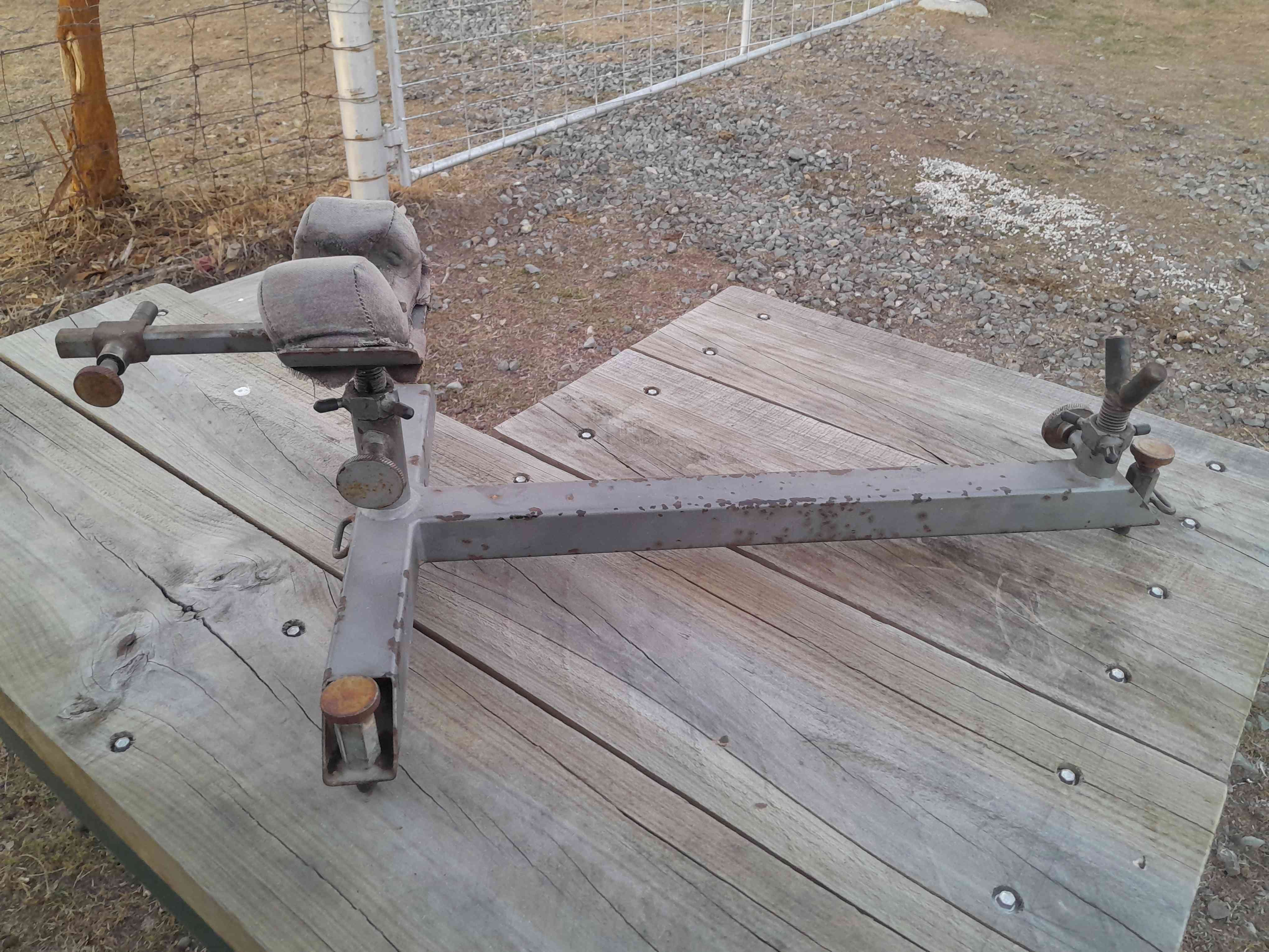

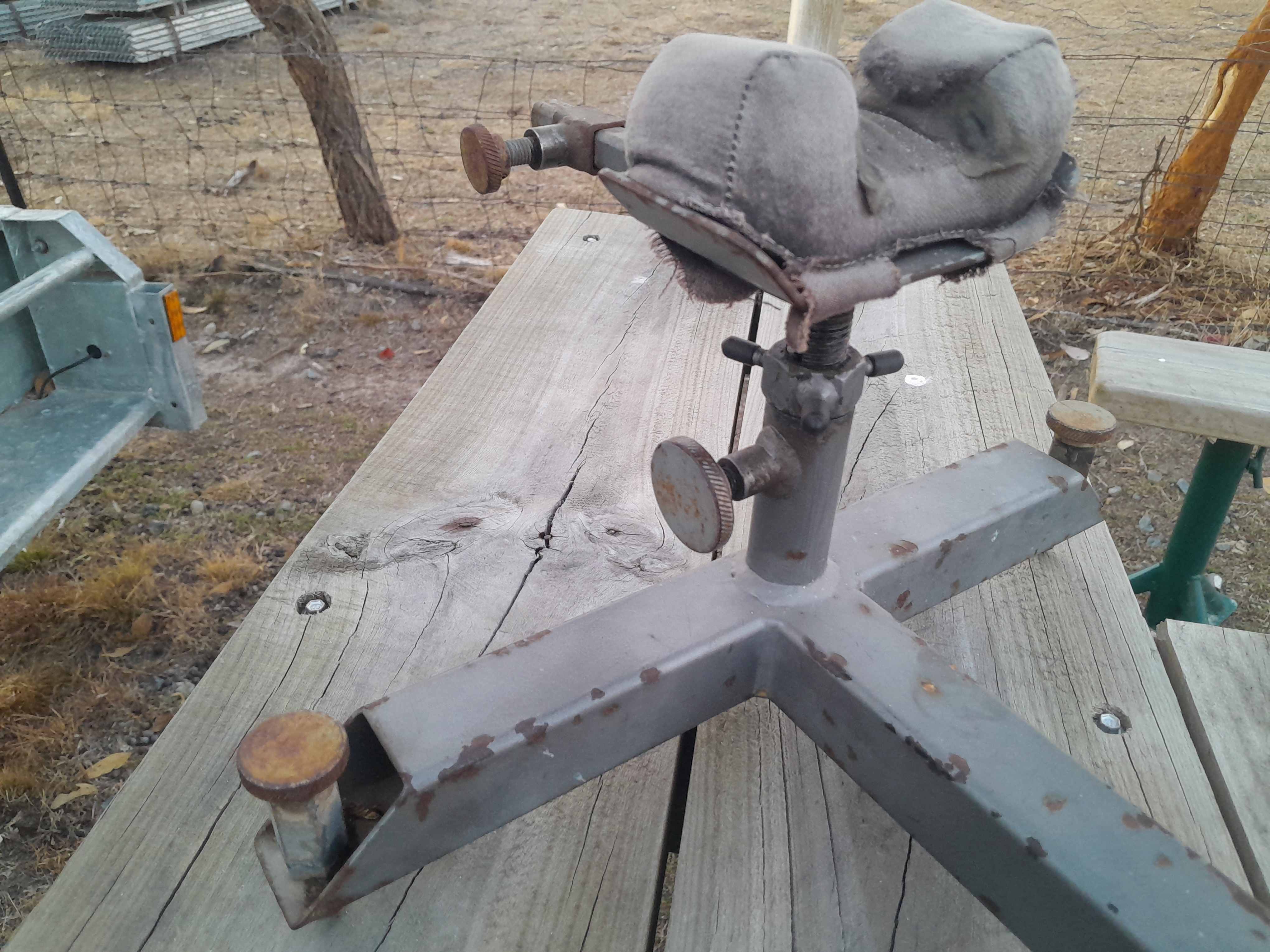

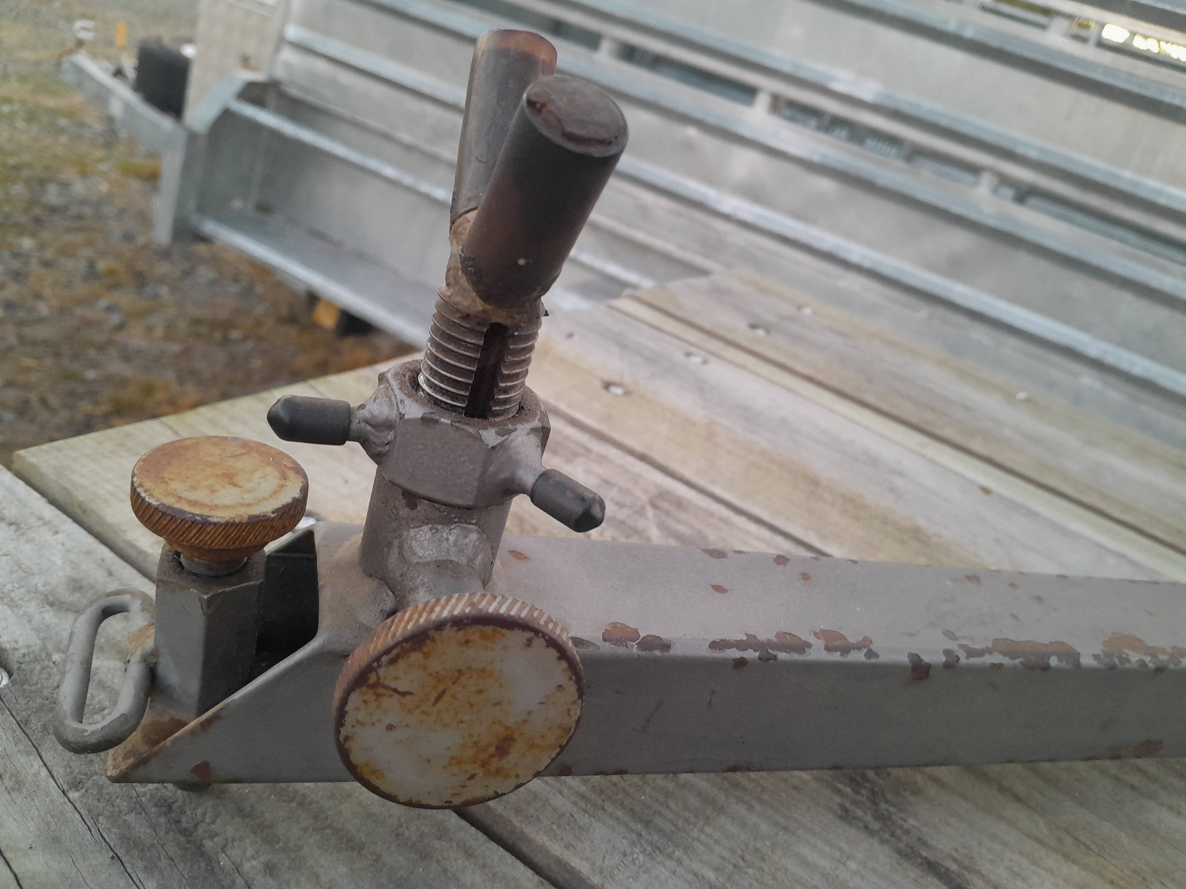

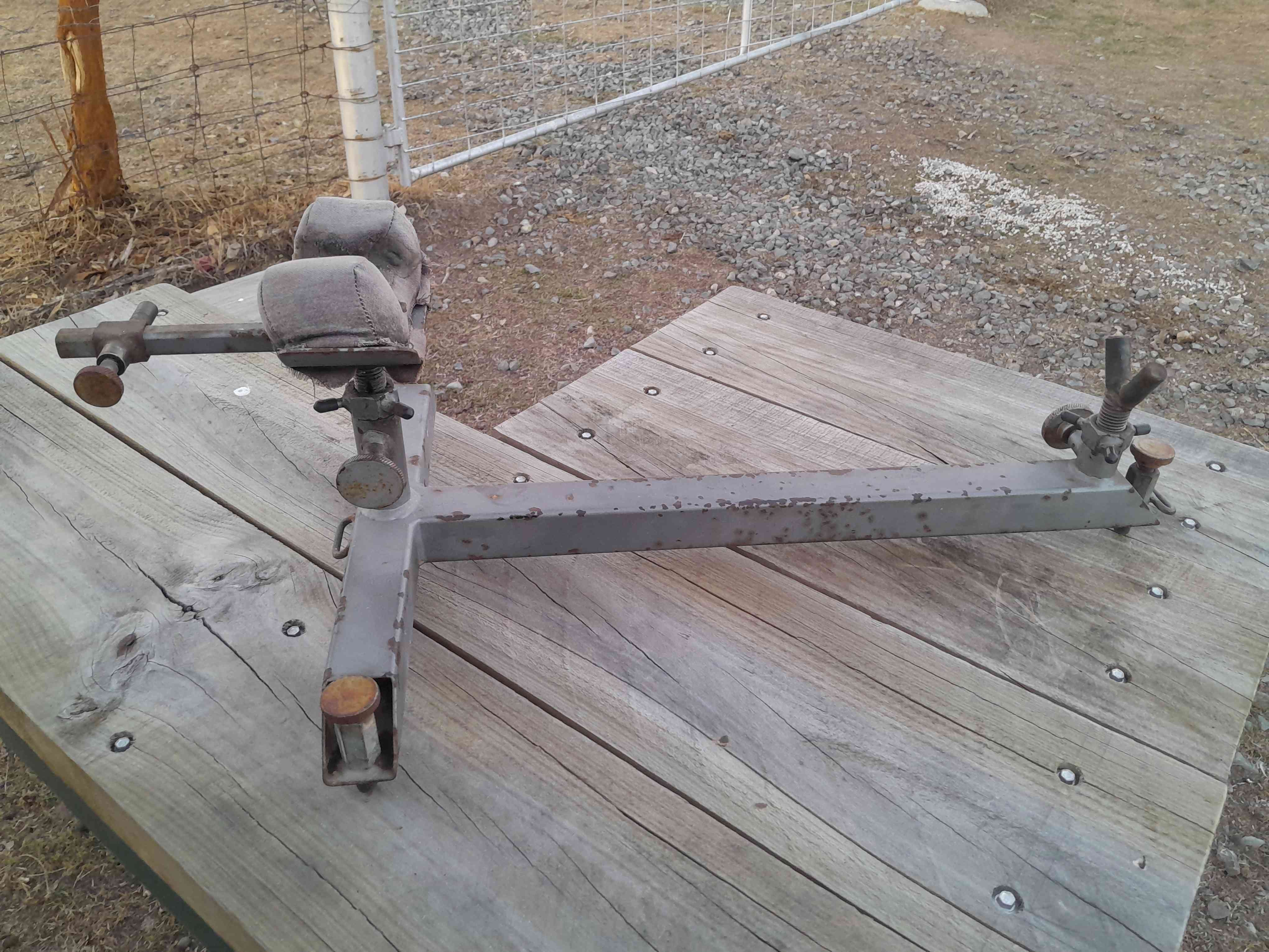

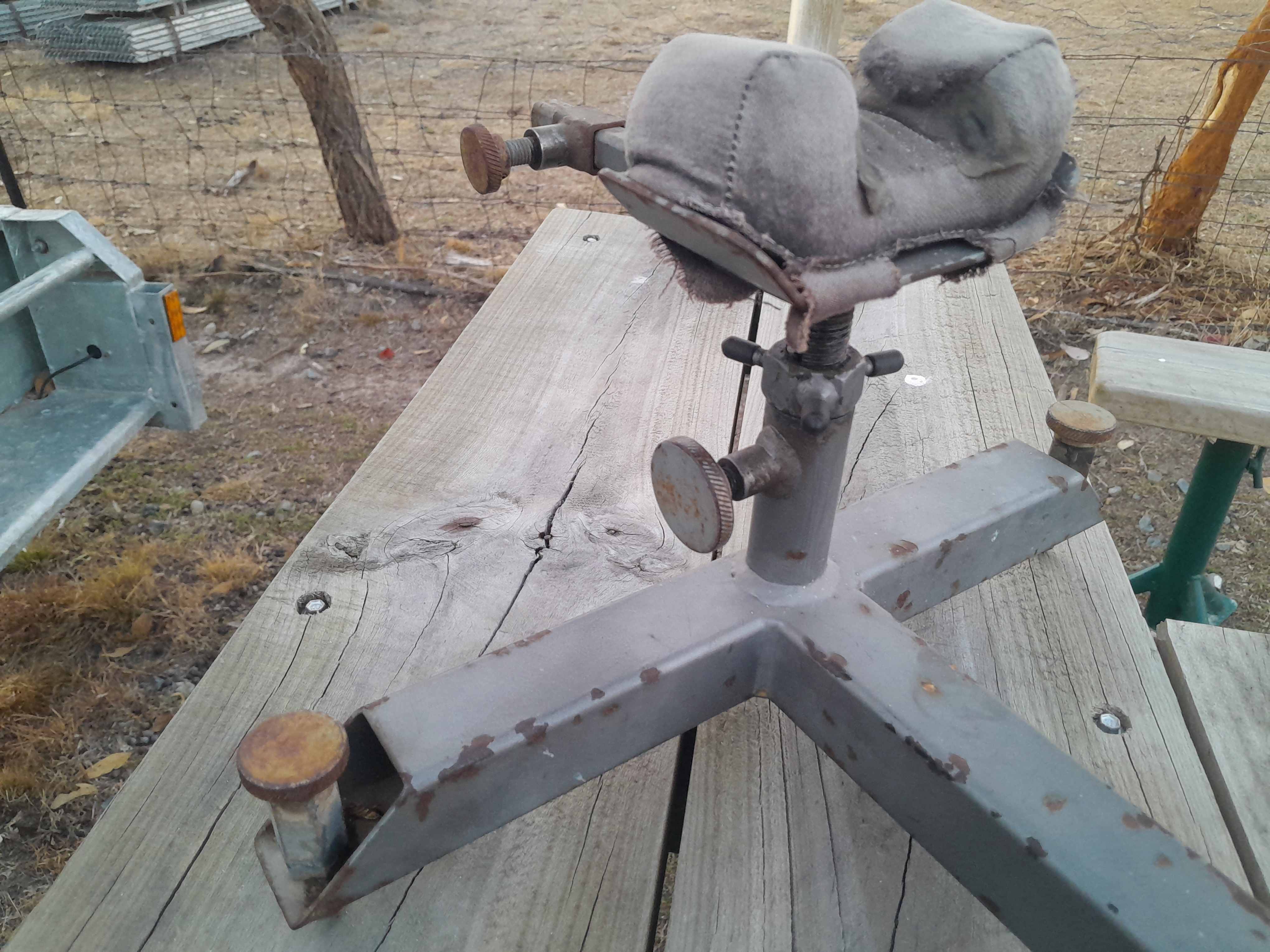

Here's my homemade shooting rest, for load testing.
I made 4 of these things for mates as well, and this was over 20 years ago now.
WAY before those awful "lead sleds" with the soft compressible rear rest came on the market. Gosh I hate those terrible things.
It's basically a tripod, with adjustment bolts at each corner, and being a tripod means it will never wobble.
The threaded adjustments (one at each end) have lock bolts with turned-up handwheels that run in vertical slots in the 20mm threaded stainless rod, so the front and rear bags don't spin as you adjust it up and down. And they allow you to lock the adjusters to eliminate any wobble.
It also has a front stop, which isn't in use anyway because it's a dumb idea. The rubber stopper on it fell off years ago. I only added it on all of them because of pressure from mates.
You just attach standard front rest bags, whichever one you prefer.

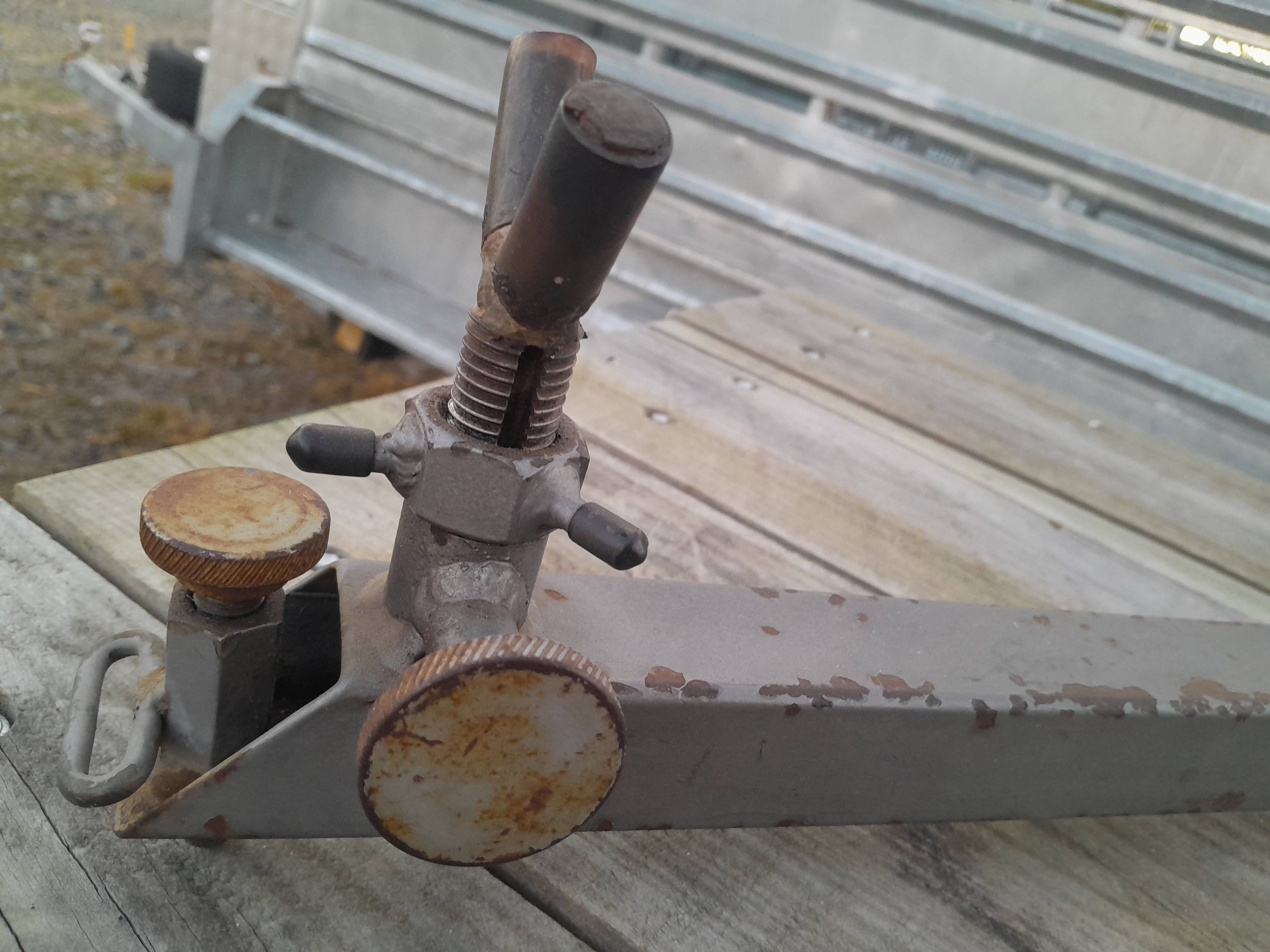

The rear end. Adjustable the same. Instead of soft rubber like the Lead Sleds on the toe of the stock which causes crosshairs to move everywhere with inconsistent pressure, the fork that the buttstock sits in is covered by clear vinyl tubing so it doesn't move with cheek pressure. It's never scratched even the finest walnut stocks on my prized guns yet.
The long chain link is there to attach a sling, one on the front too, so when I attended a rifle range I could sling it over my shoulder and keep both hands for other stuff. The sling has long since turned to dust and perished.

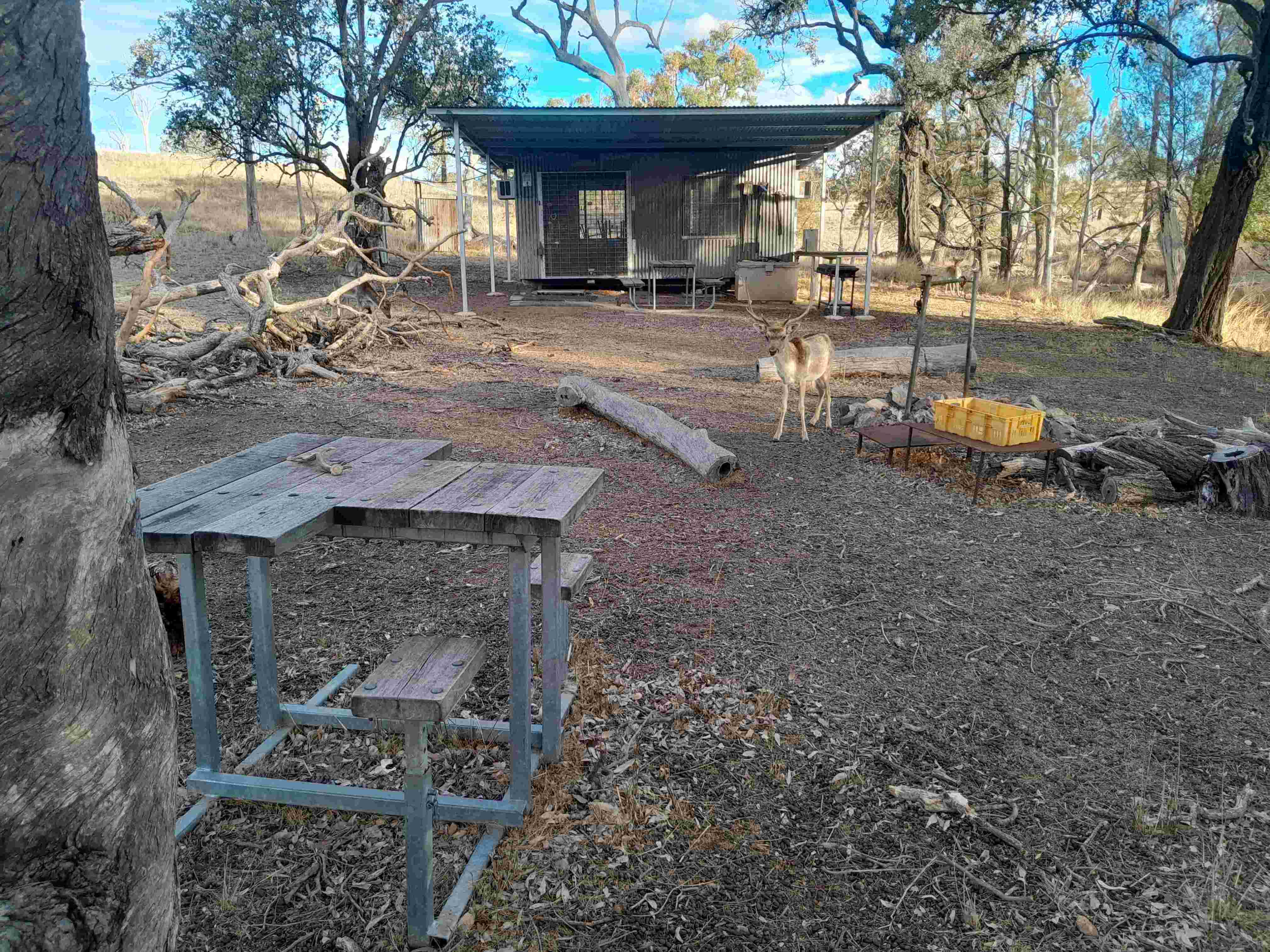

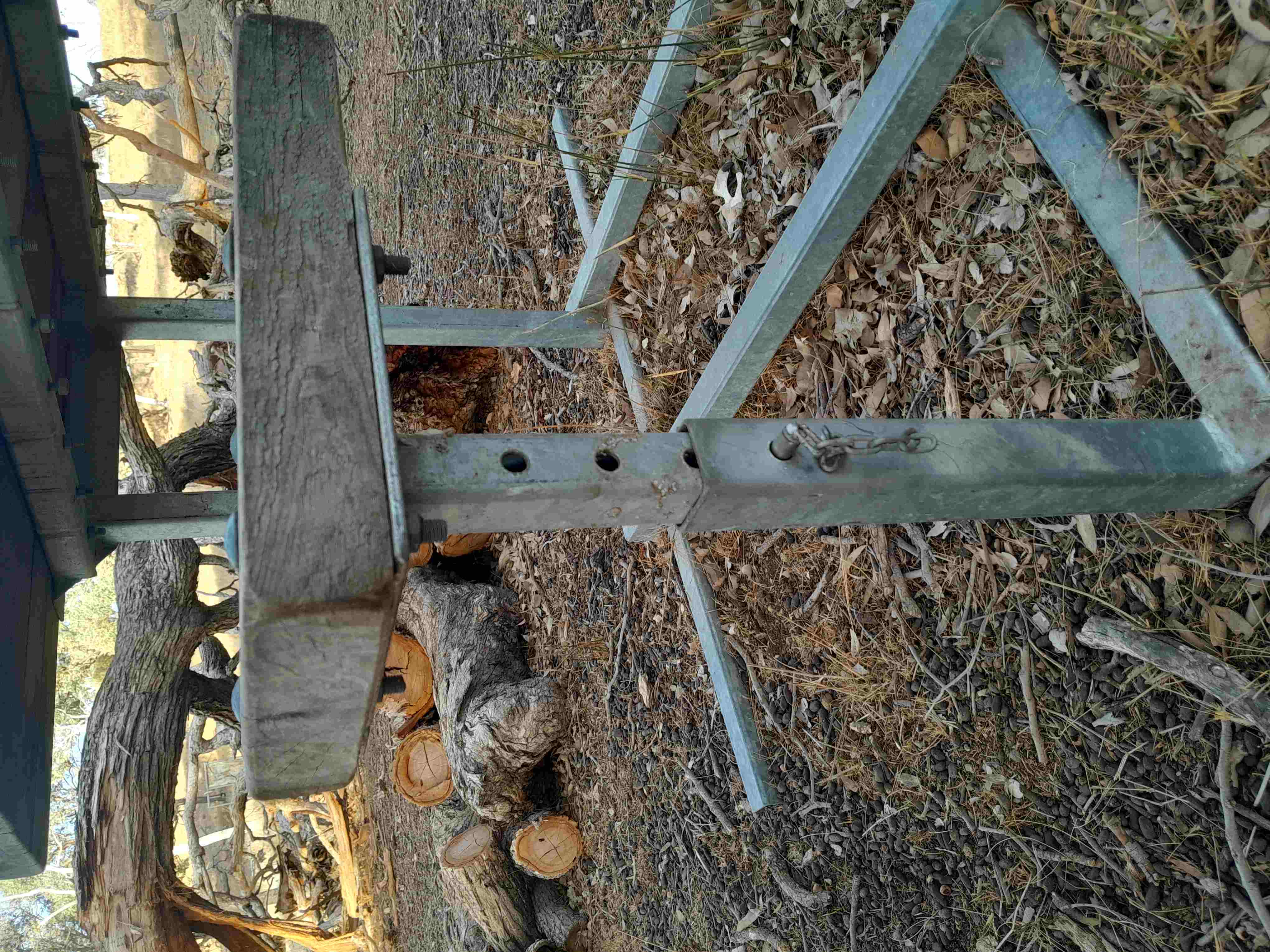

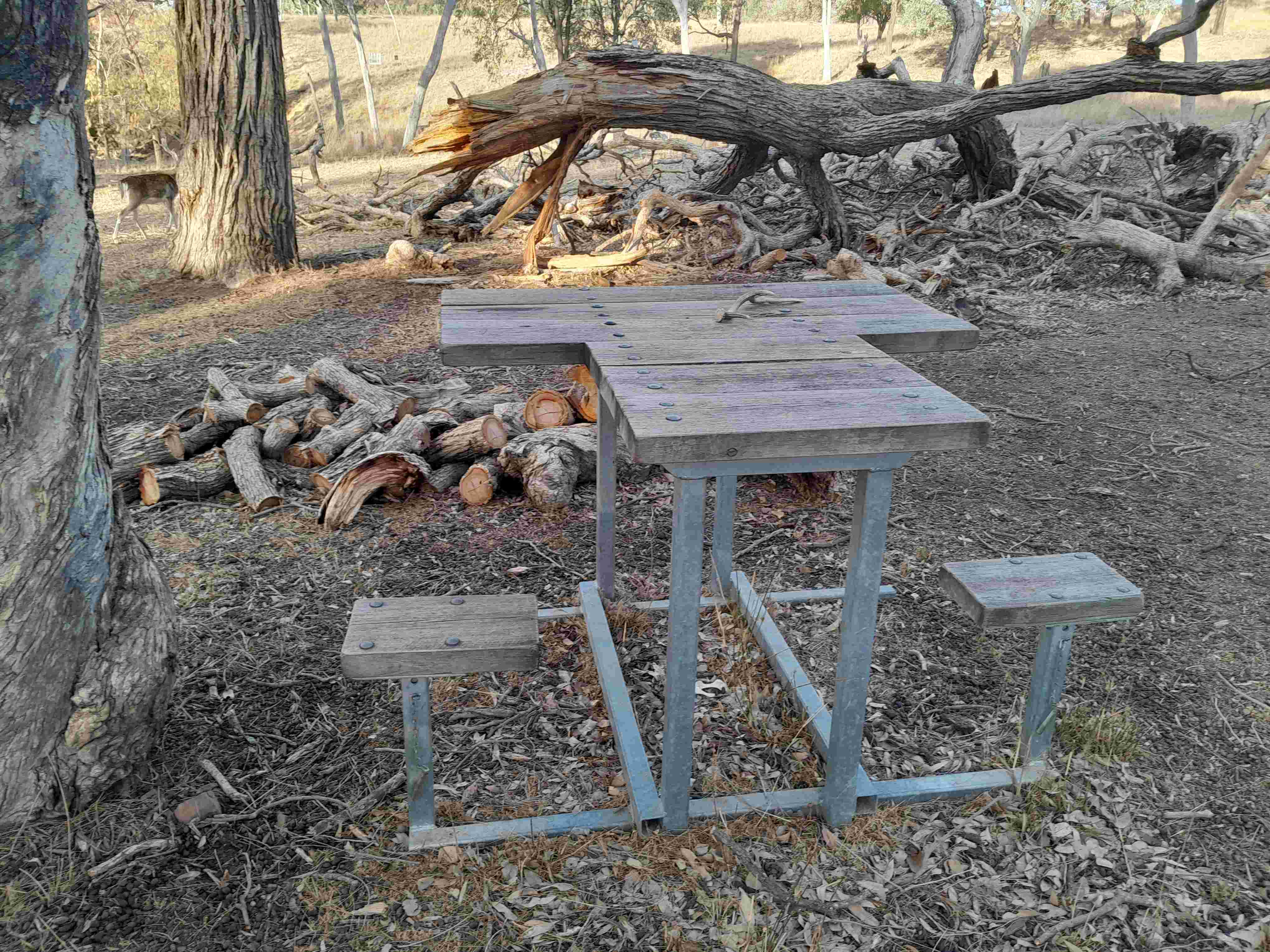

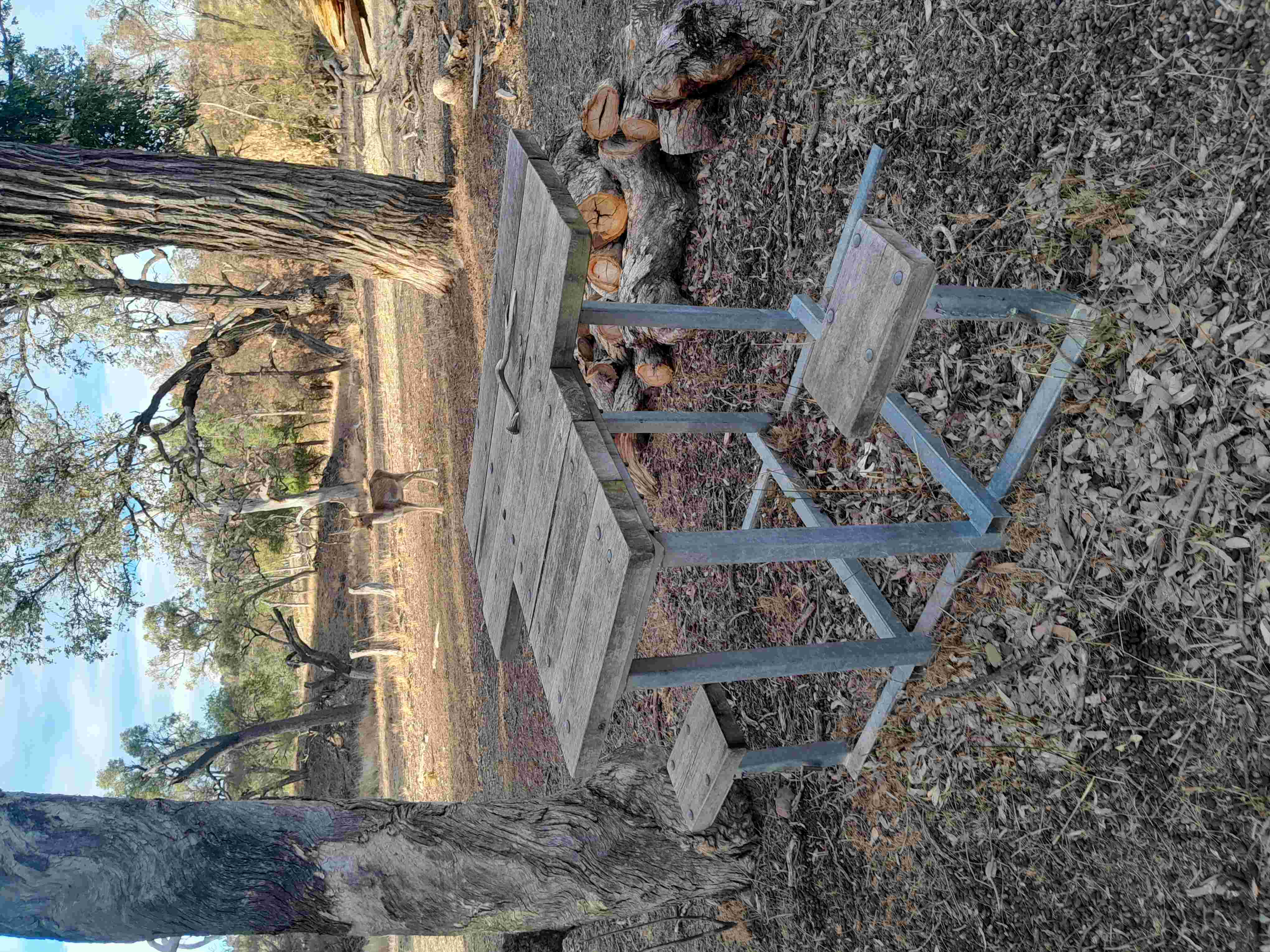

And a double-sided ambidextrous shooting bench I made for friends who come out to camp.
Excuse the mess, a giant Apple tree dropped a limb right in the middle of the campsite. Lucky nobody had a van or something under it. Be plenty of firewood for winter campfires though.
It's made from 50x50 box section. I had it hot-dipped galvanised so it would last under the old tree in the camp. I have set up target frames and gongs at 50 and 100yds too, to replicate the distances at the rifle ranges my mates shoot at.
The seats adjust up and down with pins on chains tacked on so nobody misplaces them. 40x40 box fits nicely inside the 50.
The camp it's at is at a bend in the creek, there's s dam on the other side and an 8x8m roof and a water tank plumbed into the kitchen inside for friends. I had this strange idea to clad the 2-room donger with old tin to make it look like an old shack. Which it does.

The only worry I have at times mate is people sometimes go apesh*t with huge campfires when there's hot and dry windy times. I just mention it if that's the case and trust people to keep things manageable.
If there's a danger from conditions, I'll park a firefighter trailer with a pump and hose reel setup for them and show them how to use it should something bad happen.
The grass on the flat at the camp attract a lot of different deer so they tend to keep the grass down there, as there is a waterer on a post on the tank stand so they come in and do that. Really lessens fire risk.
Also gives campers kids a real joy when deer come into the camp and come up for a bit of a hand feed. I reckon kids will remember that their whole lives and it's all there for them.
There's a BBQ pit with a frame over it and adjustable chains to hold pots to the right in the last pic. A few different BBQ plates to cook on too.
In the kitchen there's a proper sink, fridge, kitchen table/chairs and a full stash of pots, pans and gas bottle 2-burner stove if required, and a 4-burner BBQ outside.
And a generator shed, campers are responsible for their own power, if they want to use the air-cons in each room to cool or heat, because it's always below zero in winter.
The dunny is on pipe skids, it gets pulled over a new drilled post-hole and there's a shovel inside to cover the days evil down there, and a fold-down dunny seat.
This way, there's a dedicated comfortable spot to crap and for the ladies. And no dunny paper blowing all over the countryside.

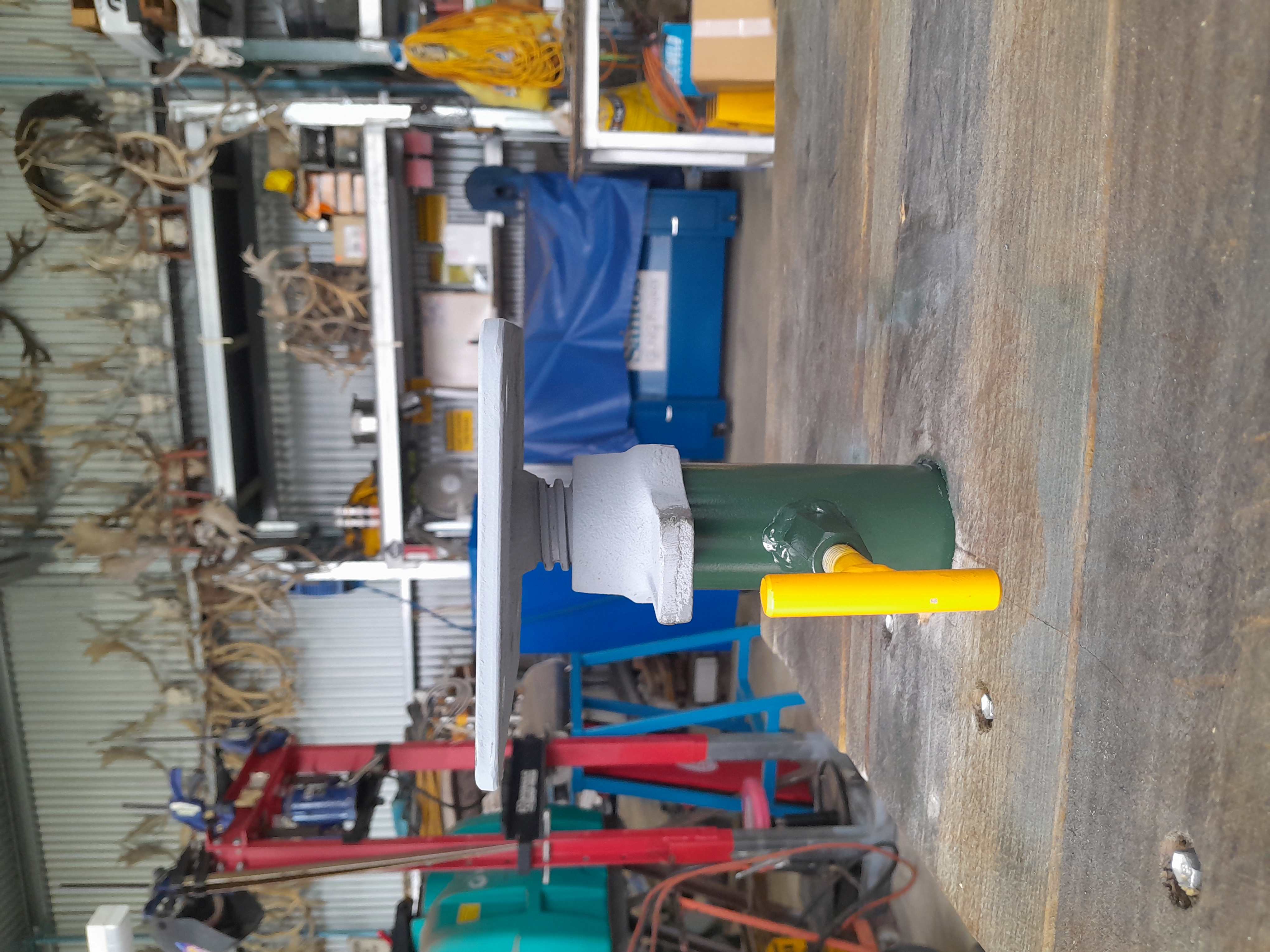

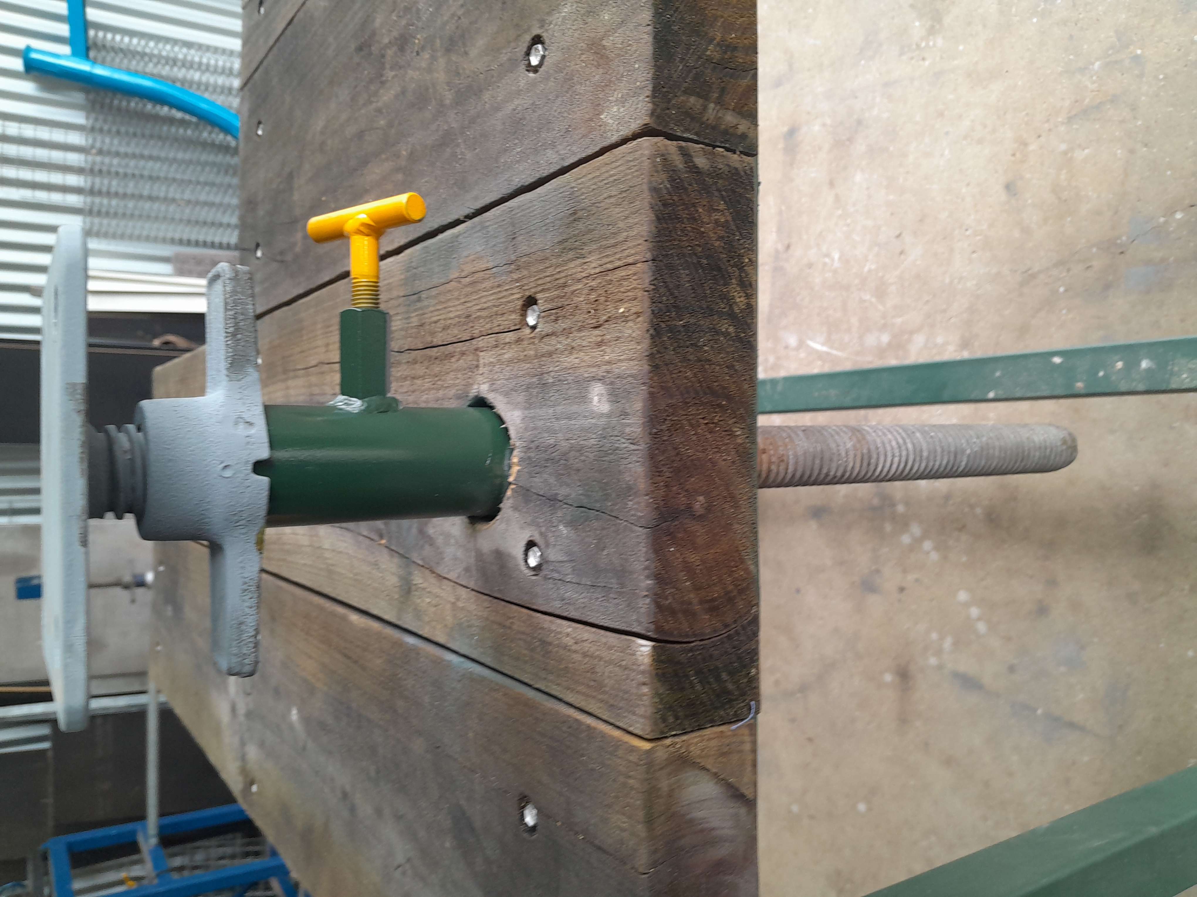

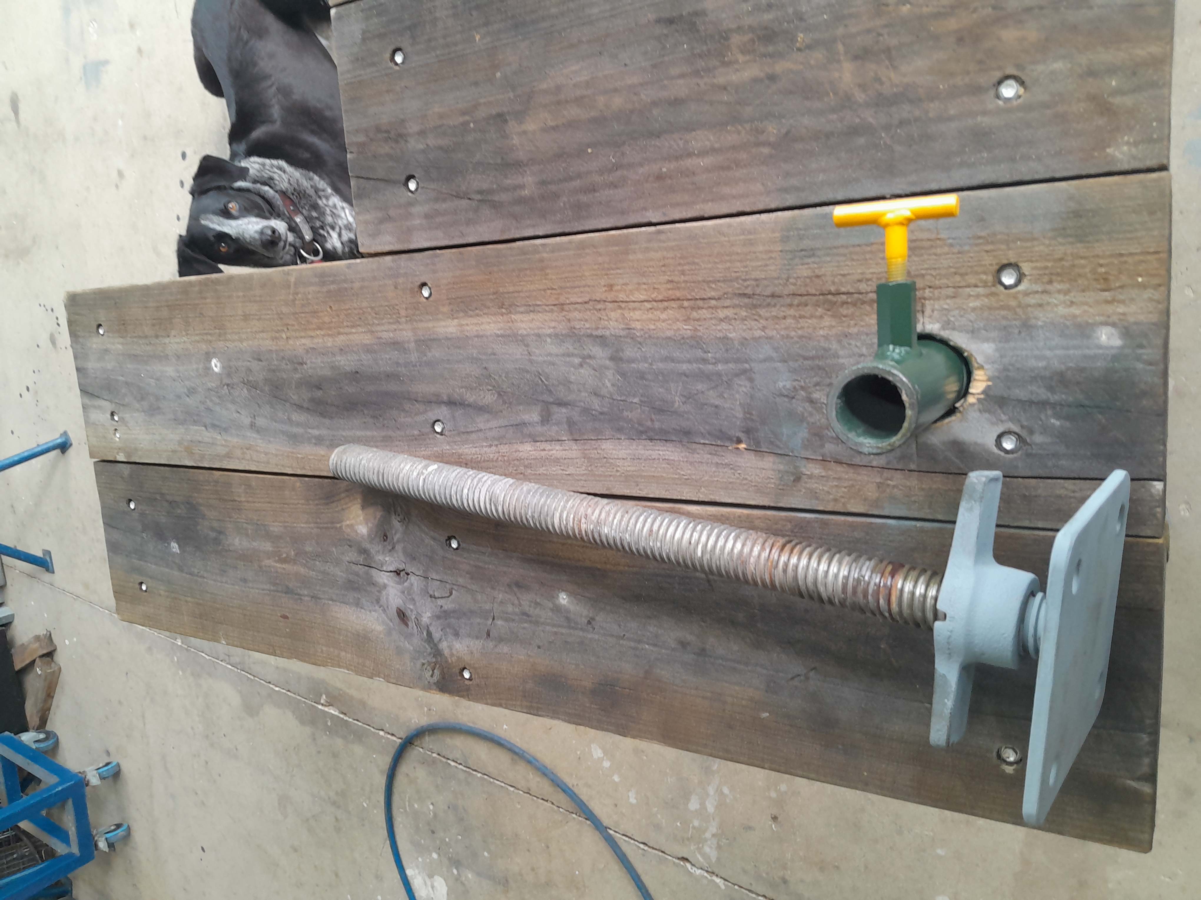

Well, got the bug and had to modify the house-yard benchrest as I have wanted to for a while. I have a few 300WM hunting loads to try and also chrony, but the rain had me piking out on that task.
These bug square-thread scaffold feet come in real handy for this sort of job. I had a length of A106 LNG pressure pipe that the threaded section slips through with barely a wobble, so I used that. Also made a lock screw for the side too, to eliminate any wobble that's left.
The thing will be used with a normal BR front sandbag, and a normal rear bag that's available everywhere.
The way-too-long threaded section will be cut right back once I see how long it needs to be.
Suffice to say, it will have plenty of elevation for any position or range.

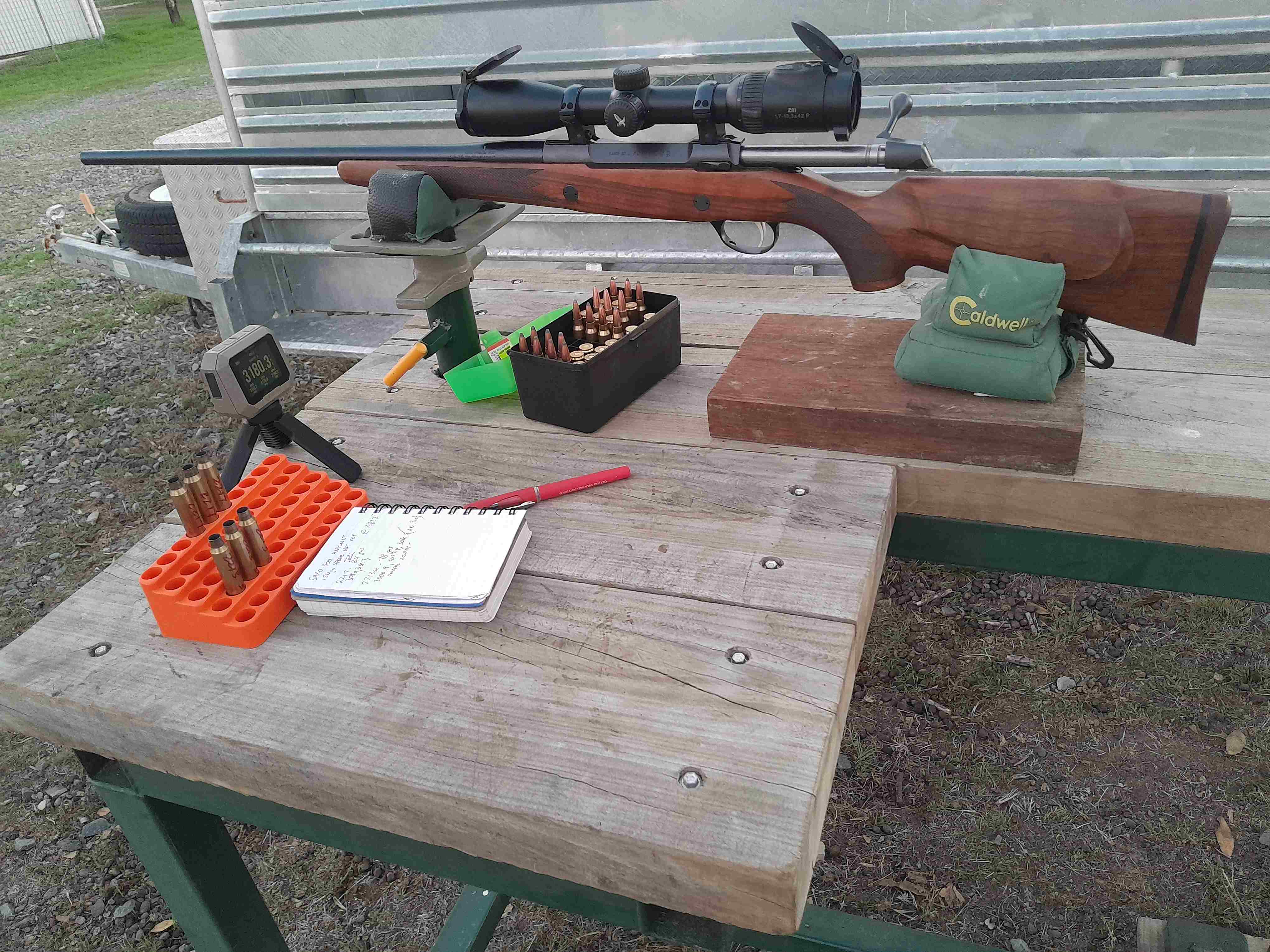

Tried the bodged up benchrest just before dark this arvo, with a few Hot-Cor loads.
I lift the drop-in threaded front rest out and stash it away with the rear bag so the sandbags don't perish in the weather, and I can still use my one-piece rest if I feel like it.
But it's rock still, crucial for testing loads properly.
