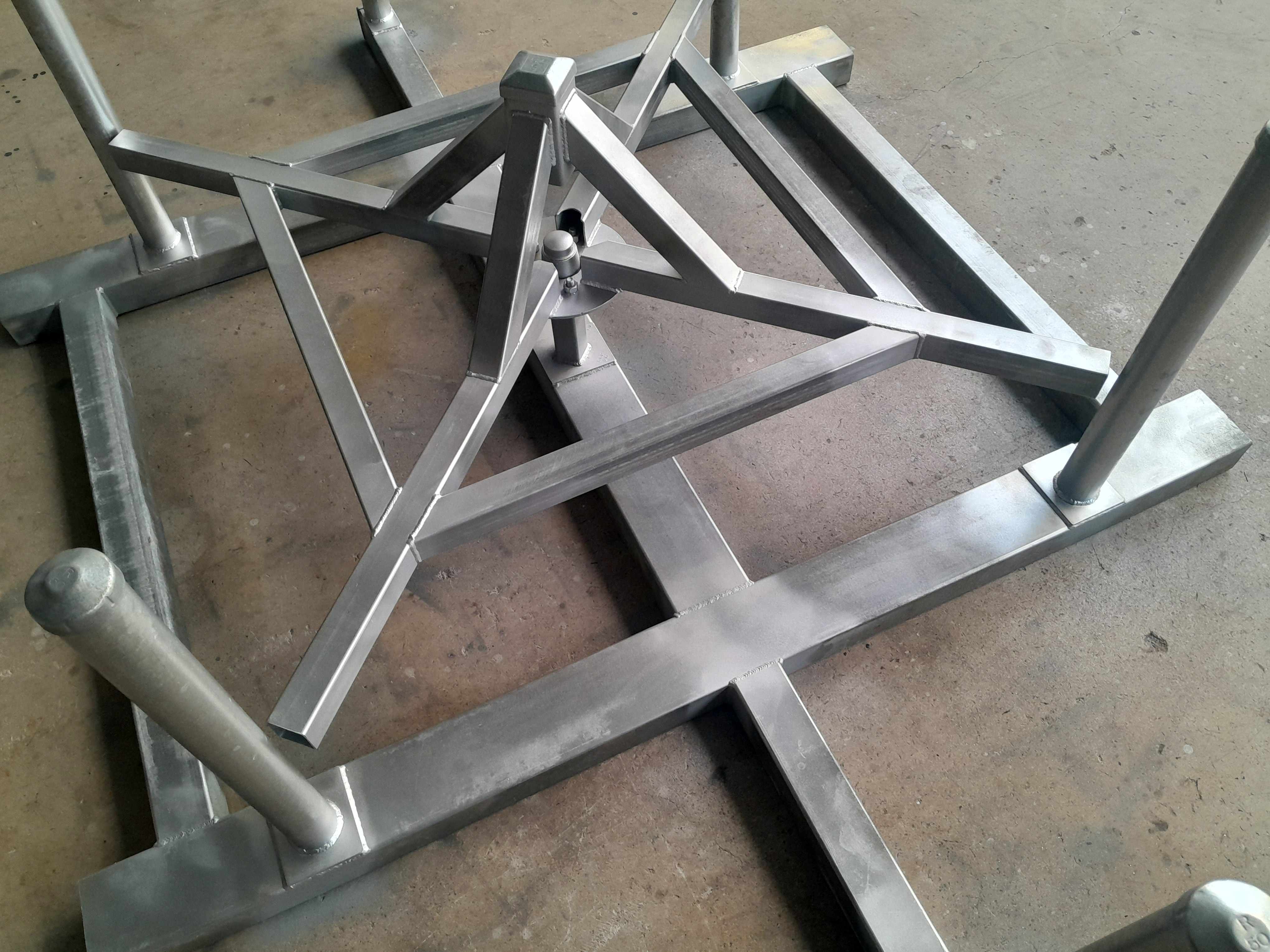

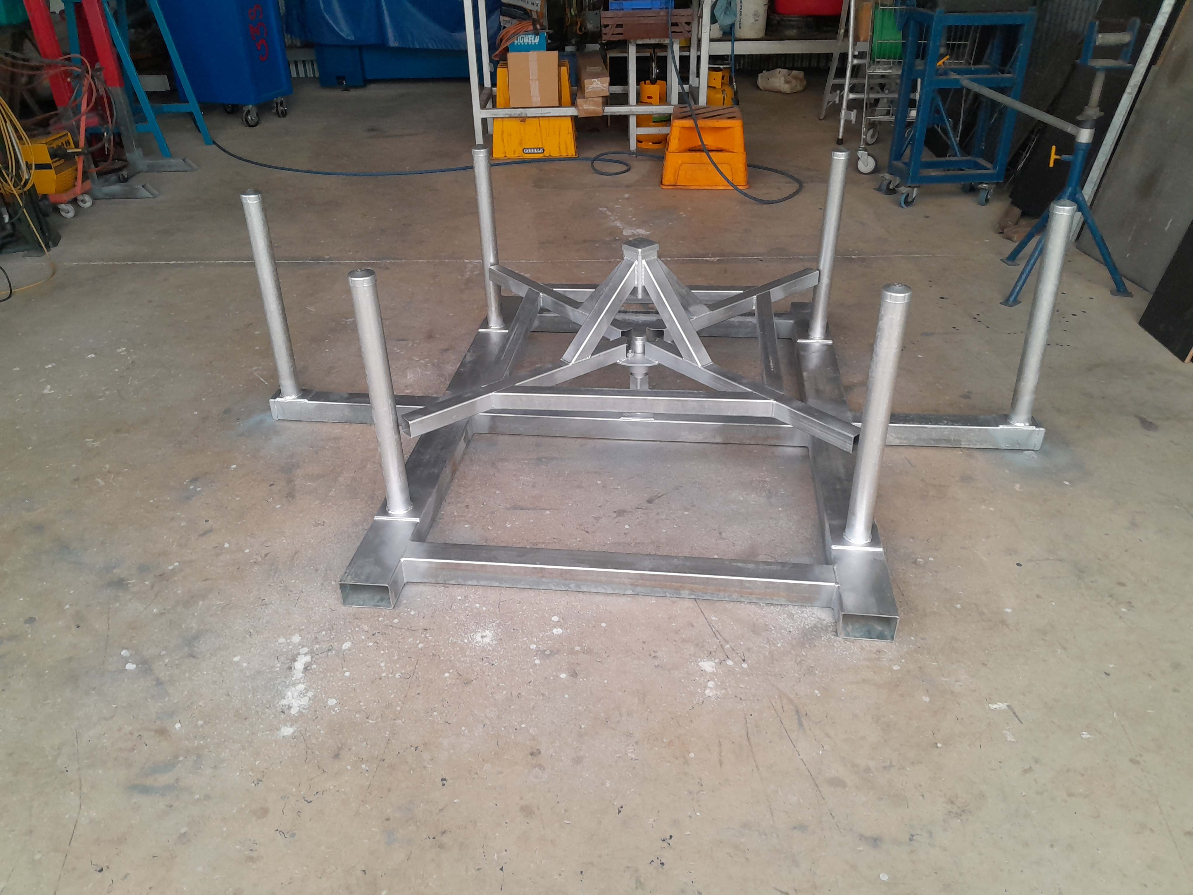

Finished the pipe spinner this afternoon.
Goes on the 4WD tractor fork skids, spins on a ford hub, so the poly runs out and into the pipe layer and down under the centre ripper tyne about 500-600 down.
Anyone who's tried handling 40 and 50mm blue-strip pressure poly in the 250m rolls, for kilometres of underground bore water to stock troughs, knows that hospital is waiting for your early retirement if you keep trying to manhandle this heavy stuff the hard way.
And great to keep up the welding skills too and tune up the hand-eye coordination.
The main thing to strive for is that the only thing the grinder was used for was to wire-buff the gasless flux-core welds for a coat of gal spray paint at the joints.
An old Boilermaker is shamed if he has to grind his welds.

Nice job. You are always busy :)
Leaves my welding for dead :(
I had to dig a trench with my mini excavator for mine but had nowhere the distance you have.

Very nice work
