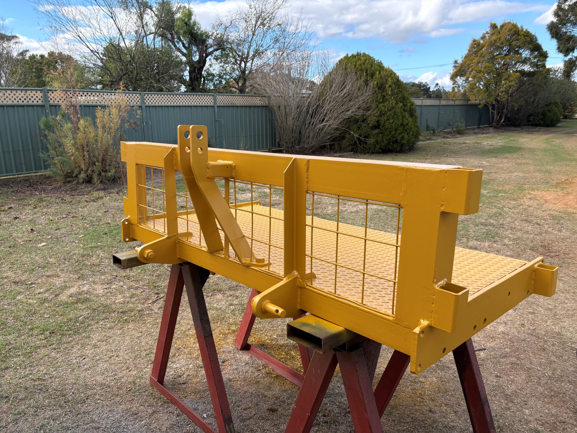

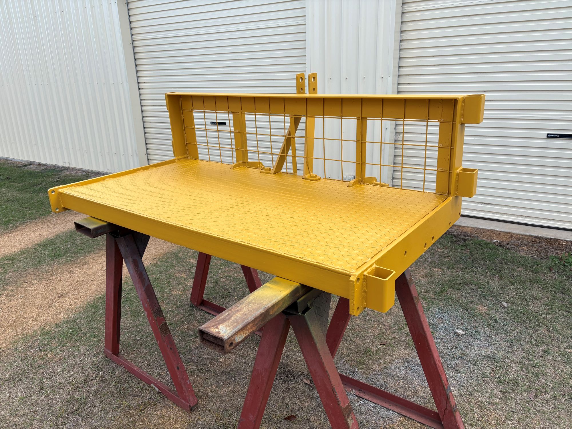

Post by Die Judicii » 06 Jun 2026, 8:31 pm
Well, after being side tracked for a while with my hydraulic crane/logsplitter that needed a new and different fuel pump,
I finally got back to the 3pl carry all that I made.
It's now had 3 coats of grey primer (today) which makes it look much better, being a uniform colour.
Next up will be the final top coats of colour.
primed carryall.jpg (729.87 KiB) Viewed 83 times

Post by Die Judicii » 08 Jun 2026, 7:53 pm
The "Old Formula" Caterpillar Yellow brings this project to an end.
Posts: 4368

Post by Wapiti » 08 Jun 2026, 8:06 pm
Great job mate. Hope you get a good price for that.
The Caterpillar mercenaries might be paying you a late-night visit shortly though. Unauthorised use of coatings!

Post by Die Judicii » 08 Jun 2026, 9:52 pm
It leaves both the chinese ones and the Australian made ones way behind for rugged build.
Here is a list of the major components used in the build.
Main Frame, 75 x 75 x 6 square hollow section (SHS)
Side Plates, 16 mm Plate
Head Frame, 100 x 100 x 8 angle iron
Under floor supports 75 x 75 x 5 angle iron
Under floor supports 50 x 5o x 5 angle iron
Floor 3 mm Checker Plate
Drop in Post sockets (to fit 50x50 posts 60 x 60 x 6 SHS
Head (without drop in posts) 500mm high
Floor 835mm x 1.7 meters
3 PL Category 2 pins.
