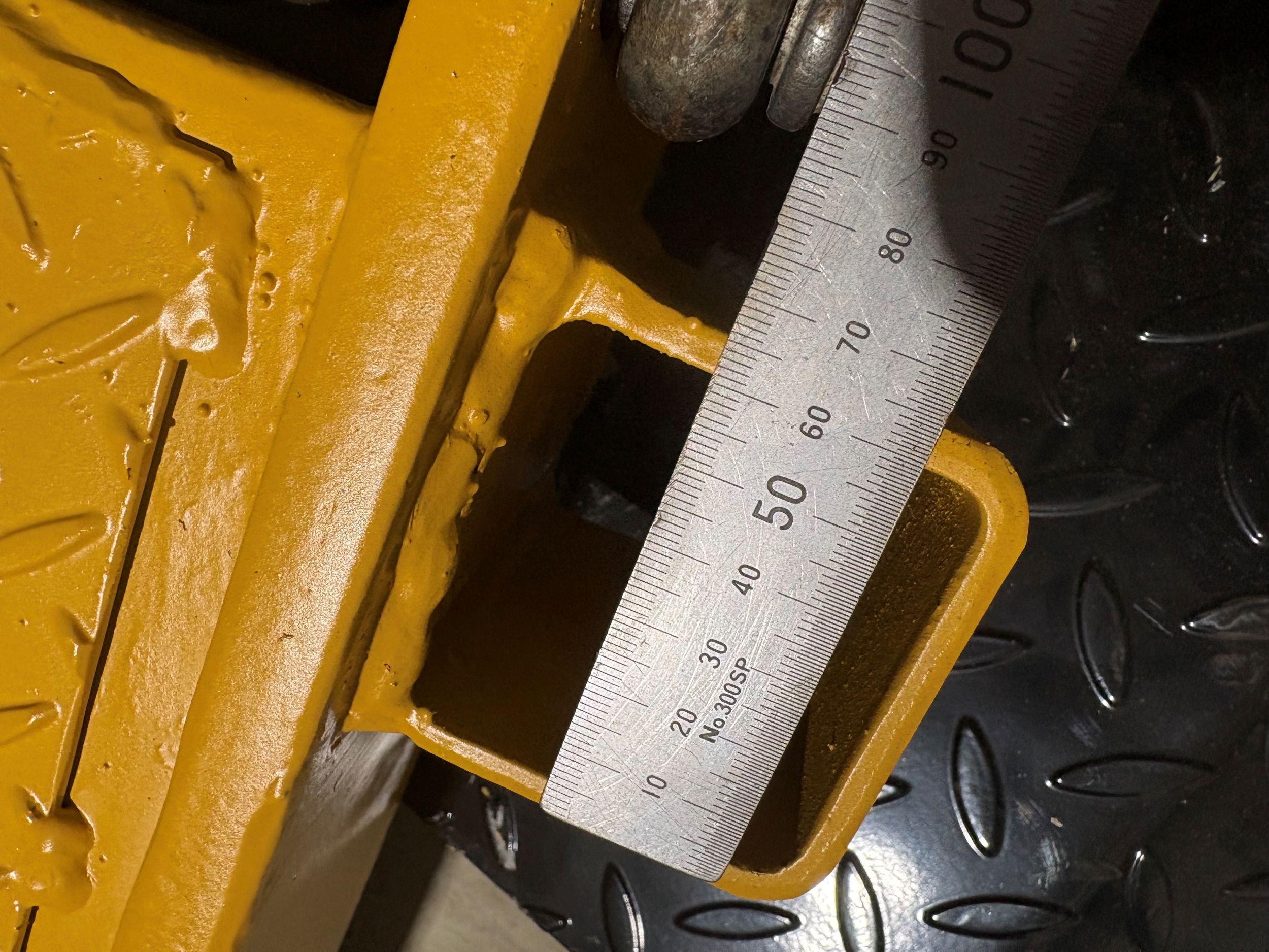

The "Old Formula" Caterpillar Yellow brings this project to an end.

Post by Die Judicii » 08 Jun 2026, 9:52 pm
It leaves both the chinese ones and the Australian made ones way behind for rugged build.
Here is a list of the major components used in the build.
Main Frame, 75 x 75 x 6 square hollow section (SHS)
Side Plates, 16 mm Plate
Head Frame, 100 x 100 x 8 angle iron
Under floor supports 75 x 75 x 5 angle iron
Under floor supports 50 x 5o x 5 angle iron
Floor 3 mm Checker Plate
Drop in Post sockets (to fit 50x50 posts 60 x 60 x 6 SHS
Head (without drop in posts) 500mm high
Floor 835mm x 1.7 meters
3 PL Category 2 pins.
Posts: 4370

Post by Wapiti » 09 Jun 2026, 7:38 am
Die Judicii wrote:It leaves both the chinese ones and the Australian made ones way behind for rugged build.
Might pay to just check those drop-in post sockets will accept the uprights you tell the customer 50x50 will drop in -
60 x 6 SHS has an internal dim of 48mm, without any clearance.
Even 60 x 5 wouldn't allow 50 box to slide into it, because of the welded internal seam sticking out internally. You'll need at least a mm per side for drop-in fit, with that irregular seam that's in all SHS.
Posts: 2449
Re: Stuff you made
Post by Die Judicii » 09 Jun 2026, 9:23 am
Yeah Mate, after 55 years in the trade I'm a firm advocate of "measure twice and only cut once"
The only mistake I made regarding the drop-in post sockets was when typing the list of materials as above.
The sockets are actually 65 x 65 x 6
So 50 x 50 posts do slip in easily.
So everything fits and works as planned.
