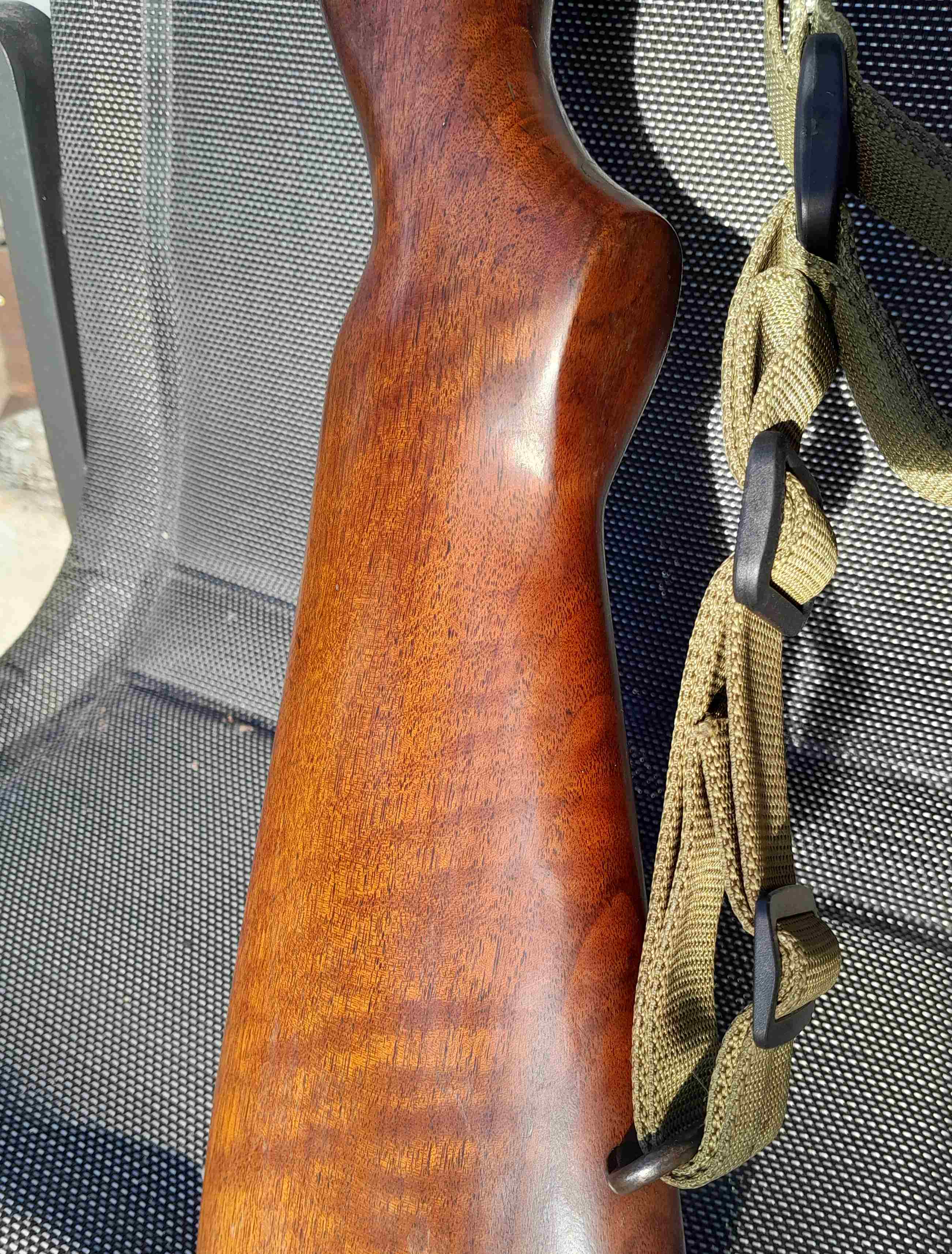

Here's an example of a stock I tried the wax on.
It's nothing special wood wise, just a piece of plain walnut. At least these makers used this wood though, so a bonus.
It was virtually black when I saw it, and the linseed oil it was pressure treated with from the maker was not designed to look good at all. Actually, I believe this oil on wood will protect it, but you have to stay on top of it and as soldiers found, in constant wet, it just fails, simple. Unless you sit under your poncho every night rubbing linseed oil into your wood, and praying the lube oil on the steel parts doesn't mix with it.
I believe it's use today is purely nostalgia, and lovely for the firearm that is polished and protected as a showpiece, but not for hard use.
Anyhoo, I soaked all the black out of this stock in thinners, used a heat gun carefully to bring out more oil ad-nauseum until it stopped. The wood was pretty dry then, and I started with the Danish oil thinned 50/50 with enamel thinners, rubbed in with fine steel wool. NO sandpaper.
As it dried to probably the 95% point during say, 6-8hrs, I would put a few drops of the mix again onto the stock to dissolve any drying drips and remix with the steel wool. And do it again and again, maybe 4-5 times until all finish stopped penetrating. Then I did it twice more with un-thinnned Danish Oil, but each time taking it down to the original wood surface.
Yes, there were tiny scratches visible in the sun from the steel wool, but I reckon the first 3mm of the wood is soaked in this polymerised, set oil, forming a shell.
This is inside and out. Inside is very important, especially on new guns you buy and bring home because I bet that the sealing in the inletting is either done poorly or not done at all. This is where all the oil collects and soaks in, and where the wood holds the moisture in it from your hunting that then rusts your metalwork and you never even know it.
Plus, cause your wood stock to shift POI in different temperatures and air pressures.
Then, a coat of wax and a polish with a piece of old denim.
This wood never showed any fiddleback was present at all with the dull old linseed oil finish, in fact it looked unworthy of anything.
There is no stain used here either, this is how the Danish Oil comes out, with the wax to take the surface to completely flat.
If you saw what I looked like before, you'd be pretty happy too.
