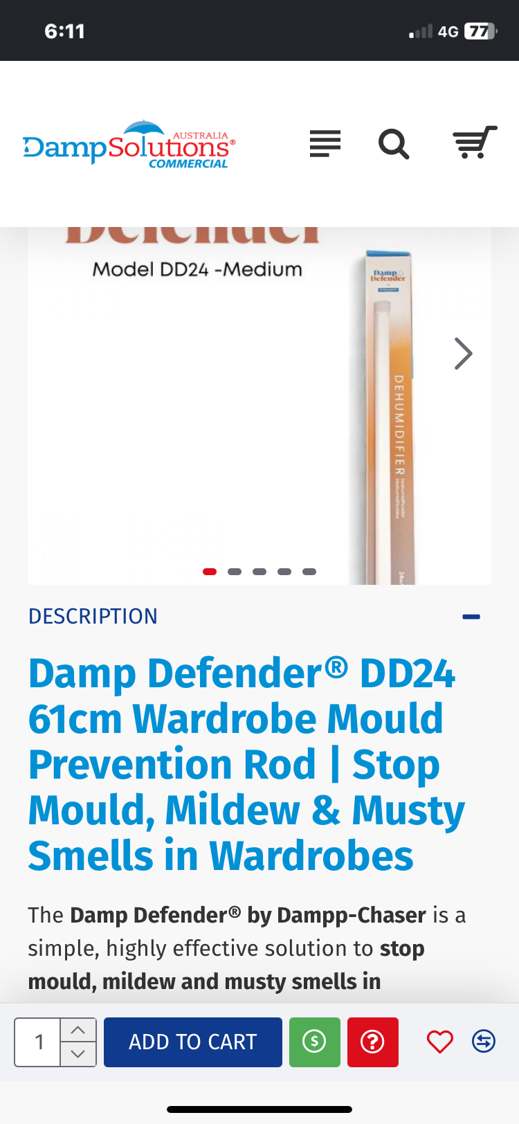

Post by 9.3x64 » 10 Jul 2026, 6:14 pm
This is it.
$135 . I have never had to replace a rod or do any maintenance in 20 years.
They were in Townsville but are now at Woody Point.
I got the 61cm length.
9.3x64
