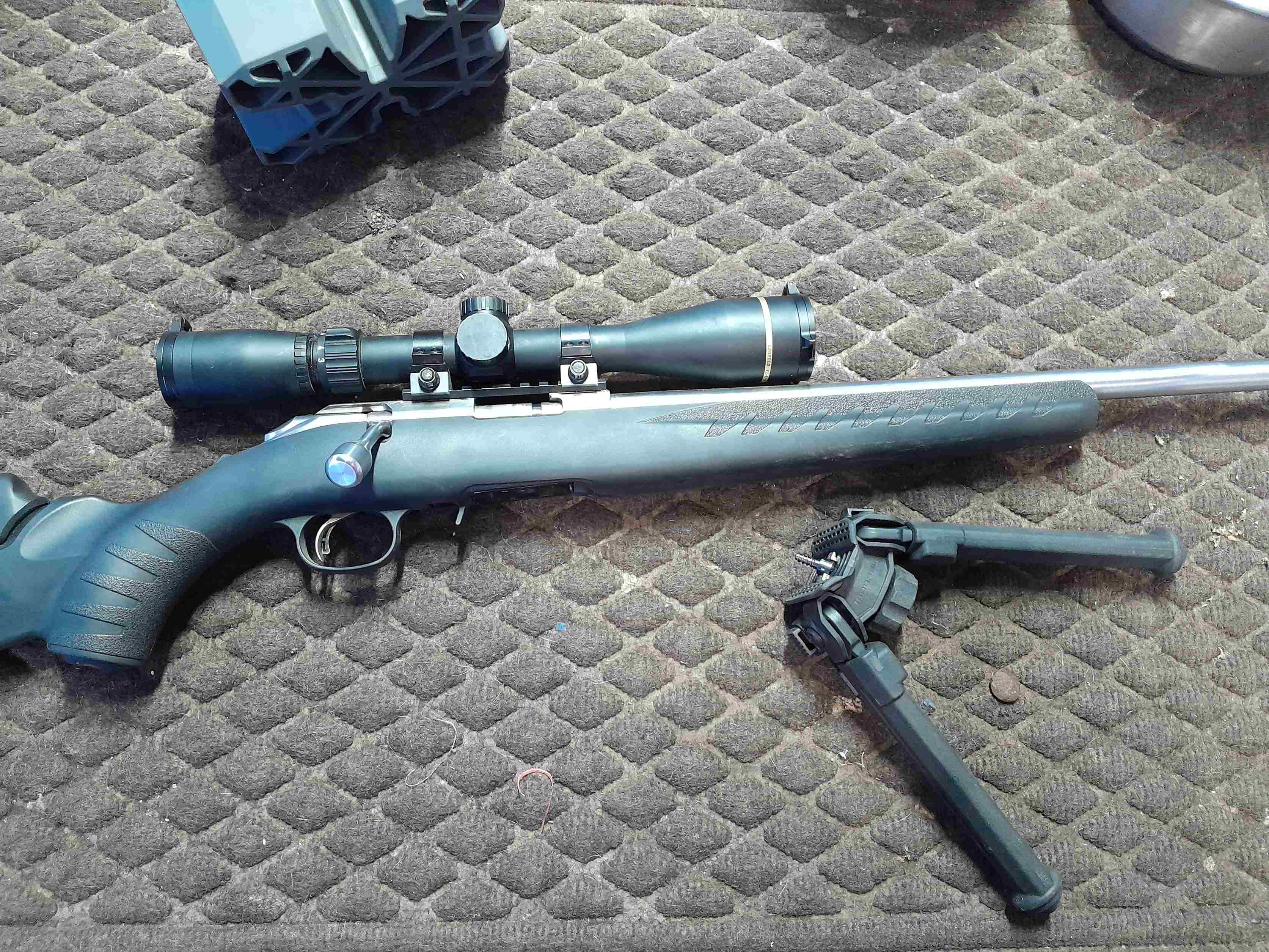

Anyway, yesterday I was shooting Minah birds that are trying to move in here, and on packing up and punching in the code to the house safe I dropped the rifle.

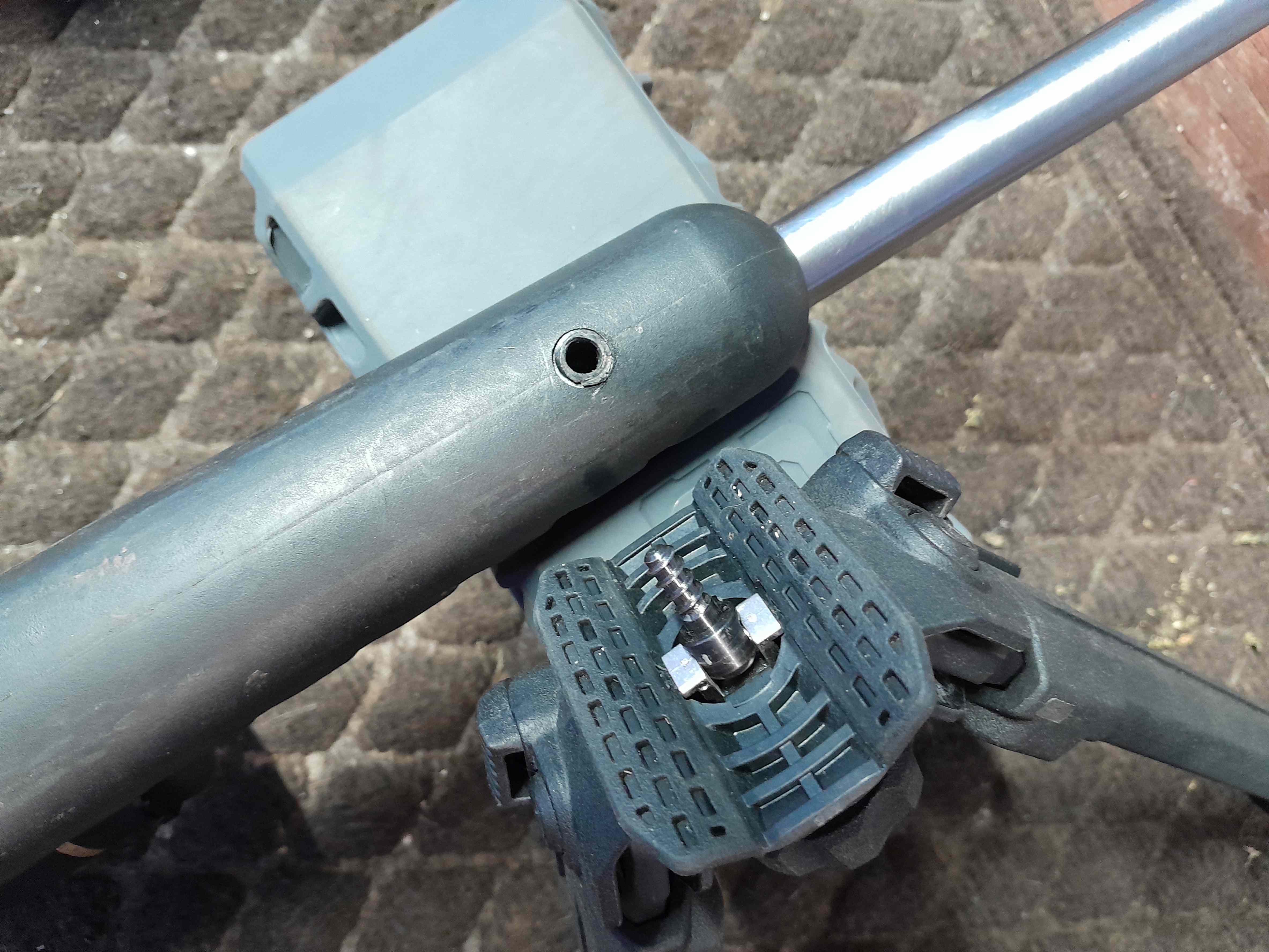

It had a Magpul bipod mounted to the front stud. The bipod hit the timber floor first, and ripped the screw right out of the plastic. The hit on the wooden floor pulled the threaded plastic right out. It cannot go back in again.
See the bipod here with the short, wood-thread type screw still in it.
This is a Ruger American 17HMR, a very accurate rifle, I reckon the absolute king of economy rimfires and sh*ts on virtually anything else in its price point, a perfect farm rifle like this in stainless. This thing shoots hundreds of rounds between cleaning, and just keeps on shooting pinpoint and taking out every bird. With some very good accuracy-enhancing bedding features like the moulded in stainless steel V-blocks to bed the action, and a completely solid polymer stock. Very bombproof bit of kit, except for this incredibly crappy cheap afterthought of how the stud is screwed into the plastic forend. What a way to screw up an otherwise tough-as rimfire!
Here, shown completely stripped out. No chance of putting the stud back in as it is.
So fellas, if you get your rifle out of the stock, check these studs are screwed into a countersunk nut on the inside. If not, take bloody care not to swing a rifle around with a sling stud installed like this, or you might be sorry.

JD, I don't have any faith that JB weld will work here, that kind of polymer just doesn't lend itself to anything sticking to it. Not well enough for me to trust it anyway. The poly of the stock that had the threads formed into it when the original stud was screwed in, is gone now.
I will just use a swivel kit and use out of it the threaded nut and tapped threaded stud that comes with it. Hopefully the hole is not too big to allow the little round, knurled nut to be countersunk in from the top, to hold secure.
The stock at the bottom there where the stud was screwed into at the factory is quite thick, the stud is just short of about 13mm long and didn't stick out into the barrel channel. Plenty of meat there, but the poly just wasn't up to a drop with the bipod on.
The bipod is unscathed.
If the nuts that come in those cheapie kits are too small for a proper hold from the inside, I'll just inlet in a small plate that I'll thread with the correct tap - I already bought this tap for some other project I've done.
