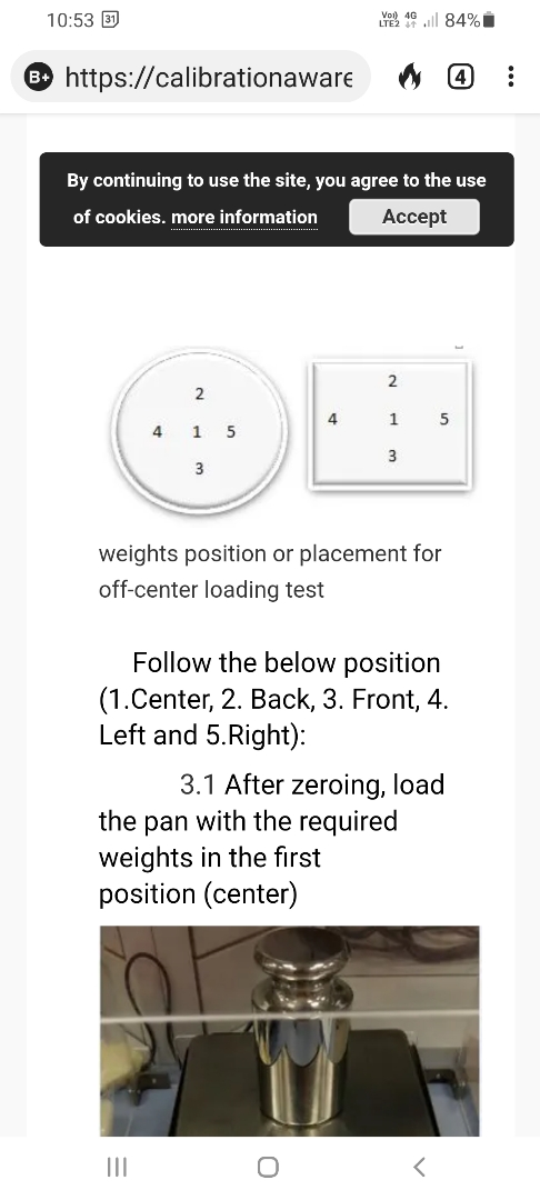

Re: No more electronic scales for me
Post by Bills Shed » 21 Apr 2022, 6:45 am
ash_hendo wrote:The only other bugbear is it is "pressure" sensitve, measuring powder in a tray where the weight is spread out gives a different result to say in a case where all the pressure is in one spot (by about 0.1 grain)
I gather that this is not an analytical scale then. One of the tests for setup on a analytical scale is the placement of weights in different positions. It must read the same when the test weights are placed at the edge of the weighing plate as the centre of the plate.
Temp is hard to manage but turning it on the 30min before hand is the solution. Laboratories just do not turn them off.
I solved the vibration issue by building a small shelf out from the wall to hold the scale. The bench is not bolted to the wall so no vibration transfer either.
There are no free lunches and they all have their drawbacks. In the end if it works for you use it. All tools have a purpose and we use them within their limitations.
Bill
Bills Shed
Posts: 435
Post by ash_hendo » 22 Apr 2022, 8:28 am
Bill
Not the most expensive scale in the range, I put it down to that.....
Bills Shed wrote:Temp is hard to manage but turning it on the 30min before hand is the solution. Laboratories just do not turn them off.
Bill
Mine unfortunately has an auto-off at 5 min of no use..... I think it needs 30 min to settle as you say, then I trust it...... It uses so little electricty even on battery mode I wonder why they would do this, or not allow the timeout ot be several hours...... anyway, now I know its limitations, I'm happy. I always throw a bunch of charges into small cups and re-weigh before charging the cases. Anything I created after 30 min of run-time is usually spot on.
ash_hendo
Posts: 95
Post by Oldbloke » 22 Apr 2022, 11:08 am
"One of the tests for setup on a analytical scale is the placement of weights in different positions. It must read the same when the test weights are placed at the edge of the weighing plate as the centre of the plate."
Nothing to do with analytical scales. It's just the correct way to calibrate/test any electronic digital scale using load cells. Weights should be traceable.
To check a beam balance you would simple use 3 or 4 tracable test weights.
Say for example, 10gr, 50gr, 100gr, 250gr. Total 410gr (most powder scale max out at 500 gr) Starting with 10gr adding them one at a time and checking Weight indicated each time. This way the scale is checked throughout its scale/range from 10gr to 410gr
I simply have 3 weights (Small SS nuts) I use to check my beam balance. But usually just zero and use/check one of the smaller weights each time I use them.
Posts: 13252
