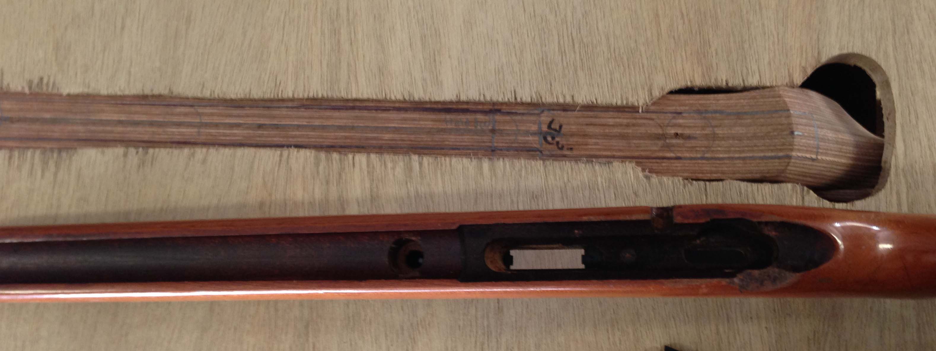

Side by side view of Lithgow stock (bottom) and Boyds stock (with initial mark up lines) in routing table

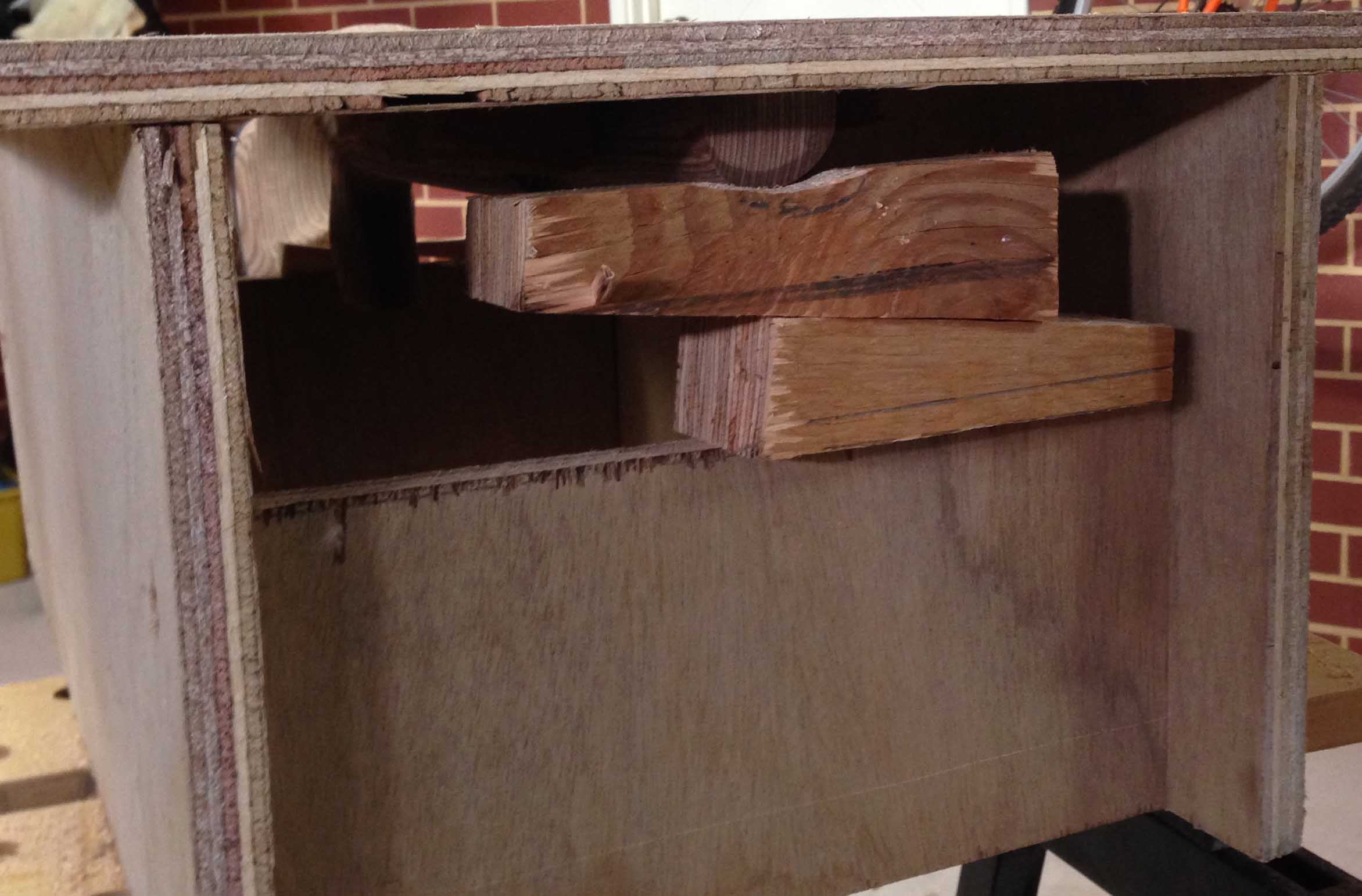

I set to making this table with the concept being that the stock would be clamped in place using simple soft wood wedges. I had some 12 mm ply that I cut up to make the table and so that I didn’t need extra-long shank router bits, the table needed to have a recess to seat the stock in so that the stock surface was only a few mm below the table surface. The recess also had the advantage of helping to hold the stock in place laterally during the routing process. Below are photos showing the development of the table, the recess and finally the stock in place. The action area of this stock has a “kick” of ~ 10mm to suit the receiver of the Ruger 10/22 that it is more commonly sold for. This got in the way of the recess so a full penetration and wider cut out needed to be made in the table to allow for this (more on this latter). Also, as I wanted to retain as much meat on the table for strength purposes, I made it longer than the stock at the front and rear – this then required a cut out for the high cheek rest of the stock.

Stock mounted in table – note soft pine wedges under the but piece
stock in table nose.jpg (195.29 KiB) Viewed 15935 times
Front of router table with stock clamped in place with timber wedges.

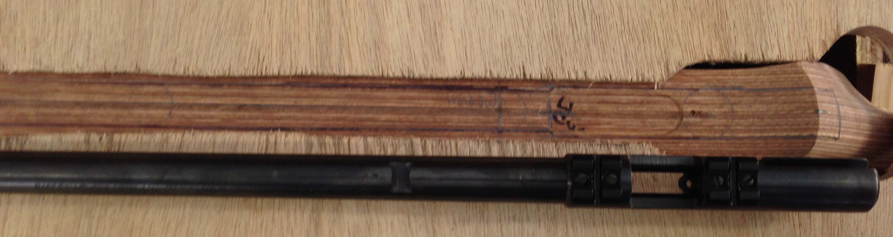

I started the mark up process by laying the action on the stock and trying to get a good position for the trigger relative to the hand grip on the stock. Once done, the position of the rear of the action was marked on the stock, the trigger assembly removed and the barrel and receiver laid on the stock to allow me to mark the position of the hold down bolt (simple on the Lithgow as there is only one bolt).
I set out the original stock inlet dimensions on the new stock once I had established the correct centre line of the new stock and the hold down bolt position. This proved a little problematic as due to the previously mentioned taper in the stock and the combination of work light, stock colour and marking pencil colour made things a little difficult to see. For the set out of the centre line I used a compass and normal wood marking gauge. I also made sure that I marked the barrel inlet depth and radius on the front of the stock so that I could keep track of the starting router depth throughout the rest of the process.

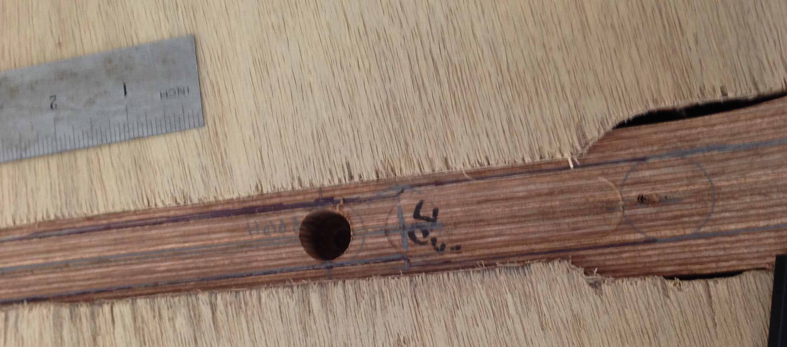

The first move from here was to select an appropriately sized bit ( I was intent on using the original hold down bolt for this) and drill the hold for the hold down bolt right through the stock. I made sure this went slowly as it was to pass right through the stock and I didn’t want to splinter the underside when the bit exited with stock – sharp bits are essential! It is important that the drill was kept square to the top surface of the stock – a drill press would have been ideal but I got by using a level and a square. Once this pilot hole was through an appropriately sized blade bit was used to drill the hole to accept the hold down lug on the barrel to a depth measured off the original stock.
hold down hole.jpg (182.9 KiB) Viewed 15882 times

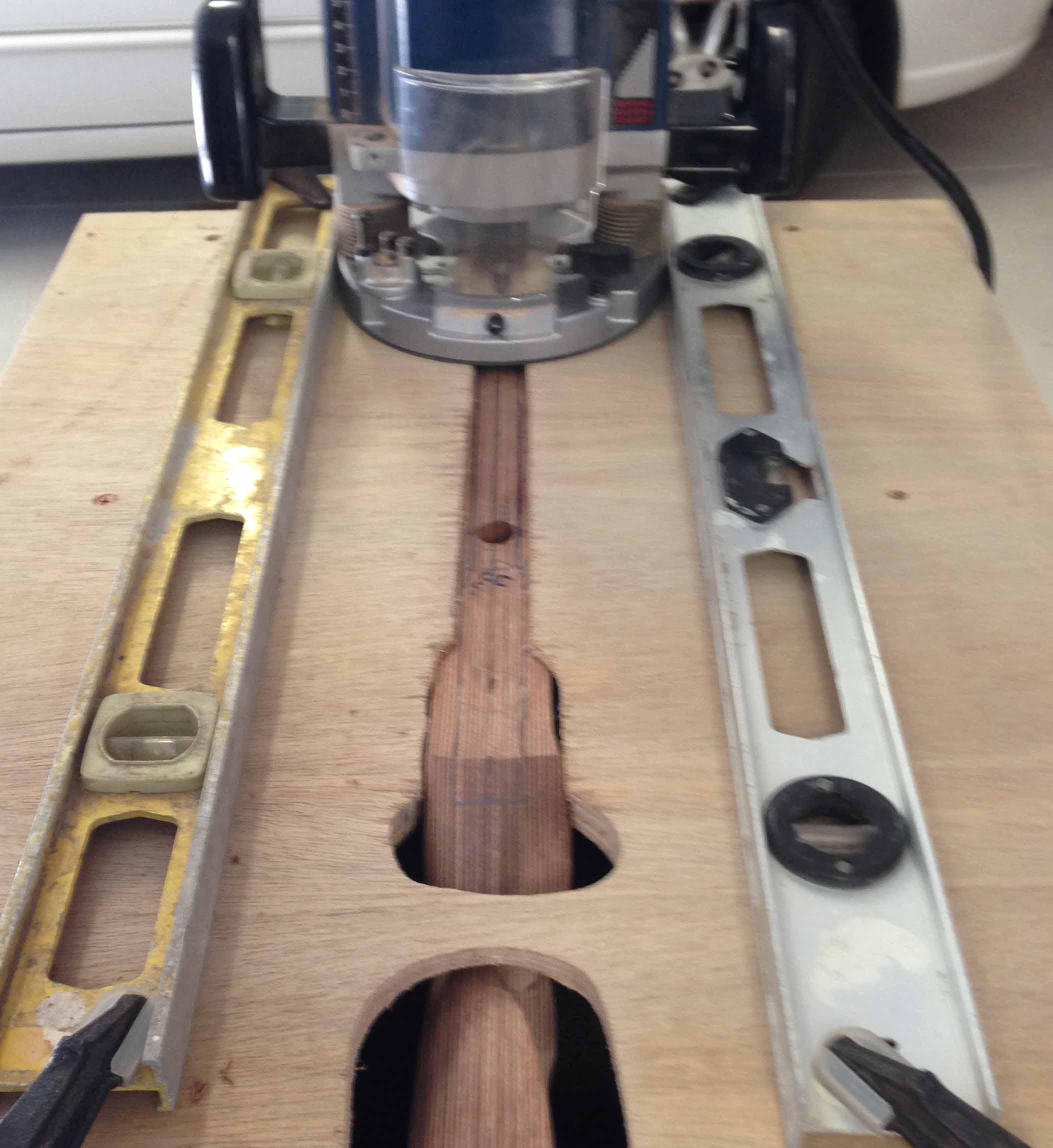

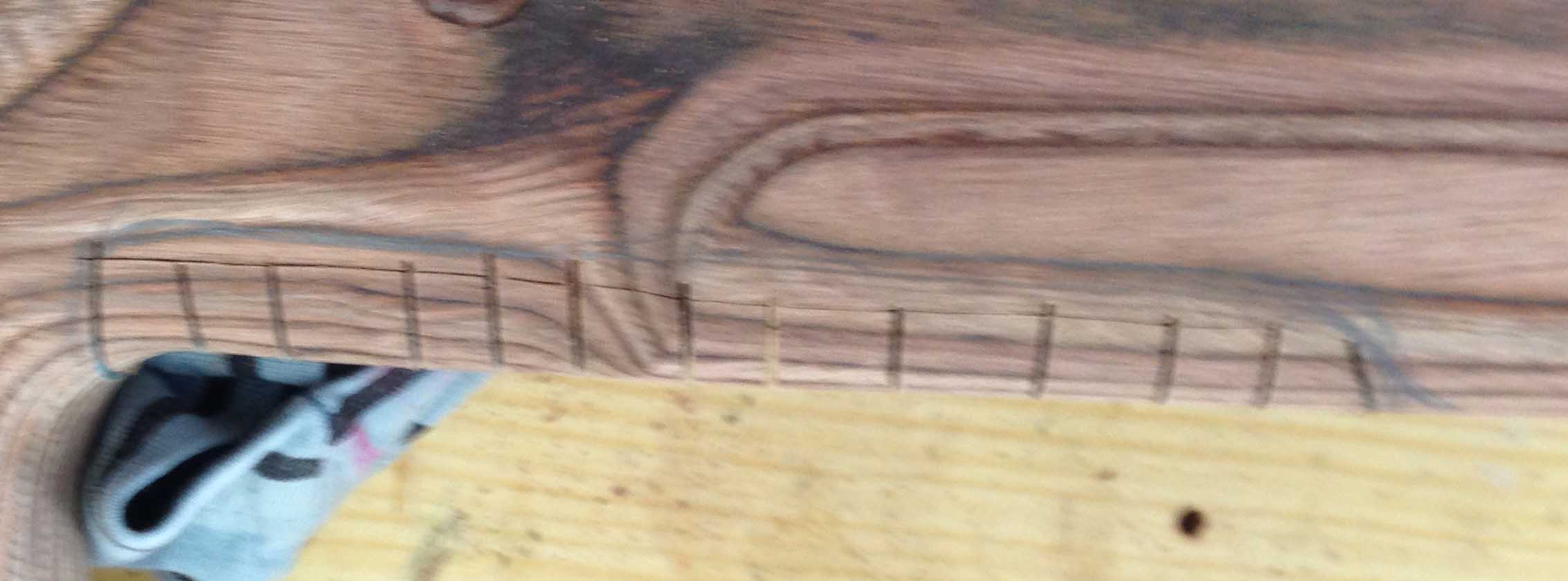

As the barrel has a taper, the inletting must also taper both from side to side and in depth. So that this taper could be easily achieved, I released the wedges on the barrel end of the stock and inserted a 1mm packer on each side of the stock and then reclamped the stock with the wedges. The 1 mm is the approximate difference in depth from the front of the stock to the start of the action inletting in the stock ( 2mm barrel diameter difference). This was much easier than routing a constant depth inlet for the barrel and then having to remove the extra by hand.
I set out router guides on either side of the stock to keep the router along the centre line of the stock while I cut the barrel inlet to the full centreline depth in several passes.
router 1.jpg (199.6 KiB) Viewed 15882 times
Set up for routing – note the “high tech” guides. Initial plan was to screw timber guides in place. Much easier to clamp levels which definitely have a straight edge

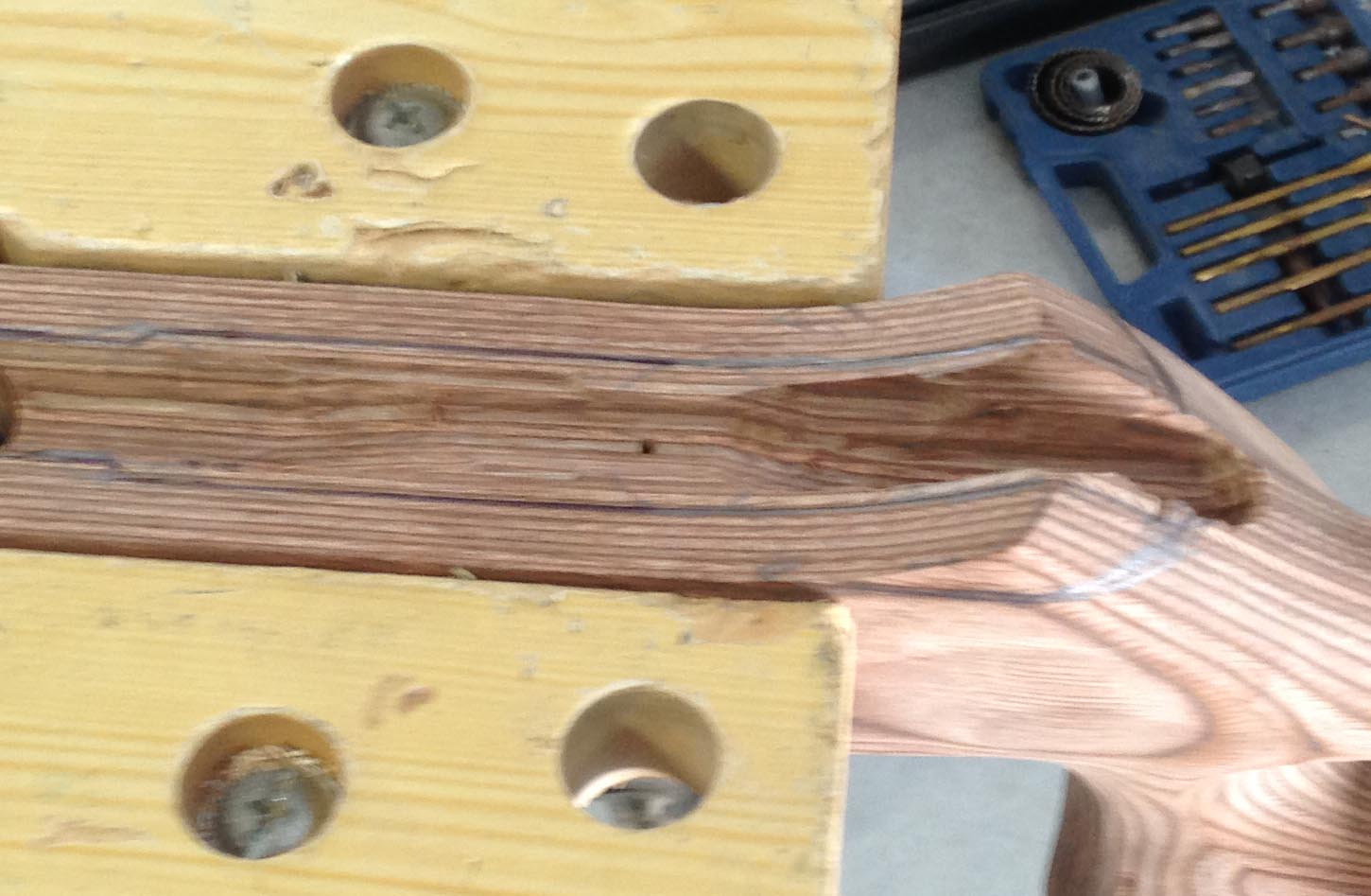

I identified an issue with the previously mentioned kick in the rear of the stock breach area. This protruded too far upwards and limited the travel and depth of cut of the router. As this was an aesthetic only feature, the application of an electric plane to this area eliminated the issue for good.
hump be gone.jpg (150.94 KiB) Viewed 15882 times
Hump be gone

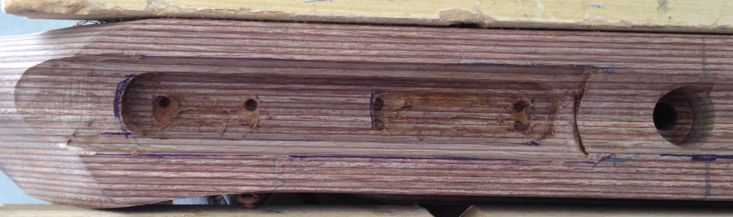

Inletting of the action was to follow with initial mark up and then numerous test fitting and dremel work following the initial cut in with the router. This was not the neatest bit of work but as I intend to bed the action (after the initial test firing) then the messy bits will be taken care of.
A lot of this work was done on the workmate following the initial routing cuts on the router table.
action inlet.jpg (180.12 KiB) Viewed 15965 times

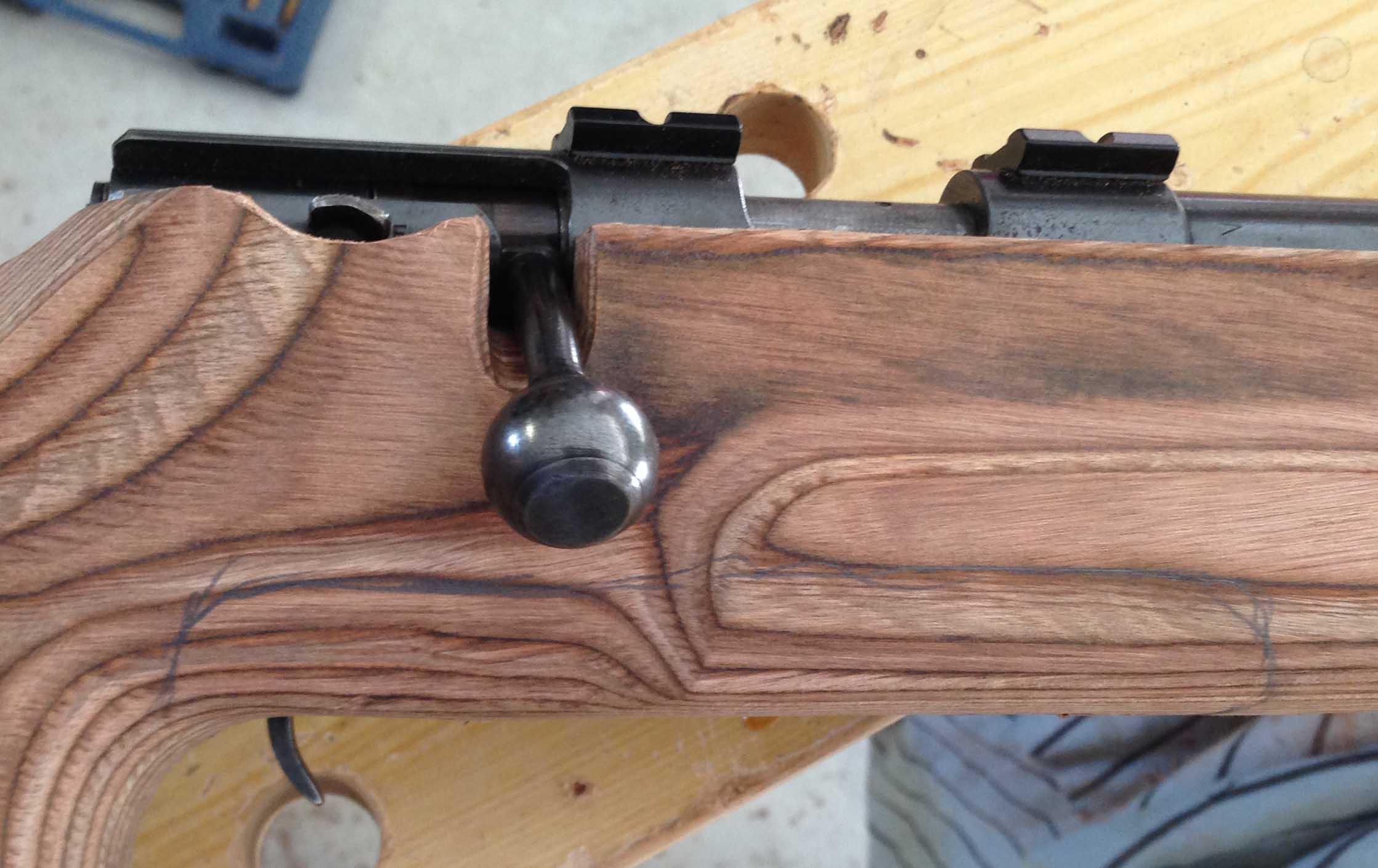

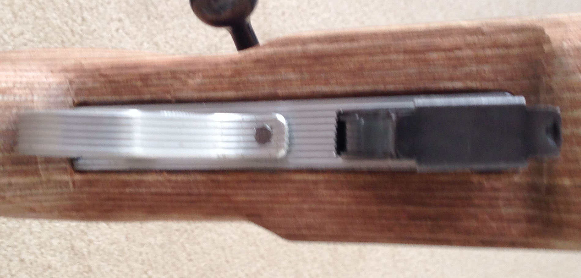

For the final penetrations for the trigger and magazine, holes were drilled on the corners of each marked up opening and the material cut out with a hand held coping saw. This was required due to the limitations in depth of cut of my router. The penetrations were then cleaned up with the dremel and a hand file.
Once this was done, the action needed to be fitted into the stock to allow for the safety catch operation and a cut out for the action bolt. This was done with a combination of the dremel and a saw.
bolt in place.jpg (202.77 KiB) Viewed 15965 times
As can be seen in this photo, the trigger doesn’t stick out very far and therefore some timber needed top be removed for the stock to allow for this. I identified this as a potential issue when I first recrived the stock as the stock ws much deeper than the original lithgow (but still within Silhouette stock regulations)and the hand grip seemed a little short). The stock was marked up and several cross cuts were made and the remaining material chisled out and the area cleaned up with a rasp, shaping file and scraper blade.
area to be removed.jpg (110.71 KiB) Viewed 15965 times
Area to be removed from stock for trigger and magazine areas.

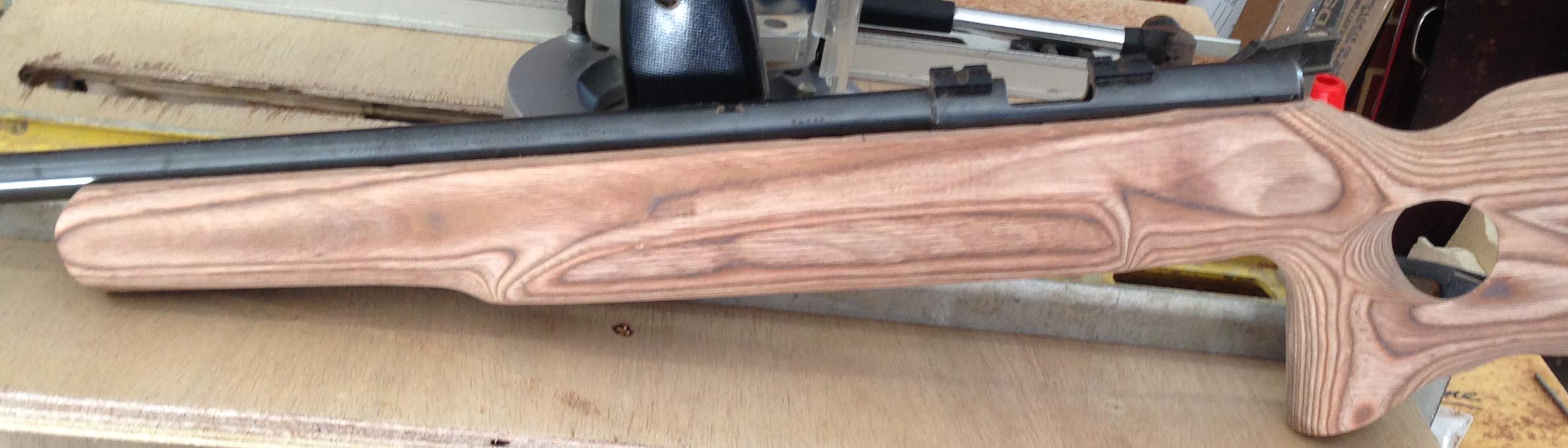

nearly there.jpg (127.03 KiB) Viewed 15965 times
Nearly finished aside from trigger guard and applying the finish

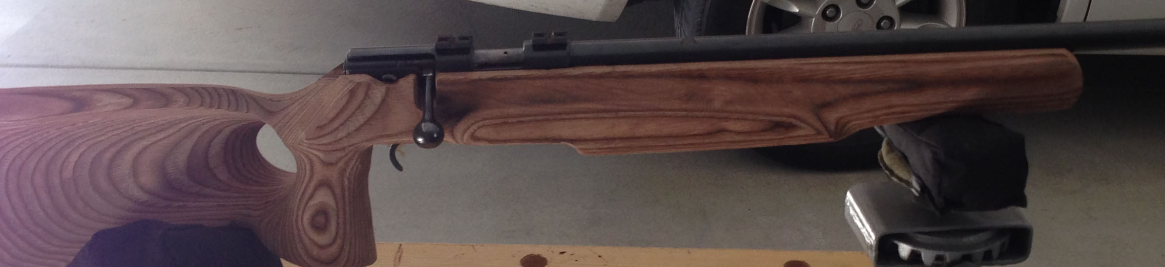

The rifle was then assembled for a final once over before it was stripped for painting, sanding and oiling.
finished before oil 2.jpg (216.5 KiB) Viewed 15965 times
Final assembly before stripping for final finish application
Following sanding to 320 grit and then a 0000 grade steel wool polish, 3-4 coats of Tru-oil stock finish was applied to provide the final finish of the stock.
finished 2.jpg (227.69 KiB) Viewed 15965 times
Final assembled rifle.
