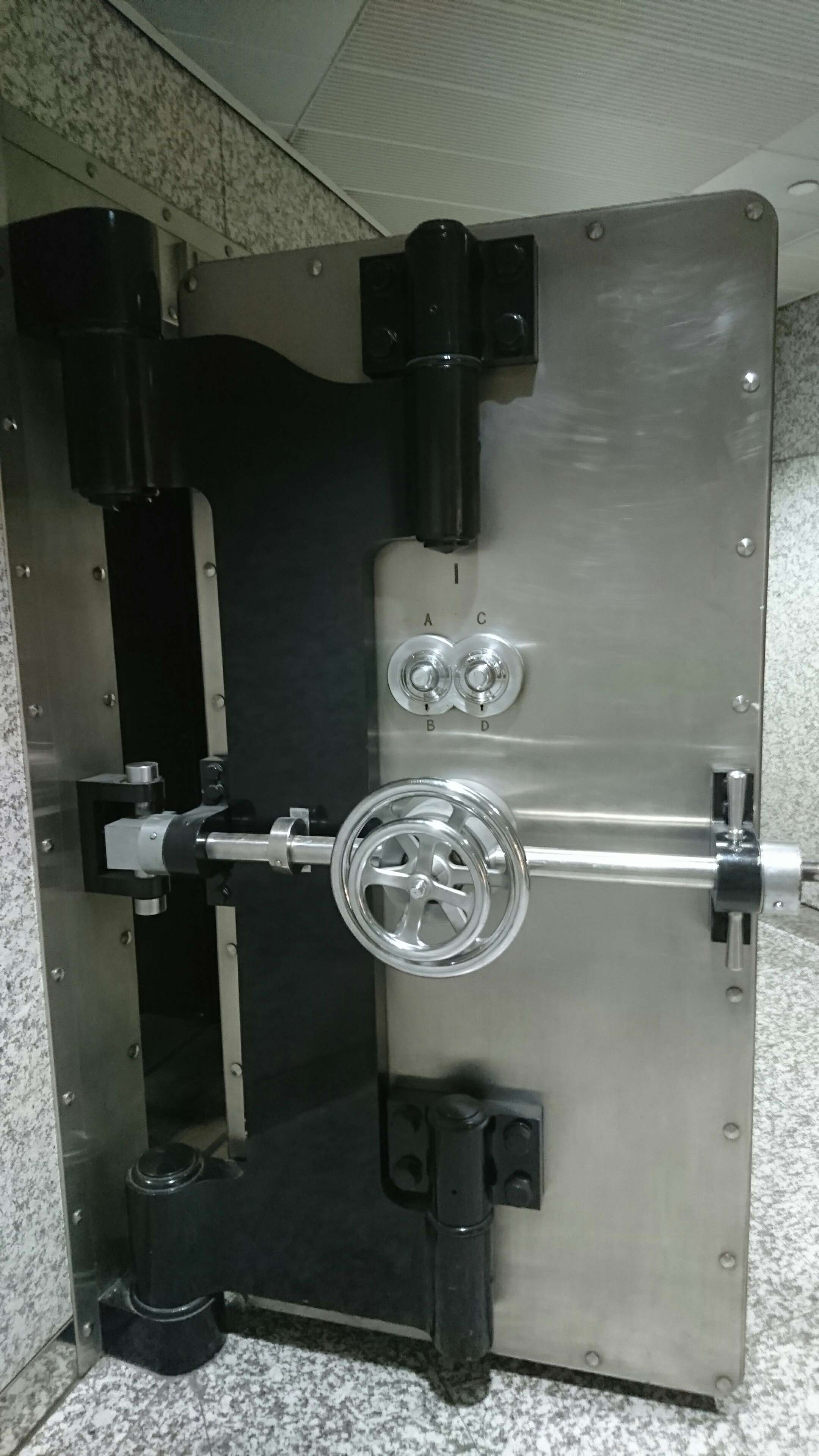

Post by Bent Arrow » 13 Apr 2018, 5:44 pm
Here's one someone else installed earlier
Posts: 747
Re: Safe Installation
Post by sungazer » 13 Apr 2018, 6:46 pm
I don't know bent do those door hinges comply? :)
Post by Bent Arrow » 13 Apr 2018, 8:21 pm
sungazer wrote:I don't know bent do those door hinges comply? :)
Being external hinges, probably not
