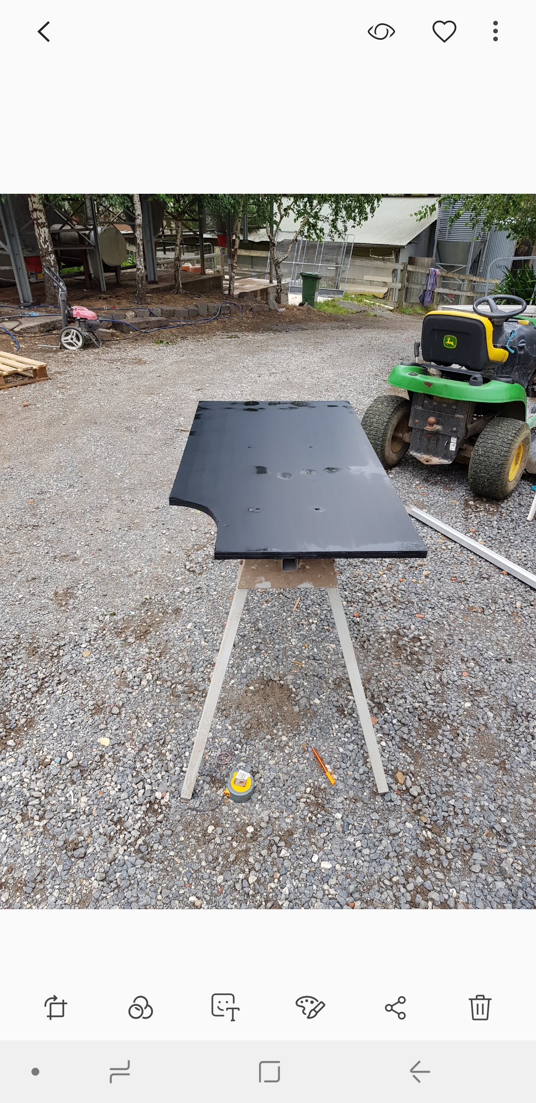

So yesterday decided I need a shooting bench, as my 1000L IBC is not stable enough. So got me a 10 dollar formply sheet. And 2 saw horses.
Had an hour as the wife and kids are hunting for food.... at a butcher. So started working and spied the work bench with folding legs I had lying around from the Bosch circular saw I never really used, as the saw got relegated to cutting aluminum channels. So a few minutes later I have my new shooting bench ready and painted in matt black cuz we is coolz.
So total cost of bench 10 bucks. Not bad effort
