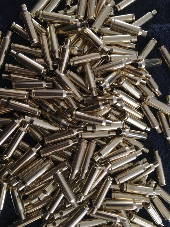

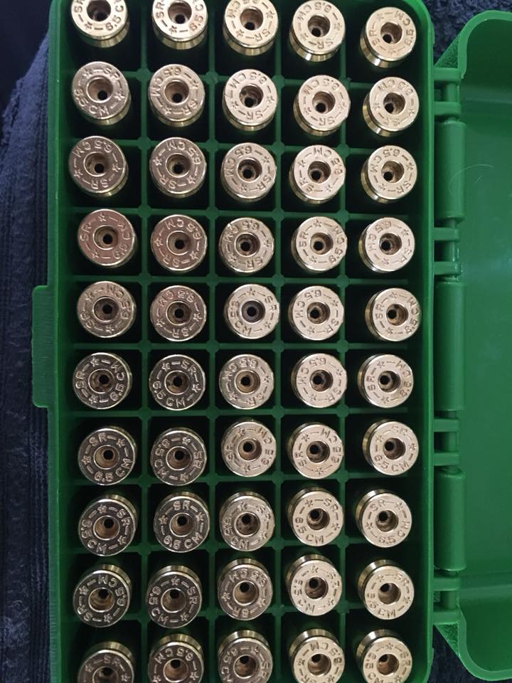

Si use the Lyman cyclone but for the amount of brass you will be cleaning it’s to big ,, a load for me is 200 creedmoor and 500 9mm , I would recommend the 3kg one from eBay for 100 cases
My mix
Squirt of simple green (bunnings)
Squirt of morning fresh (supermarket)
And the trick to making it shine
1 tablespoon of cream of tartar ( supermarket)

Post by Member-Deleted » 27 Sep 2018, 12:28 am
Yeah they look nice and clean eddahenry
