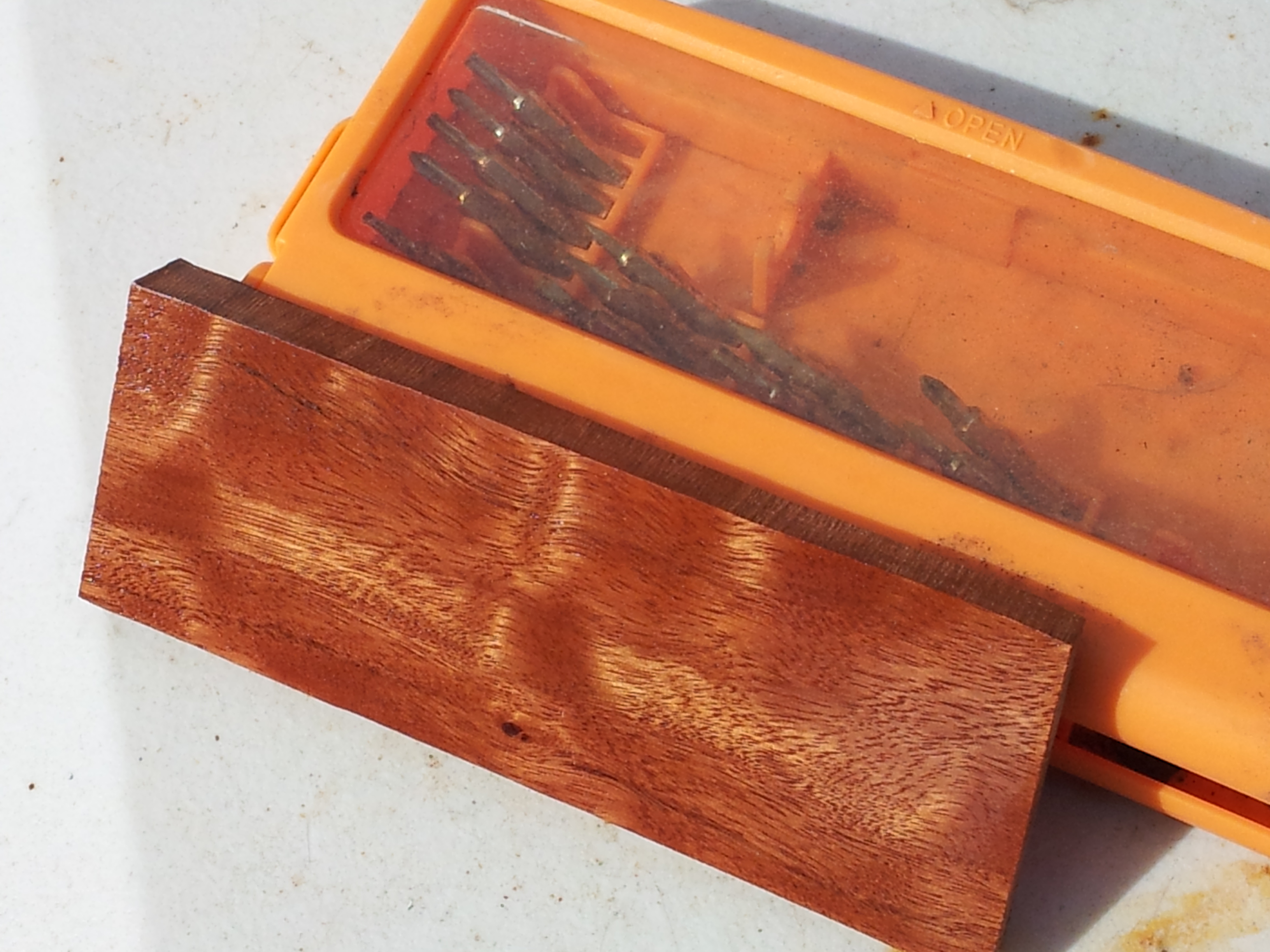

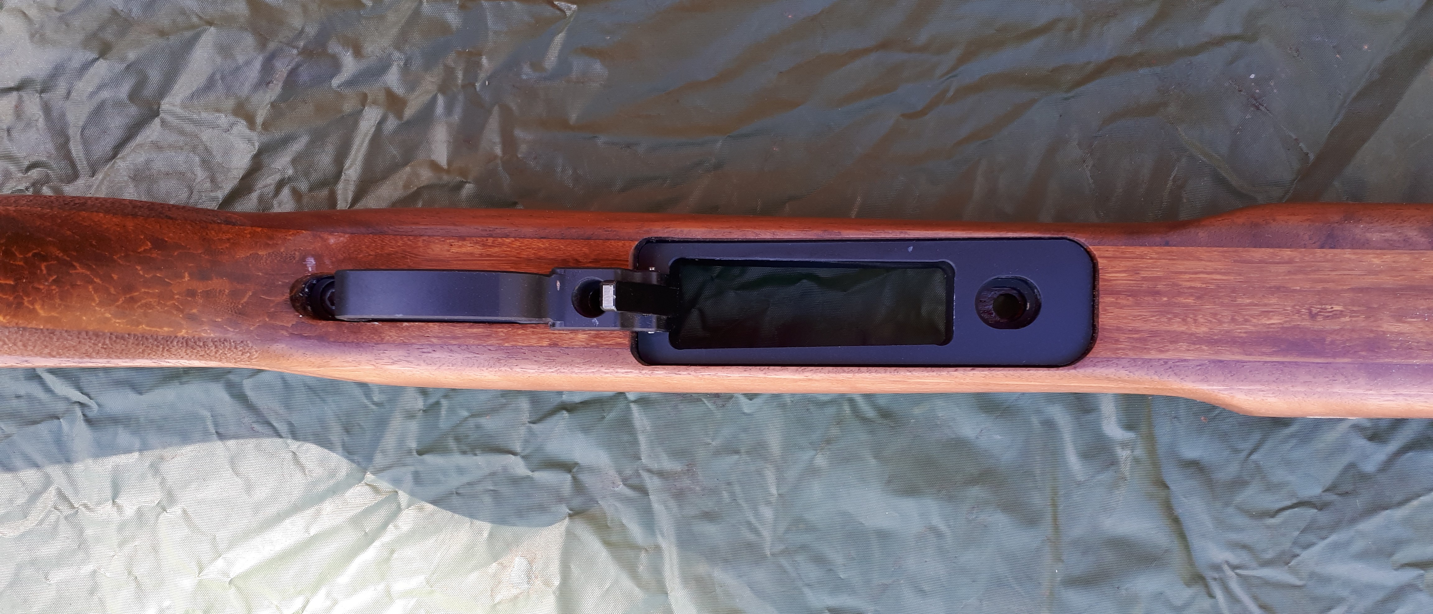

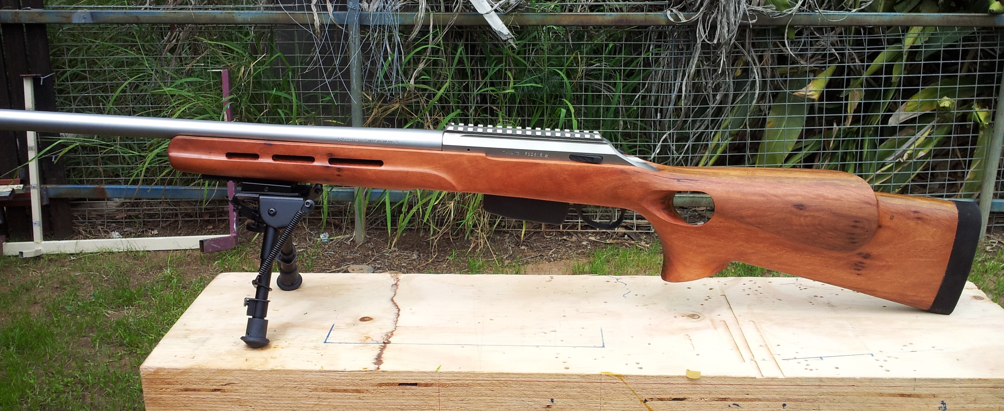

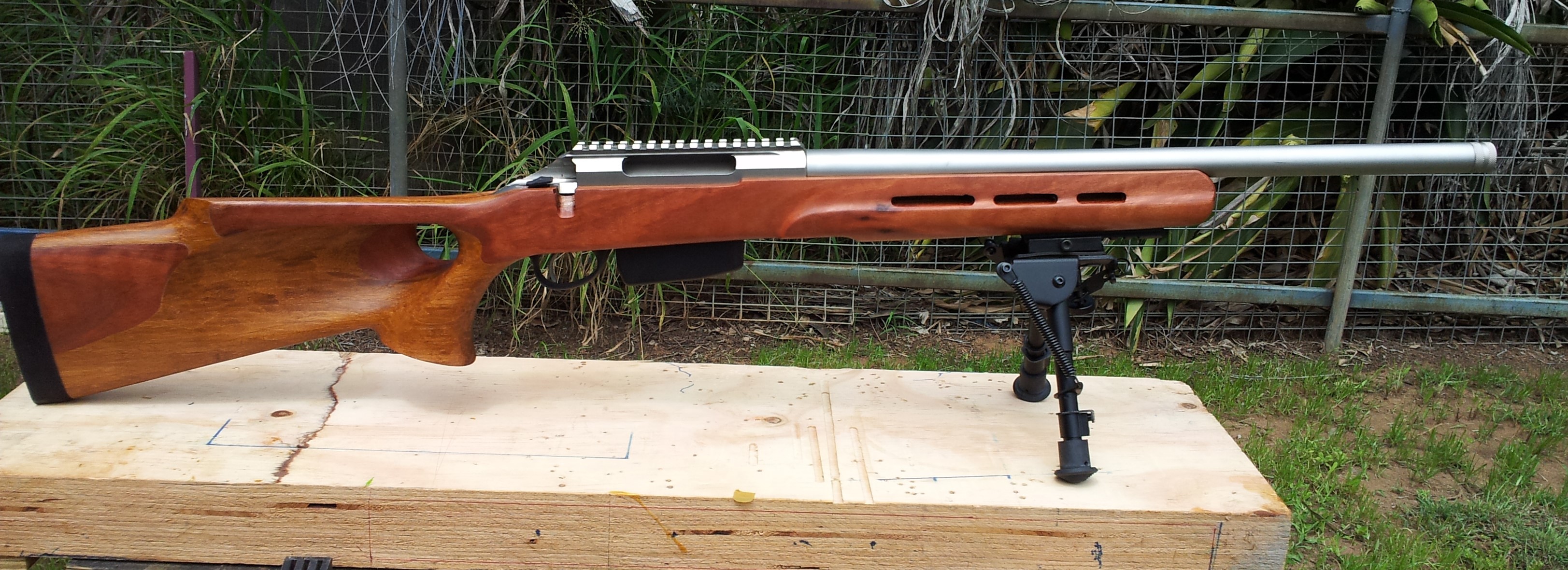

An opion for your gidgee would be to laminate pieces as a "skin" on the outside of another type of timber.
Blue gum salvaged from 1890's miners cottage;
Not quarter sawn, so didn't have much in the way of grain, but did have some nice fiddleback (a bit hard to see in photos of stock)

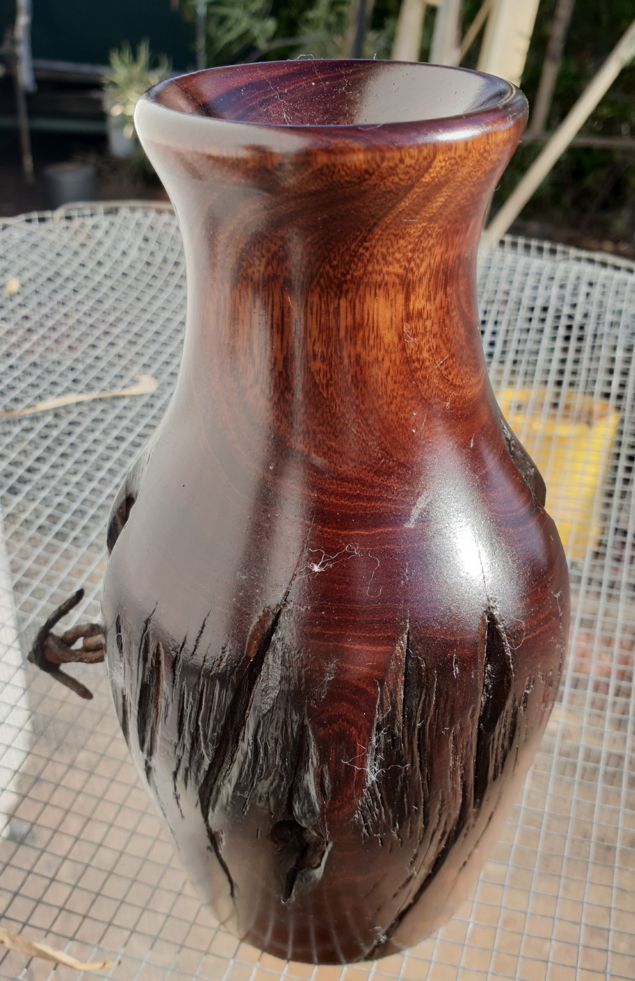

Die Judicii,
Attached is another possible option for your stock; called Boree.
Cousin of the Gidyea(another Acacia), but slightly easier to work. We used to often use Boree through the 'Donkey' Hot Water System, as it burns slightly cooler than Gidyea, but easier to chop fallen trees up. Boree tend to grow into bigger trees than gidyea in the same soil, but often out-grow their roots, and get toppled in big storms(or split in half). It's quite a heavy,dense wood, though. Still not quite as hard as Gidyea, but still harder than most woods I've seen stocks made from!
Not sure what it's like for splitting; I expect if you kept the stock well-oiled, I dont think it'd be a huge problem. This vase was bought as-is some 20 years back, from a bloke at Blackall, who was making them from old fence posts. I simply cleaned it and oiled it, and I'm not seeing a lot of signs that it's split badly in the mean-time.
Food for thought, at any rate. The heart-wood has a nice dark grain in it.
Cheers,
Rod.
Cheers,
Rod.
Boree Fencepost turned into vase.
