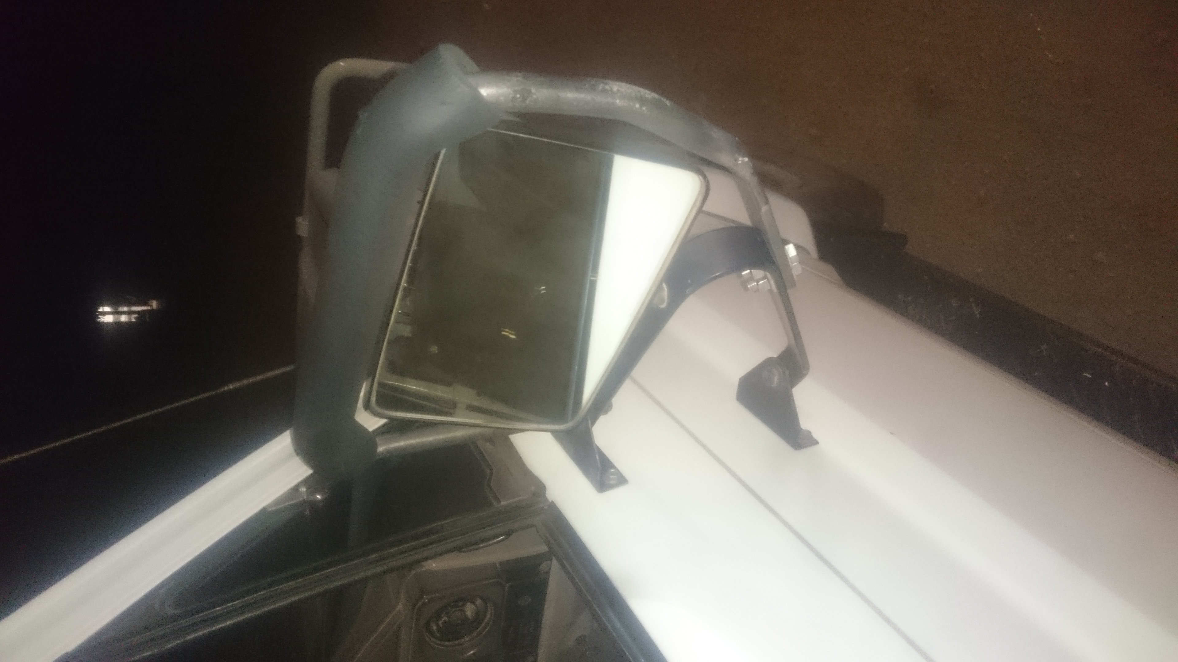

Post by bigfellascott » 02 Jun 2019, 2:03 am
Pool Noodle on the window works ok, as does this

Post by marksman » 02 Jun 2019, 8:46 am
I have a setup like roo farmer's and it is very good and steady :thumbsup:
but scott I've never seen your setup, amazing :drinks:

Post by Stix » 02 Jun 2019, 2:55 pm
Far out bigfella.. :wtf:
Swinging from lashed straps... :huh:
Bit of spotlighting bondage goin on in your paddocks... :shock:
But seriously, that would drive me nuts i rekon...there'd be no quickly jumping out for a shot over the bonnet with that set up...

Re: Spotlighting rest
Post by bigfellascott » 02 Jun 2019, 3:25 pm
marksman wrote:I have a setup like roo farmer's and it is very good and steady :thumbsup:
Just something I whipped up after I had trouble with a standard window rest (I used a leather belt and it worked exceptionally well) so made that one up with a bit of adjustment in it. It's good enough for poking heads at 200m so plenty good enough for spotlighting duty :drinks:
Post by bigfellascott » 02 Jun 2019, 3:29 pm
Stix wrote:Far out bigfella.. :wtf:
But i guess if it works for ya... :thumbsup:
The strap just slips over the spiggot (you can see it in one of the pics) so you just pull you rifle in like you normally would and slip the strap off, nothing hard or slow about it at all, it allows you the freedom to shoot in any direction you need (they used a similar sort of setup in the gunships in Vietnam wtih M60's hanging off em. :drinks:

Post by bigfellascott » 02 Jun 2019, 6:54 pm
Here's a system I use when out shooting on my own - I can shoot out the passenger window (I don't shoot out the drivers side much as I can't get comfortable shooting that way so this system works fine for my needs.
Post by Cal-ApeR » 02 Jun 2019, 10:47 pm
The strap method has really got me thinking. That is brilliant. Yeah, my mate is a skirt but I understand sort of. $65,000 and then getting it all scratched up. That's why I still drive an old Hilux that doesn't mind a flogging.
