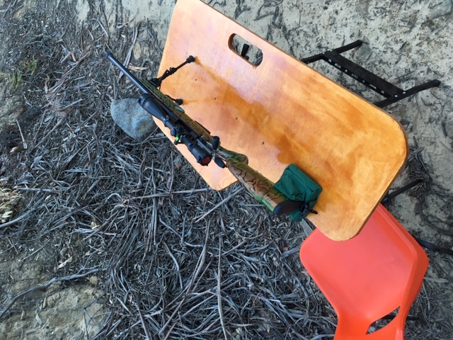

Post by TassieTiger » 24 Jun 2019, 4:16 pm
My effort...
Re: Portable shooting bench
Post by Oldbloke » 24 Jun 2019, 5:52 pm
Looks great tassie
Posts: 13252
Post by GQshayne » 24 Jun 2019, 7:30 pm
TassieTiger wrote:Take the top off and mine assembles very flat. I put a 4x3 pine down the middle of my top, then clamp vice onto 4x3.
But to me - it’s very low as is...makes you hunch over and puts the butt on to the top of your shoulder which after a few shots hurts on recoiling firearms.
If your over 6 foot 2 - legs need to be extended...or top somehow lifted.
Yep, that is what I figured. 4 bolts and it is easier to transport. No problem when it is only used occasionally.
What are you sitting on????? I am 5'10" or thereabouts, and I reckon a milk crate with a cushion etc on it is about spot-on. A bit of leeway there obviously. Not tall enough for a normal chair though.
Extra sand bag under the rifle would help too, depending on what you have.
EDIT: Just saw your photo. Normal chair will be hard to use, and my rifle is a bit higher on bags than yours too. I reckon a mechanics stool would be perfect. No back rest to get in the way, and adjust up and down as needed.
