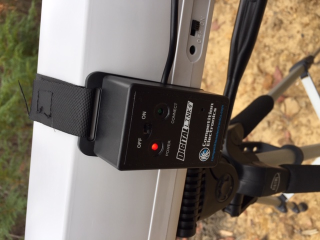

So after borrowing my mates caldwell chrono for some time, I decided to buy one myself. After looking around, I came across an apparent US made unit on eBay called pro chrono.
It was cheap and I guess looked a little nasty, at a couple hundred dips, but what intrigued me was the direct link blue tooth option.
The direct link remote option, came with an app that looked to be quite useful, so I pulled the trigger - $270 delivered for chrono and linking tool.
So 2nd shot - face plate came off and I’m thinking...oh great...what a piece of crap...but then I linked up and wow.
Not only does it now voice call the shot and feet per second, it references different data from various strings, charts ballistics if you enter the data properly, etc...
It literally has your phone saying via Siri’s voice - that shot 2980 feet per second”.
150 shots later - hasn’t missed a beat. Does need additional batteries for direct link unit.
Saves taking pad / pen and for the price, half decent with app. Seller is a farmer in WA and has limited no’s.

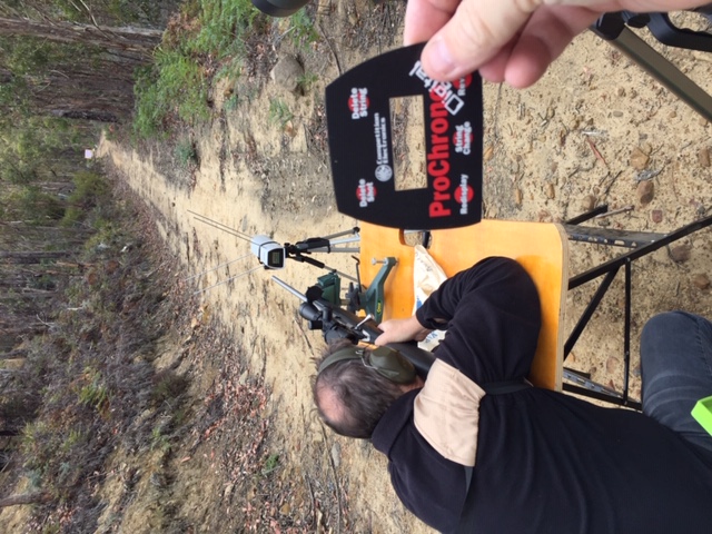

Pic is a friend shooting 168’s in 300wm tika.
