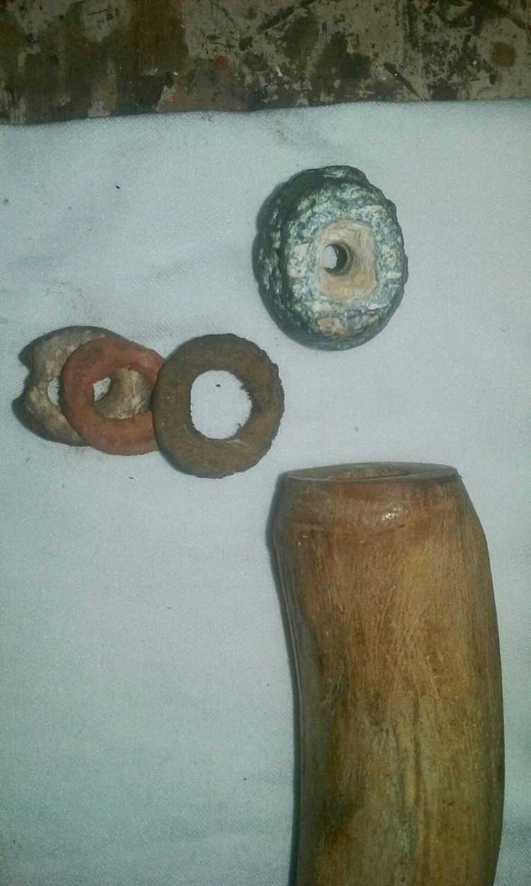

6. What do I do about the rear bolster that is pitted? Id like to have a nice shinny (brass/ silver nickel ??) one but it would need to be able to screw onto the tang - so thread it, or somehow get a brass nut inside it.

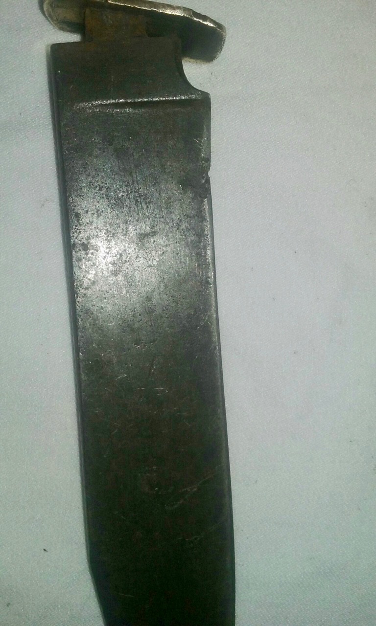

Small nick in base of blade, and blade and blade discolor.

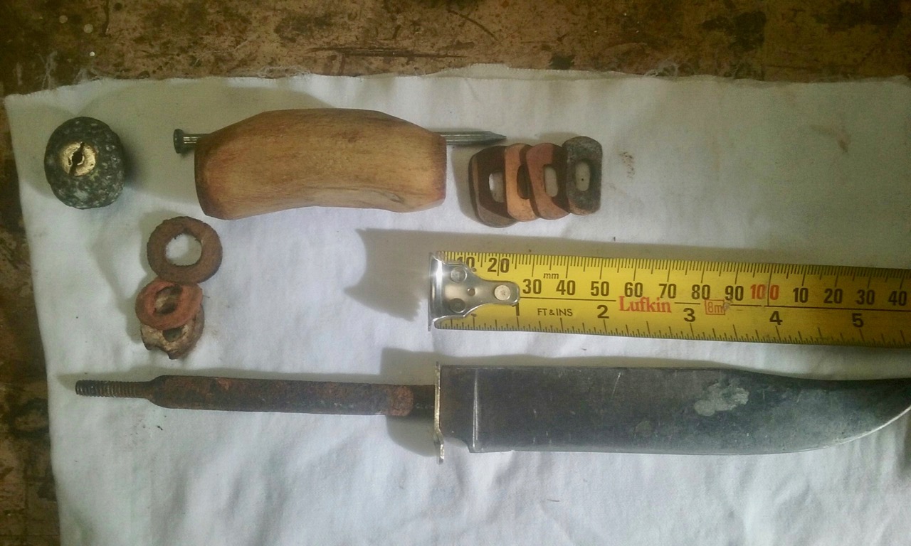

Thread end of tang also showing rust.
Pitted underside of rear bolster.

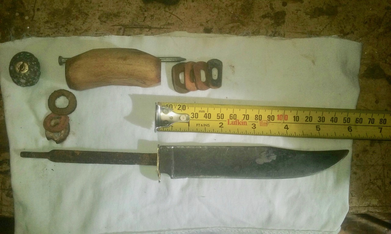

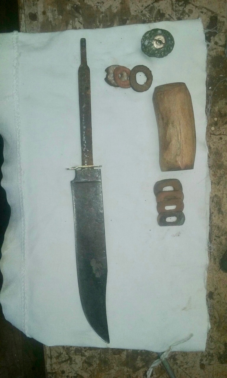

The knife and parts L-R ,T-B: rear bolster, bone handle front washers, rear washers, knife with hidden threaded tang.

Don't use a wire wheel. Soak the tang in vinegar. Then use fine steel wool or something similar to clean the rust off. The blade if you want shiny you should rub back with various grades of wet and dry sandpaper as fine as you can go. I'd put the pommel back on AND epoxy the tang

You might have to live with the nick closer to the handle, you could file the heel of the blade so it's not so pronounced but without knowing how far the hardened area goes up towards the spine of the blade you could be sacrificing too much of the hardened steel leaving the heel of the blade too soft.
