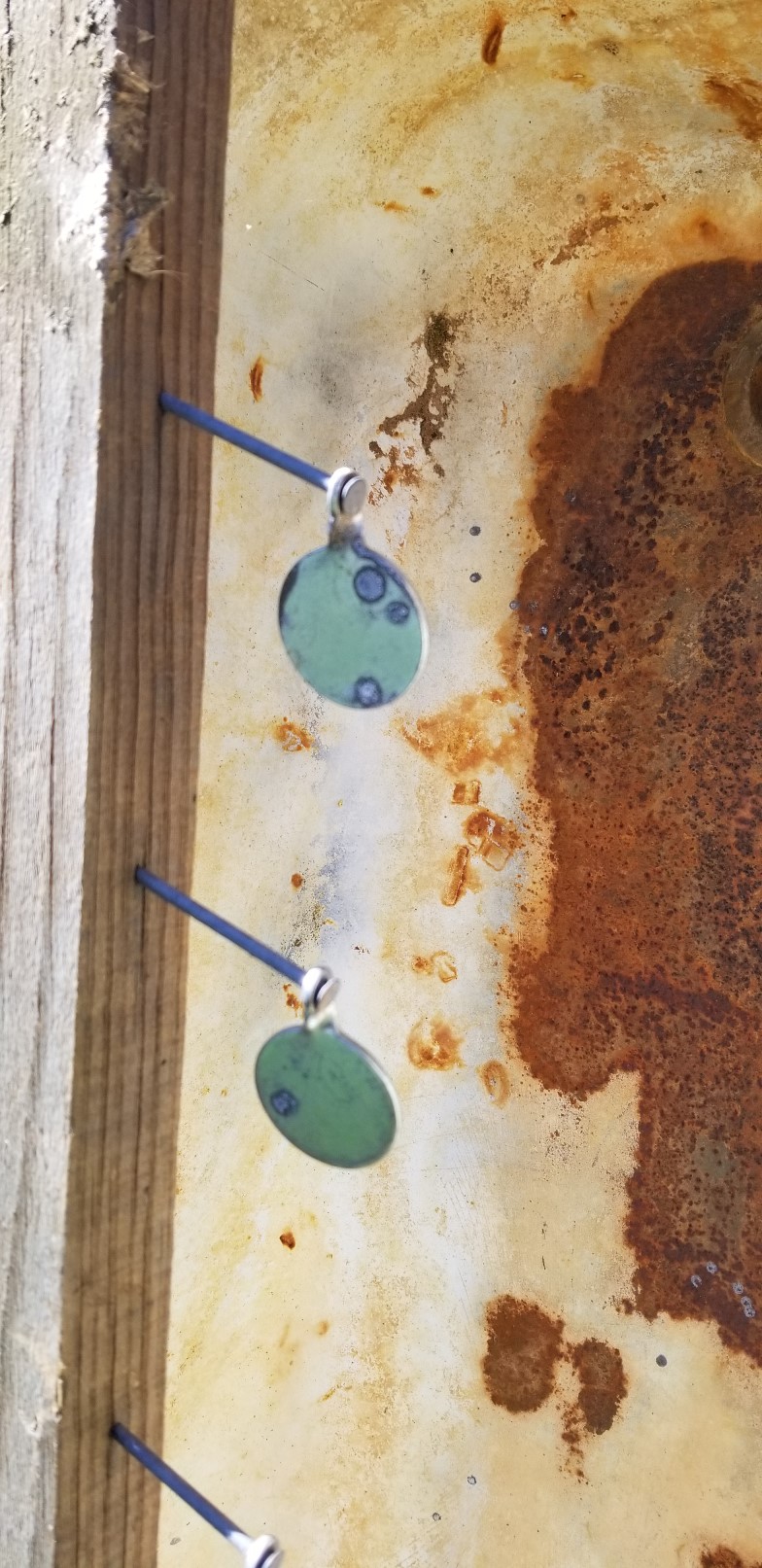

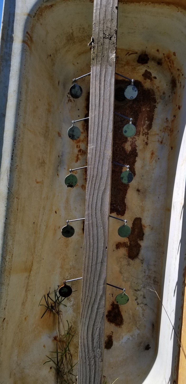

Post by bladeracer » 10 Sep 2020, 12:57 pm
Posts: 14016

Up to now I've just been fixing a piece of cardboard to the front with stick on reactive "splatter" targets. though seeing blade racer's duelling tree type set up I might have to install one.
