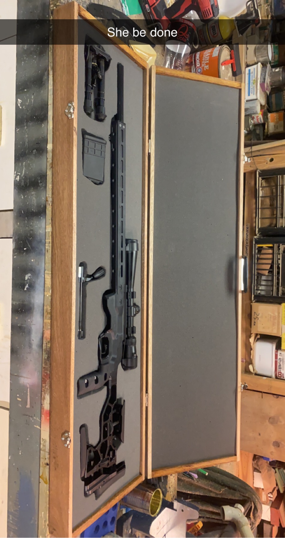

Years ago I made a guitar gun case and custom cut a piece of foam from Clark rubber.
I used 3 layers of foam. 2 cut to suit the case for top and bottom and one cut to shape for the rifle as middle.
I traced out the design and cut it with a long blade. I've since learned that bread knives cut foam really well.
Once cut the 3 pieces we're glued into place with contact adhesive.
Finally a piece of velvet was tailored and glued inside.
It came up mint

Son has built a could of gun cases. He has the foam cut to size and delivered from Clark rubber and uses a box cutter to cut out shape
