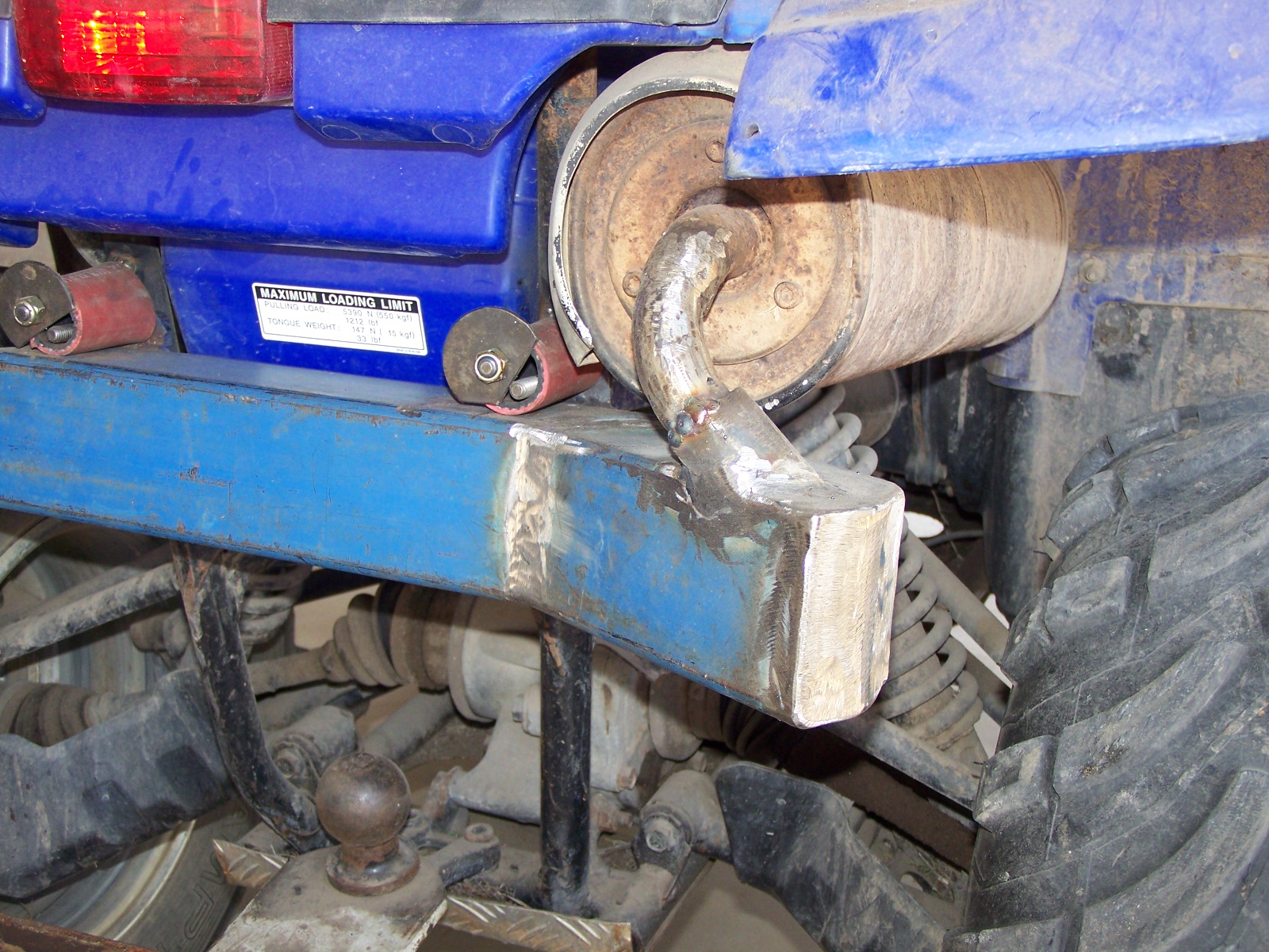

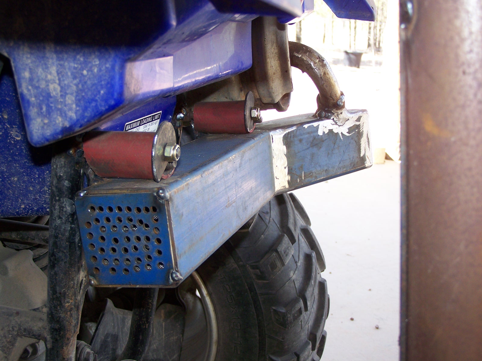

Post by Die Judicii » 13 Apr 2021, 6:48 pm
I made my own 2nd muffler as per pics,, and added it to the existing one.
It is packed from one end to the other with fine stainless steel mesh, that is folded zig zag fashion and slid/pushed into the RHS.
Being a 650 yamaha Grizzly it originally had quite a thumping sound to it,,, but now is much quieter.
Added benefit is definitely no chance of a spark to start a bushfire anymore.

Post by Blr243 » 13 Apr 2021, 7:05 pm
Dj. Steel rhs 75 by 75. 89 by 89. Or 100 by 100 ?
Posts: 4813
Re: Making my 4 wheeler quieter
Post by Die Judicii » 13 Apr 2021, 7:32 pm
Blr243 wrote:Dj. Steel rhs 75 by 75. 89 by 89. Or 100 by 100 ?
Doesn't really matter what size Mate.
Whatever you can get hold of,,,, and find room for it to fit etc.
The bigger and longer, and number of baffles or (folds) the better.
I think by memory I squeezed about 4 or 5 meters of mesh into the RHS.
Posts: 4450

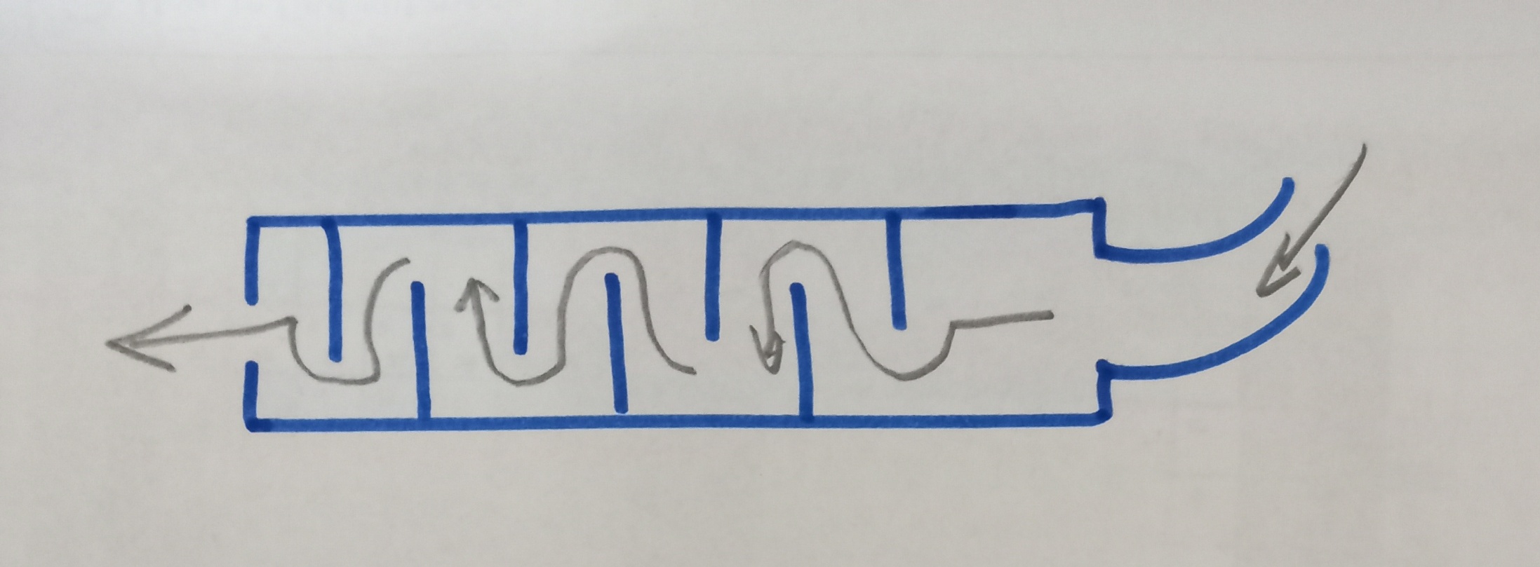

Post by Oldbloke » 13 Apr 2021, 8:22 pm
The idea is to:
Cool & slow down the exhaust
Giving it a box to expand in and forcing it to change direction helps to achieve that. Baffles force it to change direction, therefore slow down.
Posts: 13252
Post by Oldbloke » 13 Apr 2021, 8:28 pm
You get the idea.
