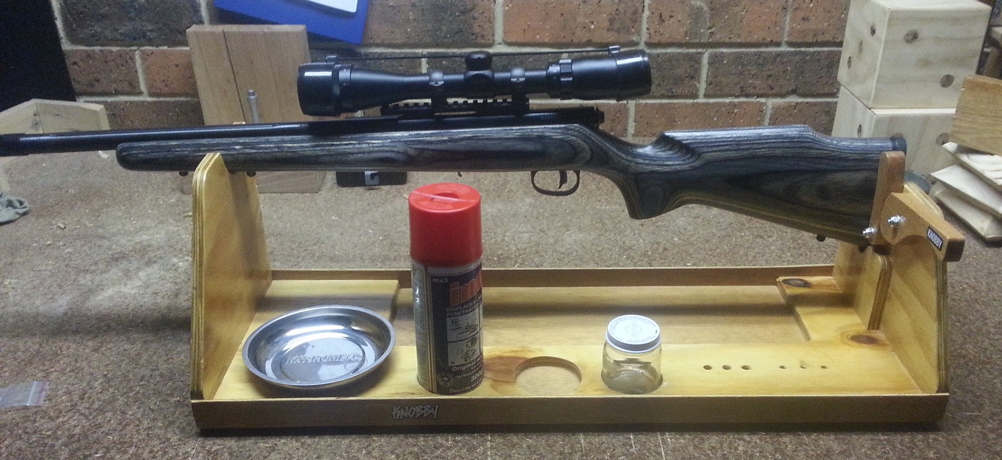

I'm a big fan of making stuff myself, so I thought I'd put up some pics of the gun stand/vice/workstation I built a few years back out of some scrap plywood. I originally made this as an exercise to practice using some drafting software and to have a try at some woodwork - after all, you can't say you've successfully designed something until you've made a prototype! The upside is I have a full set of pdf drawings free on my dropbox if anyone else wants to have a crack making one: https://www.dropbox.com/s/nsxfc8uqqbr4y ... 0Stand.pdf
Some of the features:
a clamp to hold the butt so the rifle doesn't move
a recessed tray to hold general tools and parts
holes for jags and brushes of different calibres
cutouts to locate my magnetic parts tray, a couple of spray cans and my solvent jar
rubber feet to stop the whole thing sliding around when using a cleaning rod
Pics:

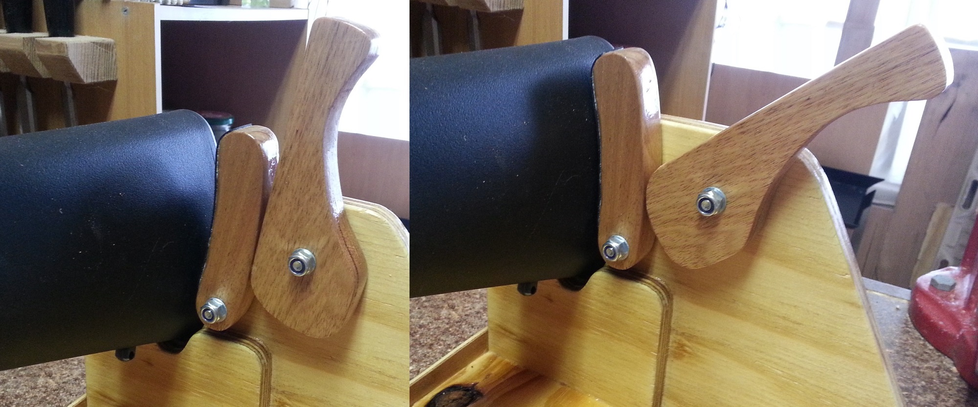

The clamp setup open and closed.

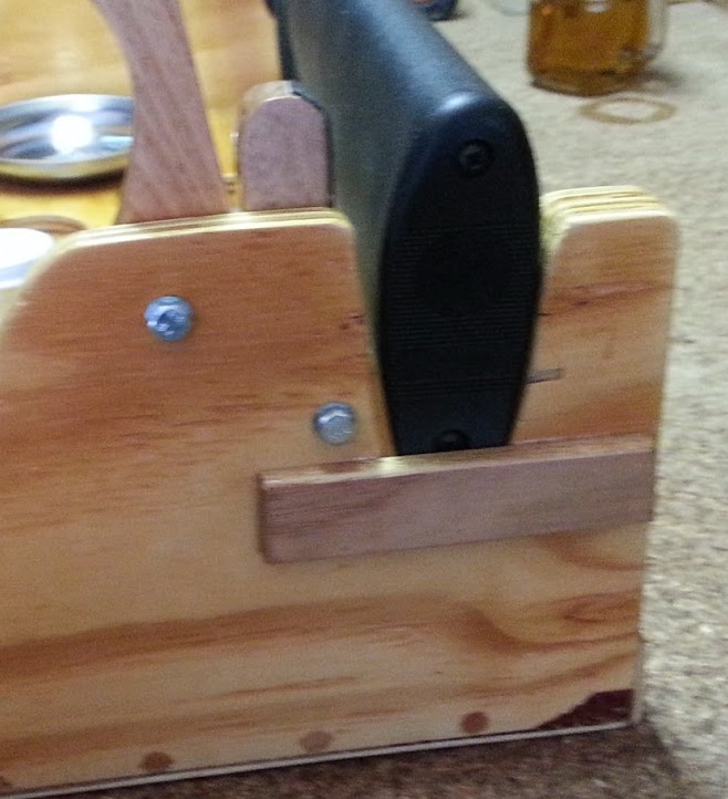

A couple of points if you actually want to make one:
the bottom and side strips i made from 3mm ply not 19mm.
if I was going to do it again, I wouldn't make the recess go all the way to the edge to give the 3mm ply something stronger to attach to
I had to add a block of wood to help locate the butt to help stop it sliding out the back.

I like your stand, especially the cam lever that locks the stock in place, a simple but ingenious design :thumbsup:

Yeh, well made, smart design.

Cheers, it was inspired by a similar design by on from an american company (MTM I think?) but I didn't want to pay the 'aussie tax' for a cheapy plastic one.
