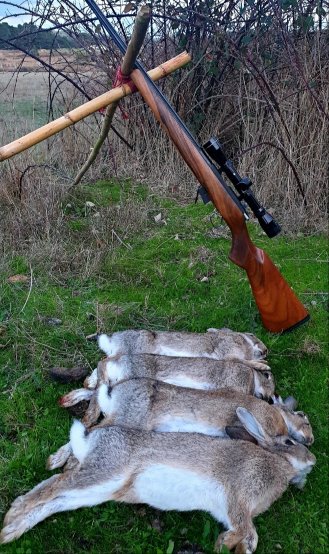

I've made my own before just by tying a couple of bamboo poles together.

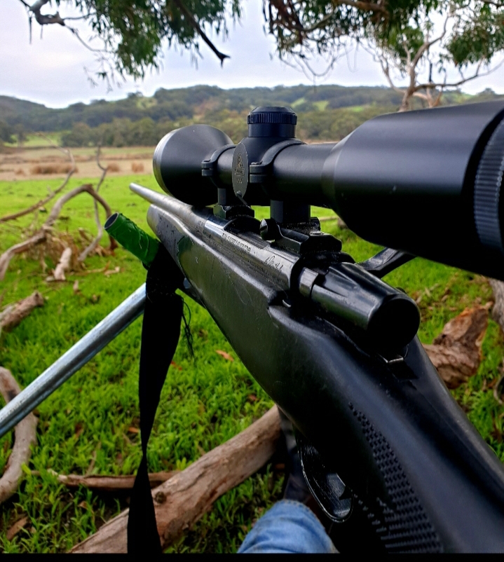

Later I made another set using adjustable tent poles bolted together near the top. Both worked well,the tent pole ones were fairly heavy though.

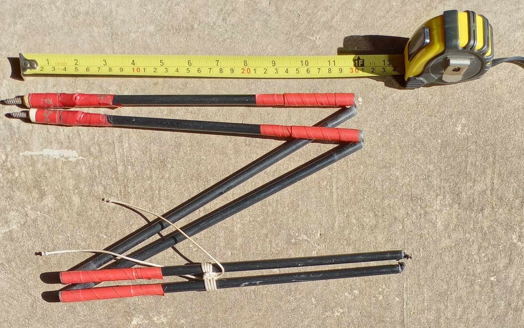

Yep, I use them. Some like em, some don't. A great rest and very light weight. I don't like the idea of anything attached to the forend such as bipods. Can be a bit cumbersome if something like a fox arrives from the wrong direction. But I guess that's life.

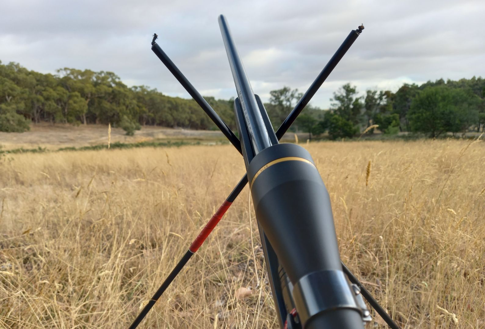

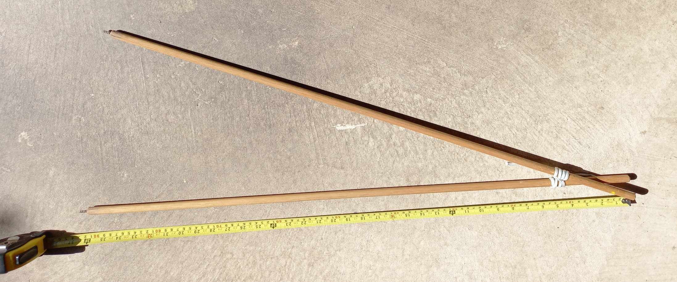

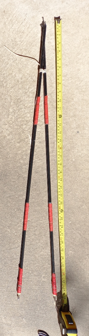

Posting a pic of basic stix made of 12mm dowel. 900mm long. This length works for me just sitting on the ground with a piece of foam under my arse. Lol. Also a folding set. Made from one of those tent poles with Elastic inside. Just folds up and fits in my bag nicely.
I use a knot to tie them and posting a youtube link on how to do the knot. There are plenty of other options but that's what I use.
I have a longer set made out of aluminium tube off an old TV arial about 1400mm I think for if I use a small stool.

These are my bamboo shooting sticks

My tent pole shooting sticks

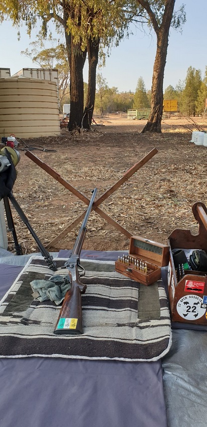

200m setup.jpg (187.85 KiB) Viewed 5477 times
Yep, use them a lot for black-powder silhouette and long range, ( out to 1000m) . Mine are home made from a couple of pieces of 1 & 1/4 x 3/4 " hardwood and have a bolt through them for use on ranges. They can be set up for prone or sitting position by simply moving the bolt. I have used a long set for standing, they also worked well. I don't carry them in the field but they can be made from very light timber and still be quite stable. They provide vertical stability.
