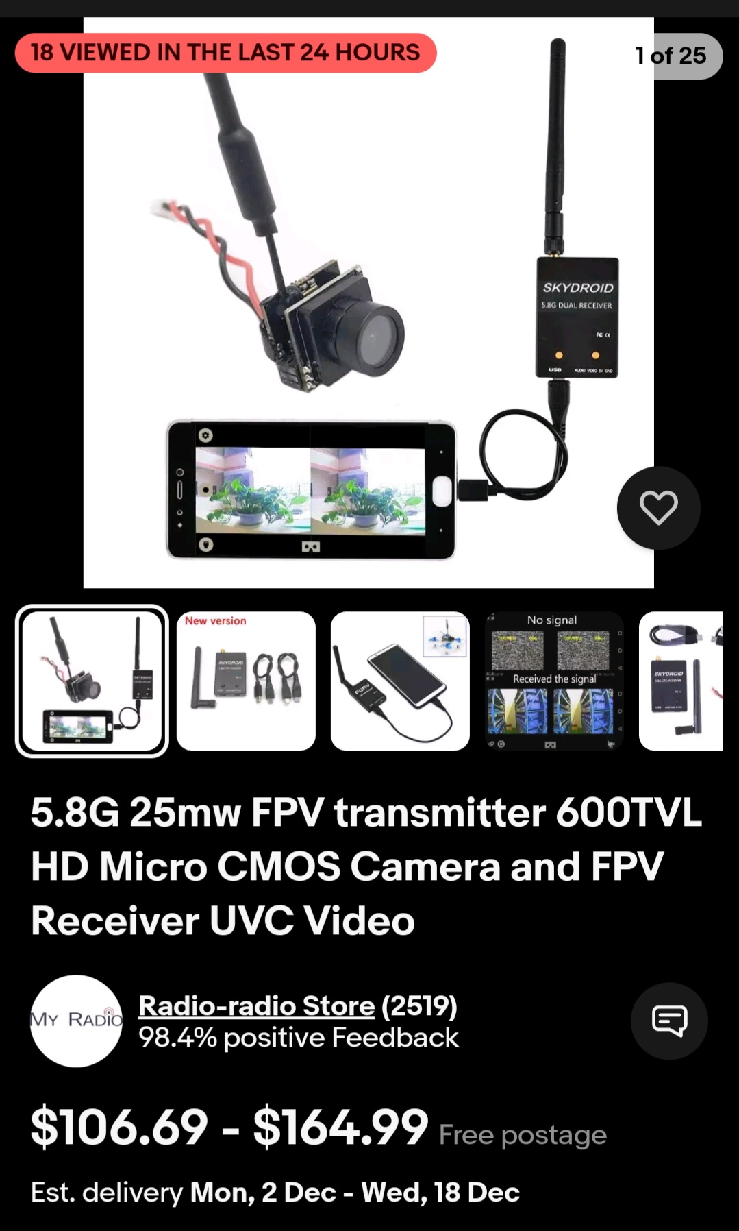

Post by on_one_wheel » 19 Nov 2024, 4:31 pm
Claimed range is 1200m
However, for the same price you could buy a cheap 60x spotting scope.
Posts: 3908

Post by Fester » 19 Nov 2024, 6:57 pm
Cheers Wheely
Will look into that camera
I have more chance of seeing .22 cal holes at 300 with my biggest rifle scope than any cheap spotting scope.

Post by straightshooter » 20 Nov 2024, 6:56 am
No matter which way you go you will still need fancy optics to get the resolution you want at 300 meters and 22 cal holes.
It can help if you increase the contrast and visibility of the holes by stapling a black backer such as a garbage bag to your target frame and having the aiming marks on the target in red.

Post by Fester » 20 Nov 2024, 7:48 am
Right, when reading about that signal transmitting unit posted above, it may be not suited the high-resolution.
At first, I thought I would just need to source a decent enough camera.
I also thought that a camera placed up near the target would eliminate needing real good stuff to see the 22 cal holes or at least where the group is centered on the target.
