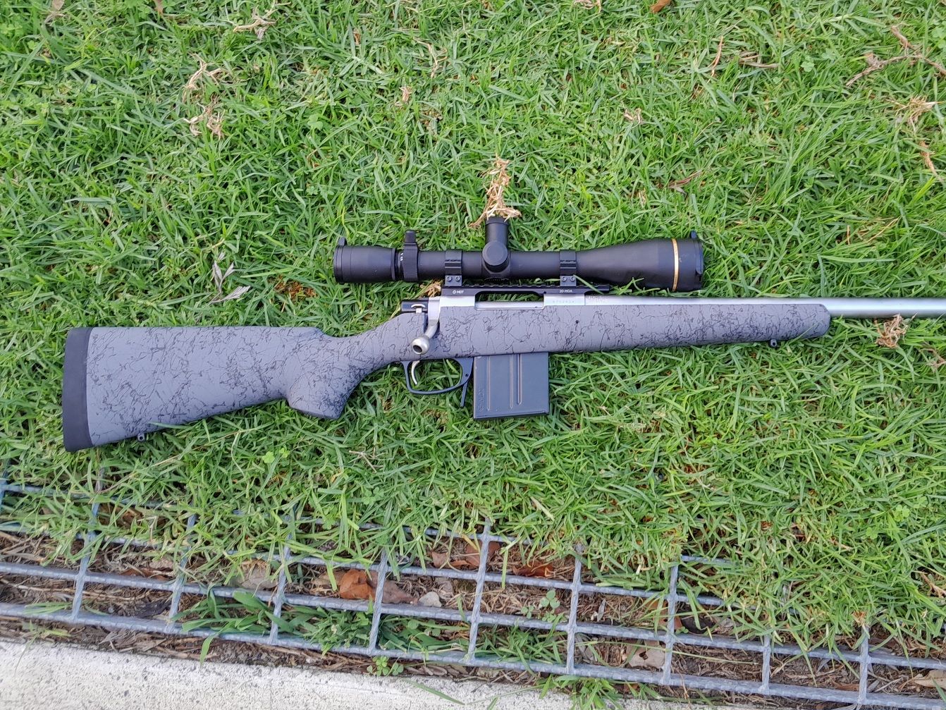

Post by Wapiti » 10 Dec 2024, 5:40 pm
A pic of how it turned out. For us, we couldn't get a better handling vehicle gun. It's a 24" varmint barrel.
The scope's too big for night and practical field use, it's a 6.5-20 VX3HD. But I didn't have a 4.5-14x when I screwed it together.

Post by dirtjay » 11 Dec 2024, 7:21 am
Thats great news, I was pretty sure it would all fit together fine.
Its always a gamble until you get it all assembled - but well done mate, it looks fantastic, and sounds like the fit will give you confidence when needed.
I prefer the MDT double stack mags after a few hot days when the poly mags became a problem - each to their own though.
And I like the mag release at the back of the mag also. I did shorten the release lever on one, and changed out for the double sided short on another Howa.
You just reminded me, I need to blue-loctite my gear this weekend !
So good to see these Howas getting matched with quality products and doing the job so easily
