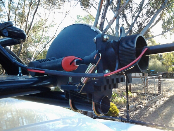

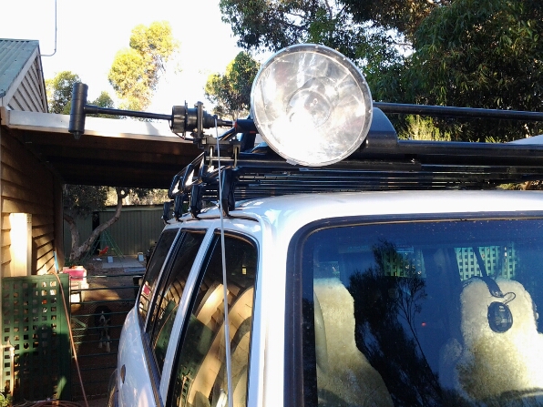

Post by on_one_wheel » 20 Dec 2014, 7:08 pm
I had the same problem but I put it down to not having three arms, its blody hard to hold the light and shoot at the same time.
My soulition was a lightforce bracket, swivel and a home made detachable pole.
It folds down so you can open the door and is adjustable for tightness on the pivot.
I chopped the original wiring off and replaced it with some very heavy stuff to give me minimal voltave drop over the length of wire.
thats got the light sorted but I still struggle to get my eye over the scope when I'm hanging out the window.

I have a set up very similar to one wheels and can hunt to the we late hours of the night no problems!!!! I turn the car to the right position to take the shot? Works well for me

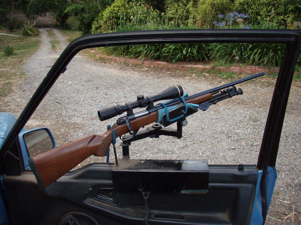

Post by Bills Shed » 24 Jan 2015, 8:25 am
At the end of the day if it works for you, all the better. I have made many prototypes of walkaround,one person shooting rigs. Most were pretty average. Lead acid batteries, cables and barrel mounted heavy spotlights. As a kid there was not the choice- none- of what there is now with LED scope mounted lights and long life batteries. We are spoilt but I love the techknowlogy!!
When I got a vehicle licence; a vehicle mounted set up was the next problem to solve. I am a lefty and so driver side shooting is easy and natural.
I have had the privilage of seeing how machine guns are mounted to helicopters and how they manage to get then in and out the small windows for the load masters. With that in mind I set about building a triple articulated gun mount that could be operated with one hand was able to support the rifle when not in use, and not stick out the window to far while driving in close country. After several prototypes I came up with this mount for my paddock beast. The rifle is shown in the stowed position and when the door is closed the rifle is almost pointing backward and the rifle butt is next to the right hand side of the dash board. The door bracket has the standard support arm on the outside that sits against the bottom of the door to support the weight of the over hanging rifle and mount. It only take a second to lift the pistol grip out of its bracket and swing the rifle to bear. The other hand can operate the roof mounted light mounted over the drivers door if need be.
Rifle mount 2.jpg (169 KiB) Viewed 13070 times

It's a great concept Bill . The only thing that worries me is the potential to wipe the gun out on a tree limb or scrub as you drive past . Don't get me wrong , I am loving the idea and have thought about similar . In open country when you are driving your own truck it would be no problem .
How does the gun shoot locked in like that with restricted recoil tracking ?

Not to sure what you mean by restricted recoil. The rifle recoils normaly as the piviots are not fixed and are free to rotate as the rifle / gun mount moves. Recoil is still absorbed by the shoulder. Tracking is easy as all piviots are greased and swinging the rifle with one hand is effortless. It is a rock steady mount. The main draw back is engine vibration. The ignition key fixes that for the 150m+ shots. Recoil is very low as I mainly fit the 17 Hornet to the mount. There is not much that little calibre can not handle in Tas! I do not chase deer.
As for getting wiped out by a tree limb; while driving the butt is next to the right hand side of the dash board, inside the vehicle, and the barrel is only about 75 mm out side the window. The scope and action are about level with the window slit. You will wipe out you side mirror before you hit the rifle. If I am in that close country I should be using a shotgun. :drinks:

Post by cruze82 » 24 Jan 2015, 9:50 am
great design bills shed I might have to look into copying this one
we shoot in a lot of very open country so this would be perfect

No dramas. Put the money on the fridge to cover the copyright. :drinks: Just note that when building it you will have to experiment as to where you put the first pivot point (door mount) as that wil govern where the butt sits in relation to the dash board. When positioning the door mount you need to take into account the interior door handle and opening mechanism. The great advantage of this type of mount is that you do not need to remove the rifle off the mount each time you want to get out of the vehicle. Just clear the action and drop into the pistol grip storage mount. Please note that there are four pivots in order to keep it compact and flexable at all vehicle angles.
