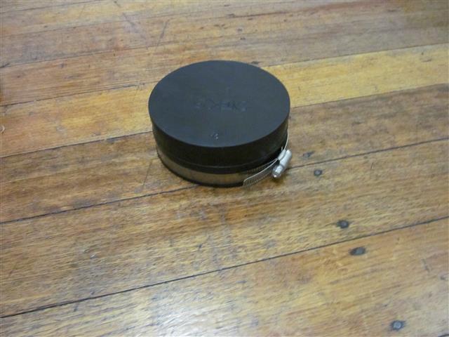

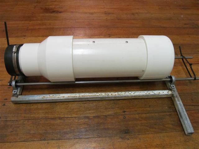

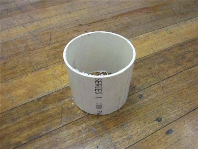

Post by deye243 » 02 Feb 2015, 8:43 pm
Probably a dead giveaway but this is the first pic :lol:

Post by anthillinside » 02 Feb 2015, 8:53 pm
Ummmm.. a Saturn IV rocket :?:

Post by deye243 » 02 Feb 2015, 9:00 pm
another pic
IMG_1729 (Small).JPG (52.49 KiB) Viewed 10796 times
Posts: 2833
Re: Guess what
Post by North East » 02 Feb 2015, 9:03 pm
I give up.

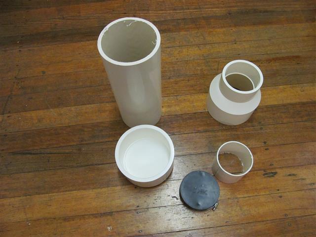

Re: Guess what
Post by deye243 » 02 Feb 2015, 9:09 pm
i was gunna just put up one pic a a time but this should tell ya
IMG_1734 (Small).JPG (50.13 KiB) Viewed 10791 times
Posts: 2833

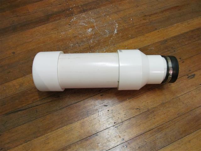

Post by deye243 » 02 Feb 2015, 9:45 pm
on_one_wheel wrote:If it's a penis pump your making, you had better round those edges off !
hahahaha see all that PVC powder on the floor in the pic
http://austargets.com/forum/index.php
ya should get it now this is just the tub the rest comes after i kick the welder in the guts
IMG_1735 (Small).JPG (48.49 KiB) Viewed 10757 times

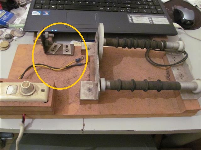

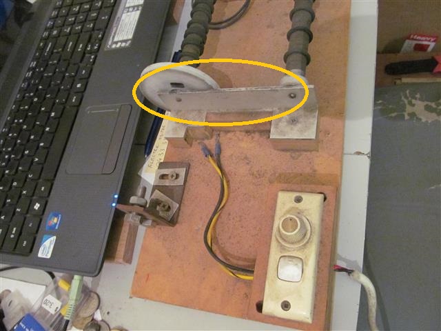

Post by deye243 » 02 Feb 2015, 10:59 pm
this is a couple of pics of a tumbler i built 20 years ago when i was pistol shooting
in the 1st is where the singer sewing machine motor went and the 2nd where the
o ring belt went and the 240V dimmer was the speed controller.

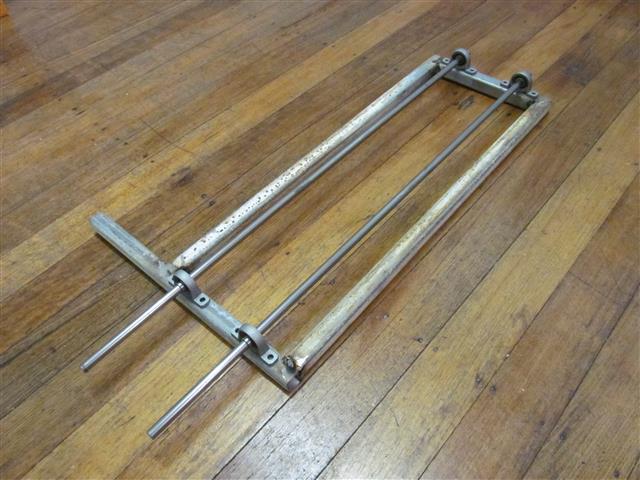

Post by deye243 » 03 Feb 2015, 6:34 pm
i didn't get much done today i have to do more load work on my 6mm but i got the base cut now to find a welder
IMG_1740 (Small).JPG (58.86 KiB) Viewed 11115 times

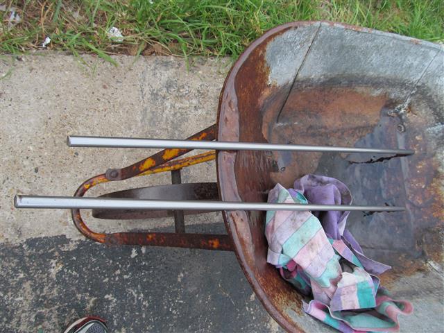

Post by deye243 » 04 Feb 2015, 6:24 pm
now i just have to wait for the motor pulleys and bearings to roll up
12mm Brite steel shaft
IMG_1741 (Small).JPG (75.32 KiB) Viewed 11109 times
Posts: 2833

Post by Wheelbarrow » 05 Feb 2015, 7:06 pm
Looks like you're about to run your laptop over a bandsaw :lol:

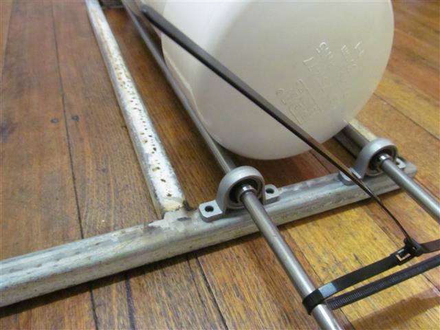

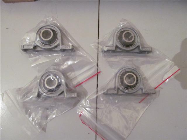

Post by deye243 » 06 Feb 2015, 10:52 pm
now i might get something done this weekend ....... got the agitator in and the bearings turned up as well
IMG_1744 (Small).JPG (45.74 KiB) Viewed 11087 times
IMG_1743 (Small).JPG (36.58 KiB) Viewed 11087 times
Posts: 2833
