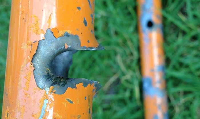

Was using 2 pieces of 1/2" angle iron till last week when I turned it into swiss cheese then broke the weld where it joined. Great timing on the offer mate as I was looking for steel plates earlier in the week and you've saved me a lot of time.
Went looking for plough disks on the farm but none to be found, seems they make excellent BBQ hotplates.
This is from trip before last showing what a 50cal Brass VLD does to plate at 100m. Straight through the steel, then 2 hardwood railway sleepers and kept going.
