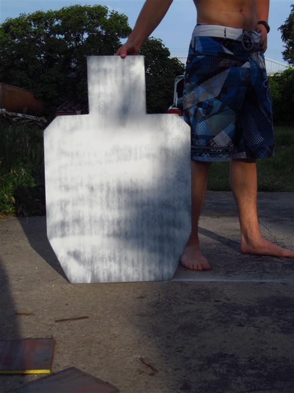

just finished making this ..... it's 10mm plate

Nice target, I'd like a few like that myself once I get some lockup storage organised on my block. Was it plasma cut? How heavy is it?

nope i did it with a 9" angle grinder and AFAIK it would more than 60lb

Thinking you went through a few cutting discs :) Keen to see some pics of hits up close, I'm curious to see how much of a dent there is.

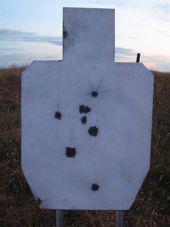

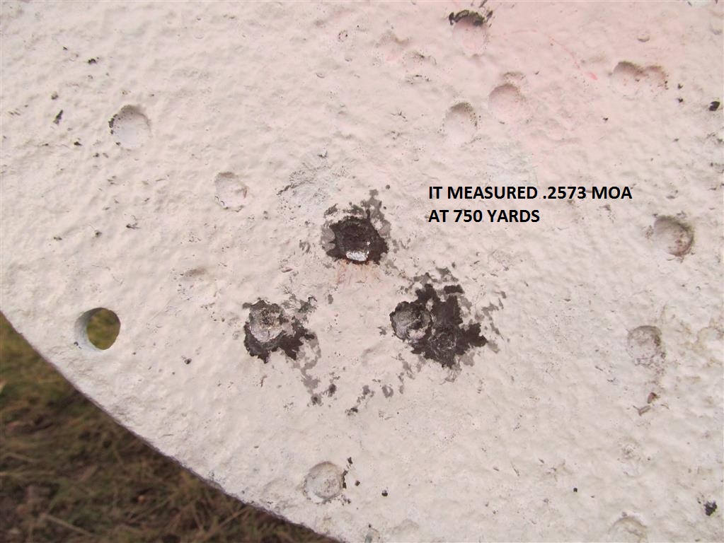

this is at 750y bit of a divit but it will take 2 hits in the same spot but not 3 it's been welded up a couple a times
and the funny thing is that the 162 AMAX doesn't even dent it but the bergers do what is in the pics

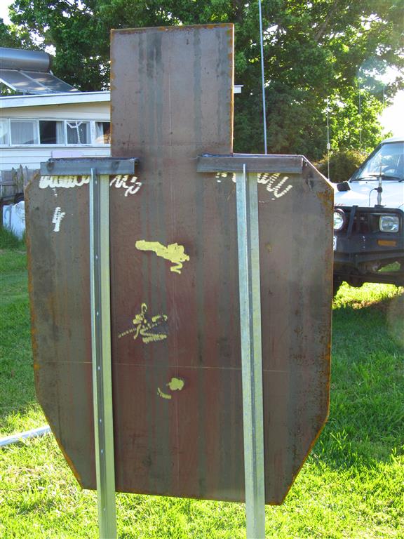

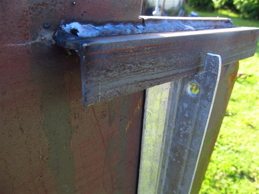

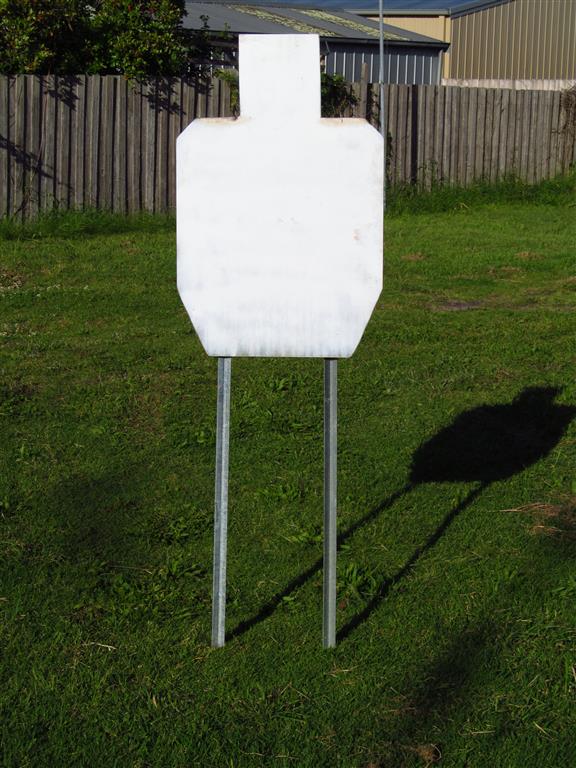

It's been blowing here all day so it got me thinking how am i going to mount this thing in a portable
manner :? so after a while i came up with this :clap: 2 star pickets .
i also made a picket driver as well so now it only takes 5 mins to set up and 20 mins to get the
pickets out of the ground :lol: :lol: :lol: easy and cheap... :thumbsup:
