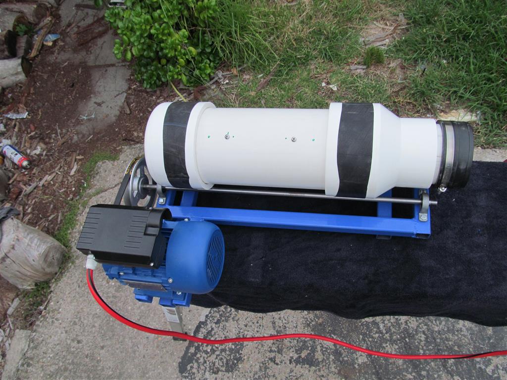

i was gunna make one of them too but then i realized i wanted to do all my brass at one time and made this
IMG_1815 (Medium) (Medium).JPG (325.61 KiB) Viewed 10268 times
IMG_1817 (Medium).JPG (139.08 KiB) Viewed 10268 times
IMG_1822 (Medium).JPG (144.37 KiB) Viewed 10268 times

Holy sheet! Is that for all your brass or all your suburb's brass???

That's awesome Deye! The most I ever get in a batch is about 150-200 cases so any bigger would be overkill for me

She's a beast! :twisted:

Gwion wrote:Holy sheet! Is that for all your brass or all your suburb's brass???
If he's too tired at the end of a big day to wash himself he just jumped in and has a snooze while it goes around for half an hour.
Comes out sparkling clean :lol:
