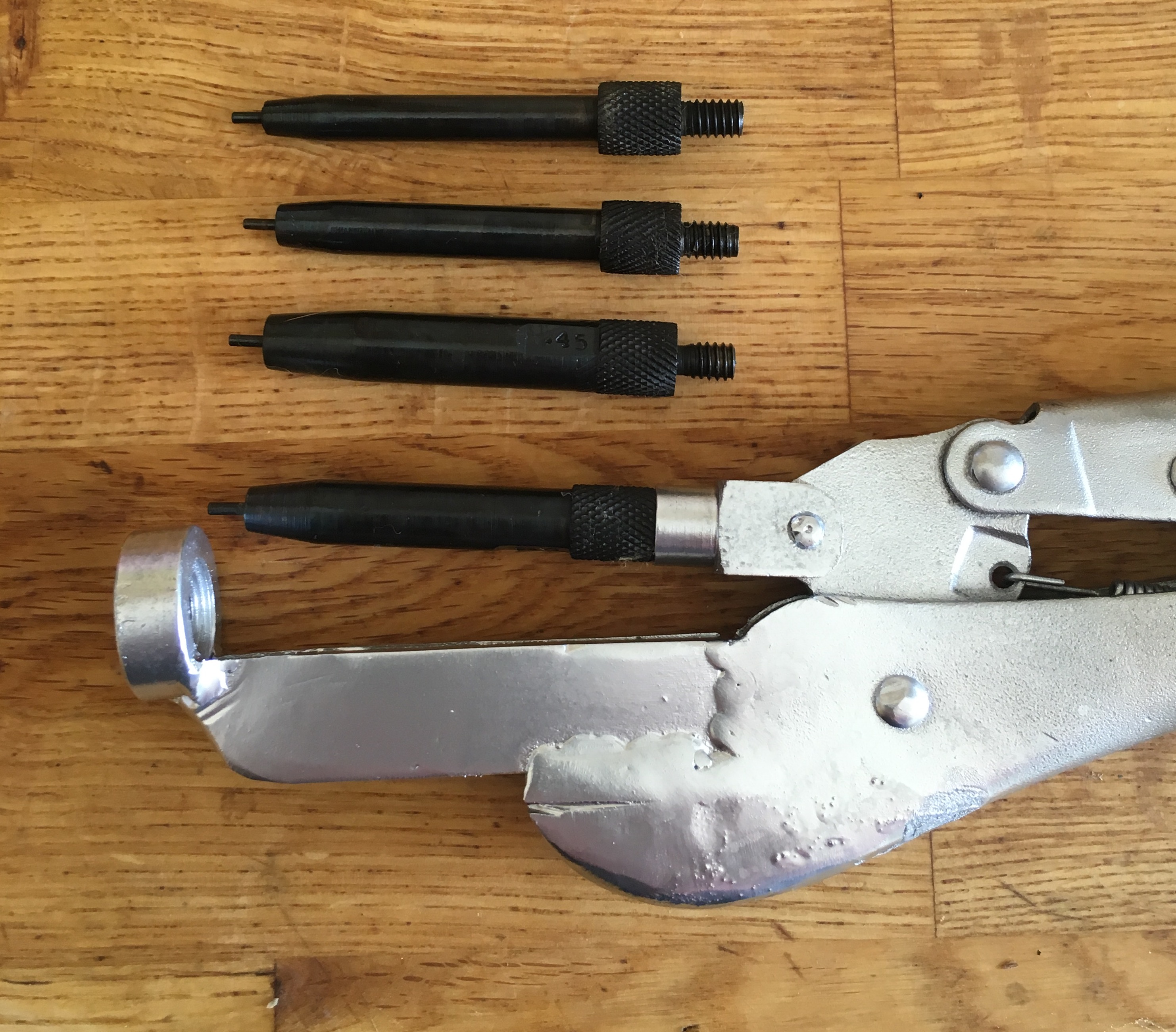

The trouble with using black powder is that EVERYTHING gets dirty including cartridge cases. Before they can be reloaded they have to cleaned and the sooner the better. So, a means of decapping at the range was needed prior to dropping cases in a solution of water, vinegar and detergent so I made this tool out of an old vice grip. The decapping pins are made to fit the cartridges Lady Noisy and I currently use.

Very similar to the one I bought from Frankford Arsenal, very handy little tool.

They look good.
I leave my cases until I get home, the 45/70s I use a Lee universal decapper, the 577/450 and snider cases won't fit the die so I use a decapping pin, a mallet and block of wood with a hole drilled in it and tap them out.
After depriming they get a quick scrub with a wire brush to get rid of the bulk of the crud before a hour in the stainless tumbler.

LN saw the Frankford ones and asked if I could make it and in the blink of an eye another project was on the go. Gotta stop her from looking at catalogues!

My trouble is remembering to actually do when I get home and not forget about it for a week only to to find a bunch of green brass. Plus they need less time in the ultra sonic cleaner if they're partly washed in a bottle of detergent water at at the range.
