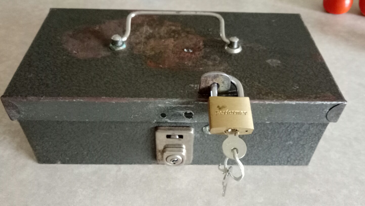

Post by Oldbloke » 10 Apr 2017, 1:29 pm
Just yesterday I repurposed this old cash box
I needed a box for just a few rounds.

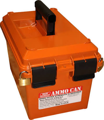

Post by on_one_wheel » 30 Apr 2017, 11:07 am
I don't believe that we have laws In Sa stating that we need to keep ammo locked in transit at the moment.
But for interstate travel I have one of these
images (8).jpg (21.05 KiB) Viewed 6446 times
