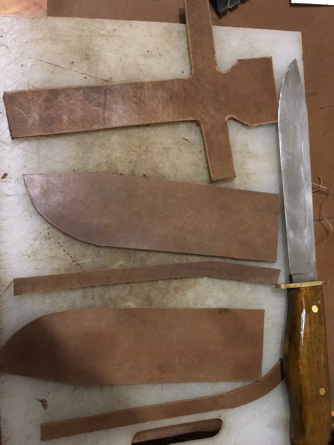

Having made the Bowie knife, now it needs its own sheath. These are its parts cut out and nearly ready for assembly. It'll be hand sewn as I haven't got a suitable sewing machine....yet. I bought a 1300 x 500 x 4 sheet of veg tanned leather off eBay. I have a few projects lined up.

You'll have fun pushing the awl through those 3 bits of heavy leather.
Buy something called a "Sailmakers Palm" to make it easier

just glue it and drill the holes,no need to bust a gut pushing a needle through leather, you have to glue the welt? (the bit that stops you cutting the thread whatever its called) in anyway ,small drill large needle,,an upholsterers needle is what i use but its double pointed so a no go with pushing it through with your palm :P looks like you have the bug, look forward to [url]all[url] the other knives, sheaths that you will have to make for friends,family, workmates :D :thumbsup:

tom604 wrote:just glue it and drill the holes,no need to bust a gut pushing a needle through leather, you have to glue the welt? (the bit that stops you cutting the thread whatever its called) in anyway ,small drill large needle,,an upholsterers needle is what i use but its double pointed so a no go with pushing it through with your palm :P looks like you have the bug, look forward to [url]all[url] the other knives, sheaths that you will have to make for friends,family, workmates :D :thumbsup:
I ended up marking out the 4 mm stitch length with dividers and pushing the awl in as far as it would go. Then I hammered a small nail right through and sewed it up using my "Speedy Stitcher" tool. Thought about drilling the holes and had go on some scrap but thought the holes looked a bit fluffy.Jobs not quite done. Pics tomorrow.
