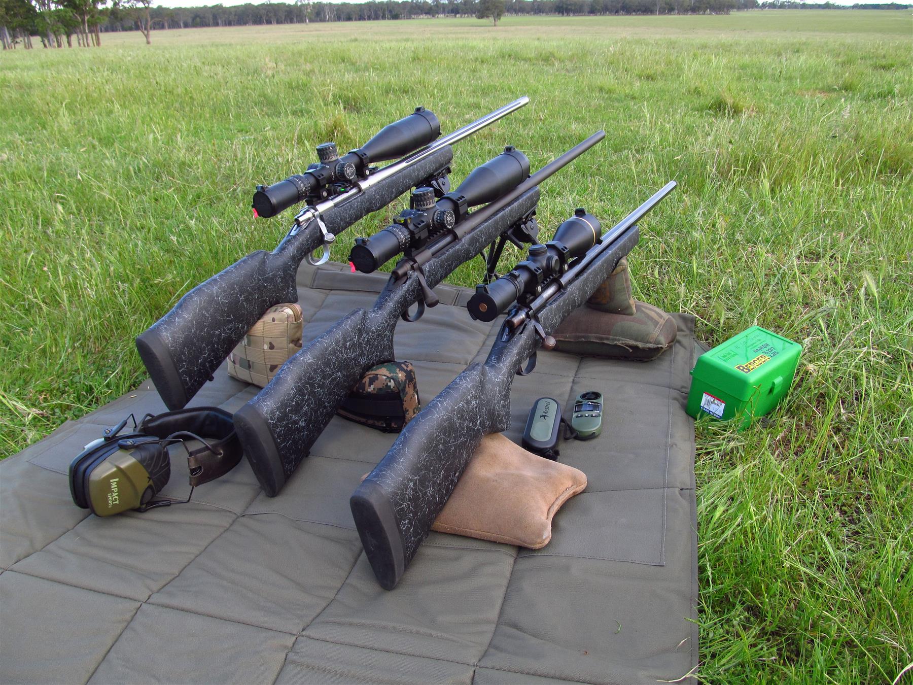

nearly as good as the one in the middle
IMG_2493 (Custom).JPG (500.89 KiB) Viewed 7744 times
both are NXS 5.5-22x56 one MOAR AND ONE MOART.........but i sold them and my cz 22 and bought this

Waaaaaaat...... Nooo. Nice boat though :drinks: What cals are the 3 rifles? I am looking at grabbing one, Sendaro SFII in 7mm Just not too sure on the Fluted barrel. What are the other 2 cals you have? I know one is the 7mm. Did you bed the stocks or do any extra work to get the 7mm shooting tight groups? At a guess you would be handloading.
Sorry for the 20 questions.
Sammy :thumbsup:

Sam45 wrote:Waaaaaaat...... Nooo. Nice boat though :drinks: What cals are the 3 rifles? I am looking at grabbing one, Sendaro SFII in 7mm Just not too sure on the Fluted barrel. What are the other 2 cals you have? I know one is the 7mm. Did you bed the stocks or do any extra work to get the 7mm shooting tight groups? At a guess you would be handloading.
Sammy :thumbsup:
7mm rem mag 260R and 223R .

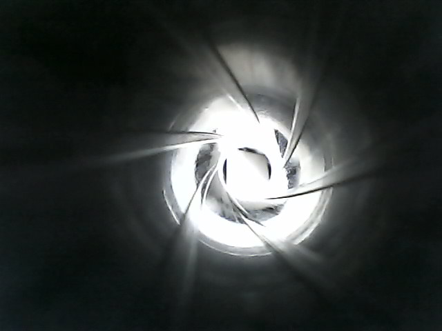

now i wouldn't buy a REMINGTON that came through raytrade if my life depended on it mine came from the US market
the barrel on the 7mm had a finish just as good as my maddco 264 barrel .
and this pic was taken after 450 rounds .
