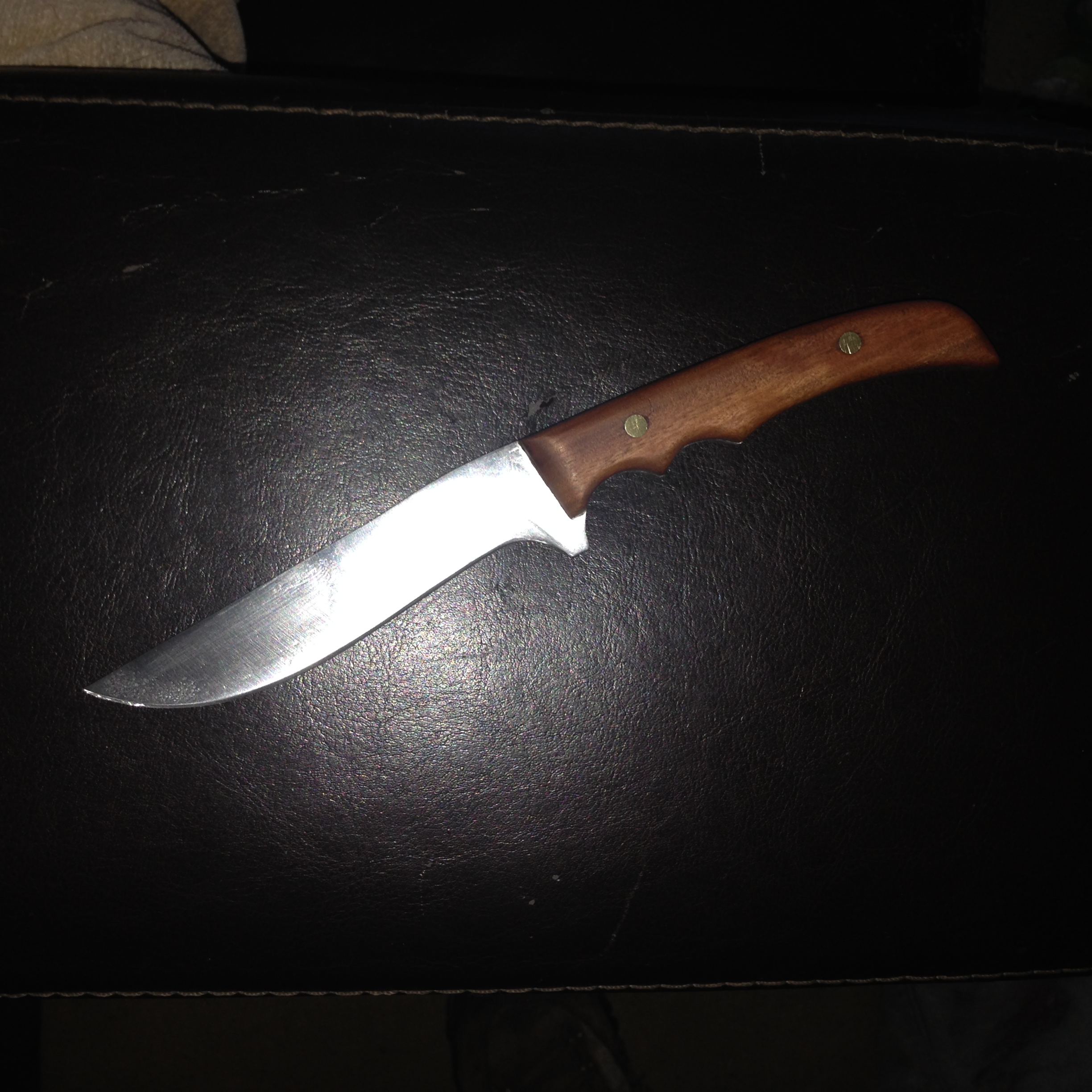

Below is the second one.

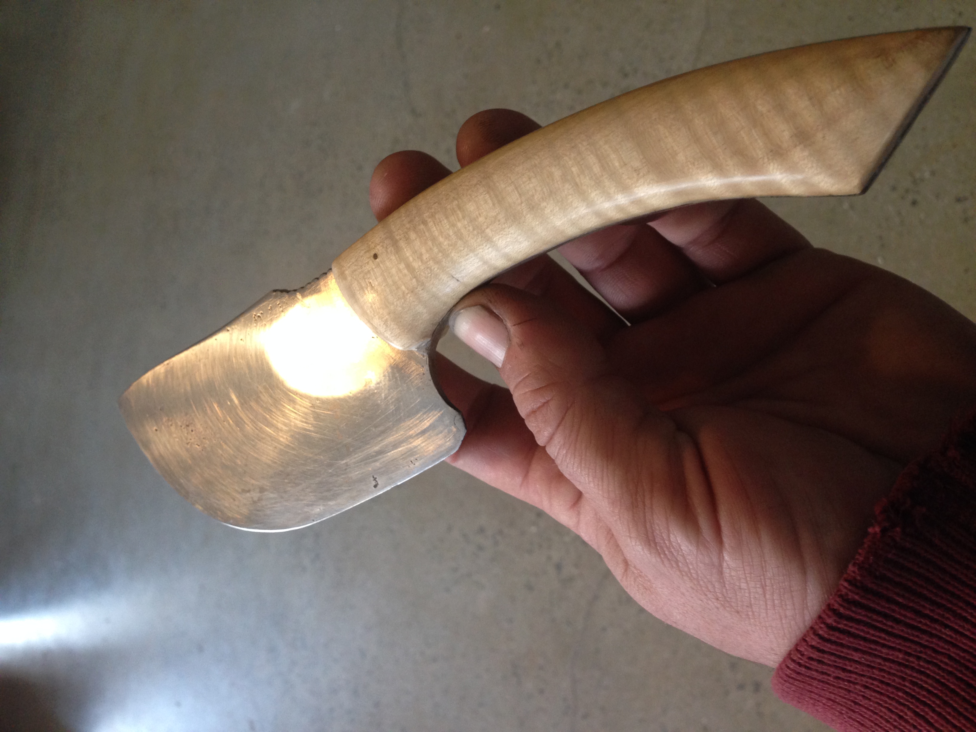

The one below took 5 hours with a belt grinder.

Really like the handle on the first one.
When is knife 3 coming :D
