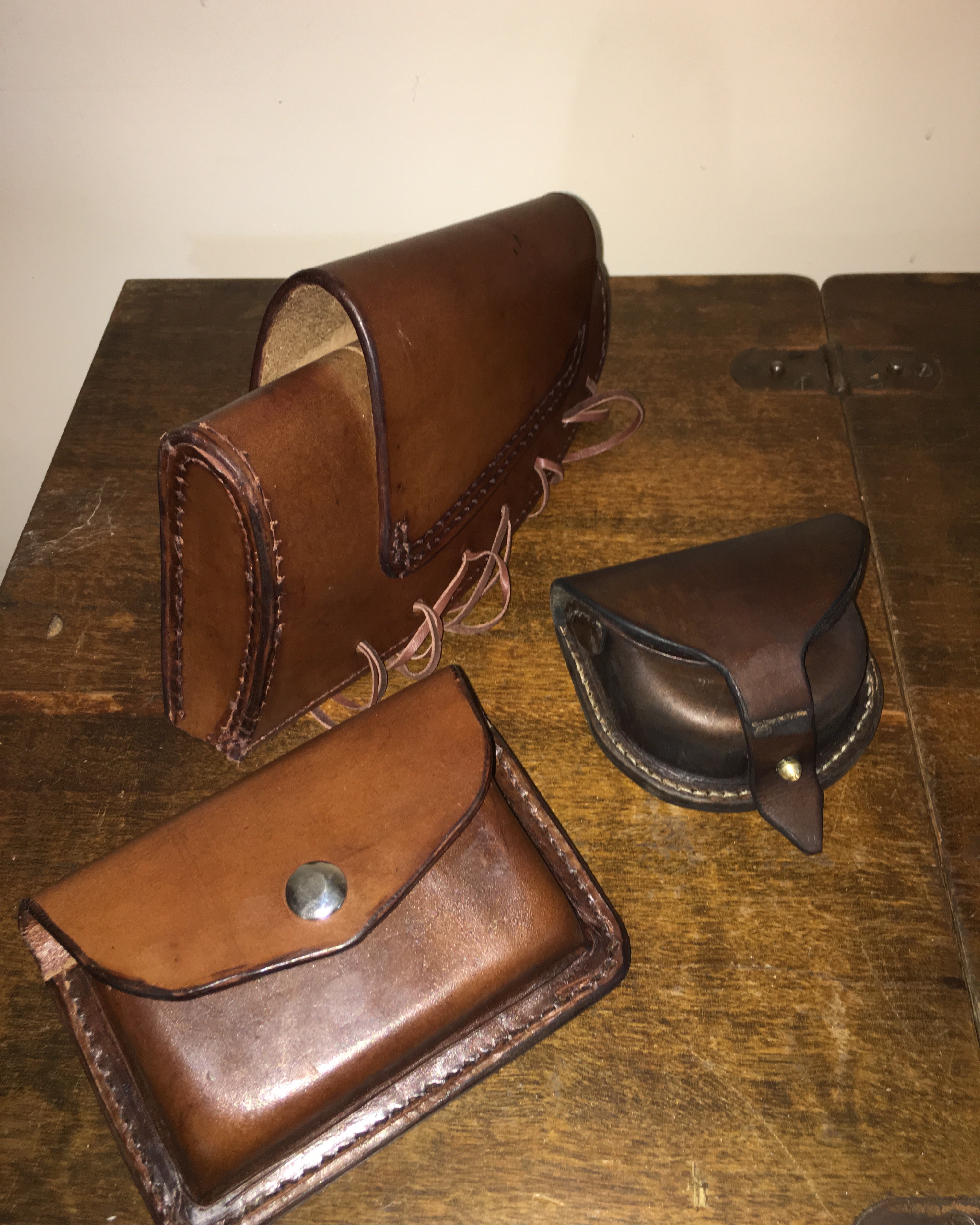

Post by Noisydad » 30 Dec 2016, 4:28 pm
I knew that damn "show is your knives"/ knife making thread would lead me astray and I still bloody read it anyway - you blokes have a lot to answer for!

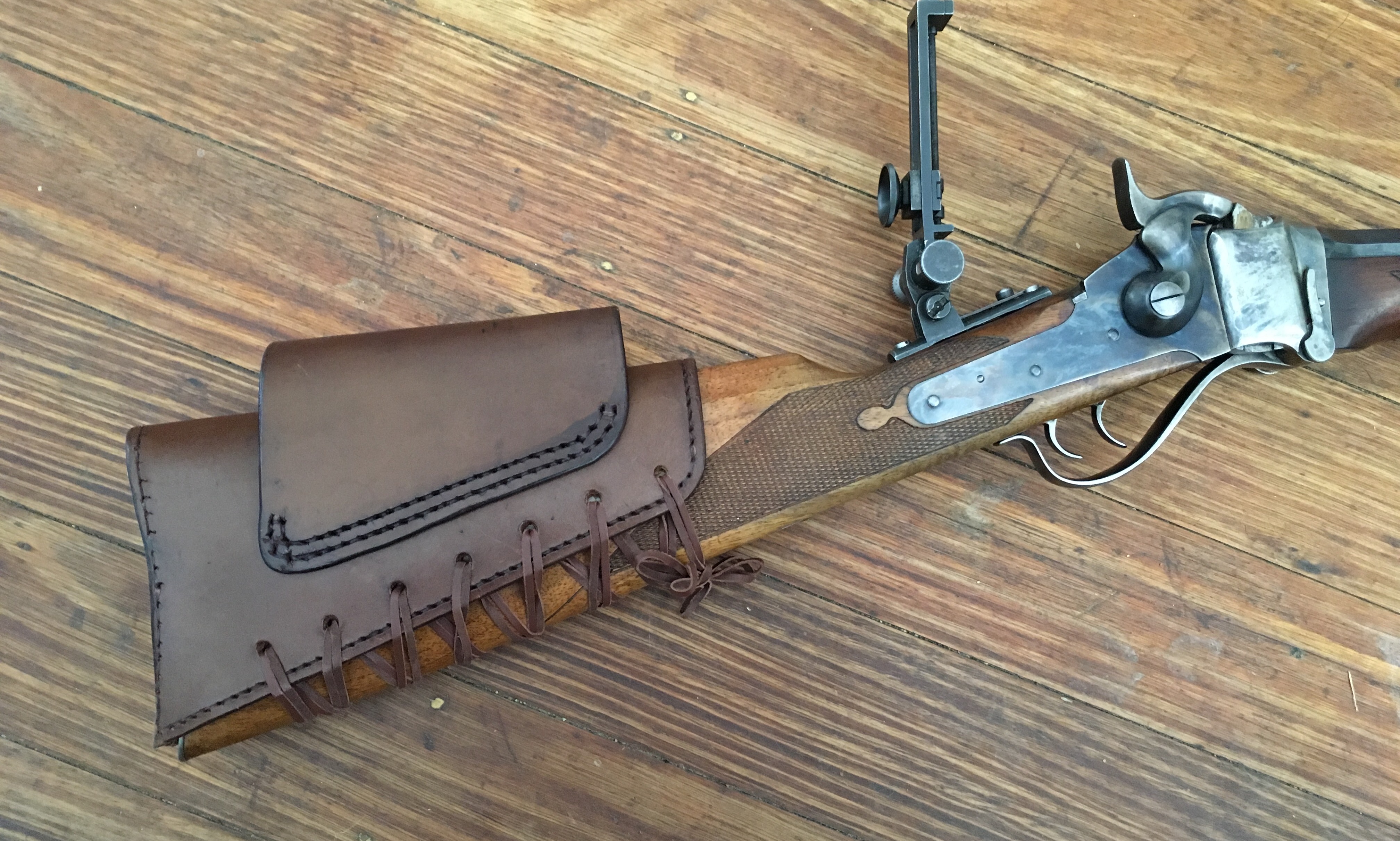

Here's some stuff I've been messing with;
The stock cover is for Lady Noisy's .45-70 (Pedersoli) Sharps which is a bit low in the comb when the vernier sights are raised to 600 yards. If she beats me with it on I'll be removing it :oops: The Ammo pouch and cap box are wet molded. The cap box was a fiddly sodding thing. I'll make a US civil war cartridge pouch to go with it.
Gotta say though that wet moulding leather is so cool!

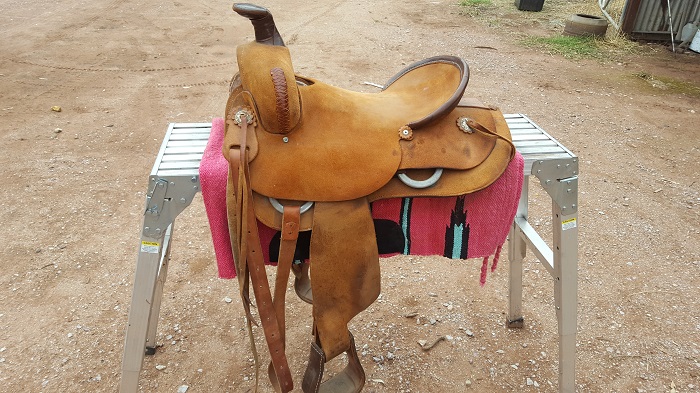

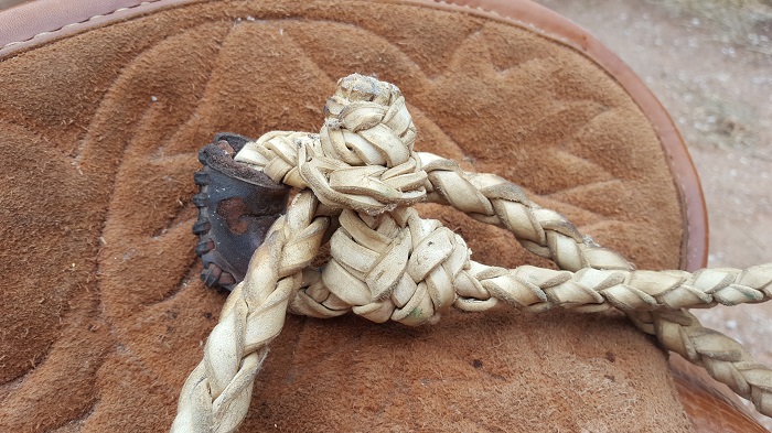

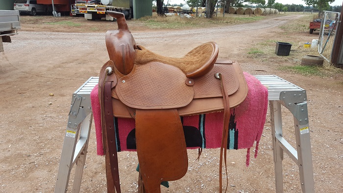

Couple of saddles I made back when I was working with horses. Made the first one when I was 17, second one when I was 23. Both fully handmade and stitched. I had spent time with an old-time saddler when I was 14-16 and learned basic skills from him. The other pic is of the Hondo on the end of a braided rawhide Reata ( Lasso) I also made when I was 17. Made that from the hide of a wild bull that was shot on a property near Bombala (NSW).
Ist saddle.jpg (169.26 KiB) Viewed 10449 times
2nd saddle.jpg (165.02 KiB) Viewed 10449 times
Re: Making leather stuff
Post by Noisydad » 01 Jan 2017, 5:42 pm
Now that's well done GR! There's a lot of hours in that leather!

Cool addition for the Sharps :thumbsup:

Post by Noisydad » 03 Jan 2017, 4:54 pm
We fitted the comb raiser/ cover and headed down to the range paddock to smack plough discs and LN says the rifle fits her way better and feels much more secure and easier to maintain a steady sight picture. This may turn out to be a bad idea come Comp season lol.

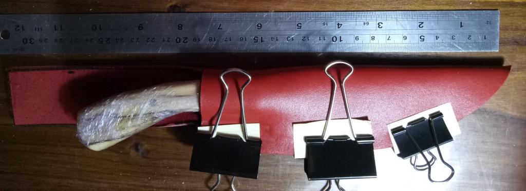

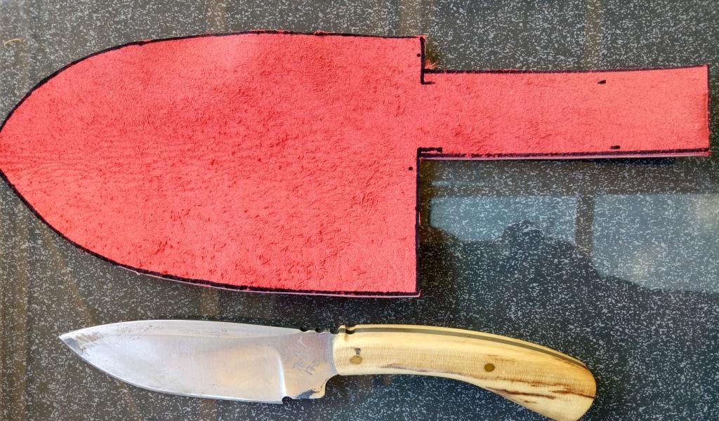

Post by Oldbloke » 03 Mar 2018, 5:17 pm

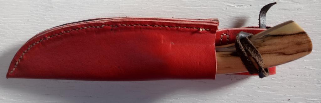

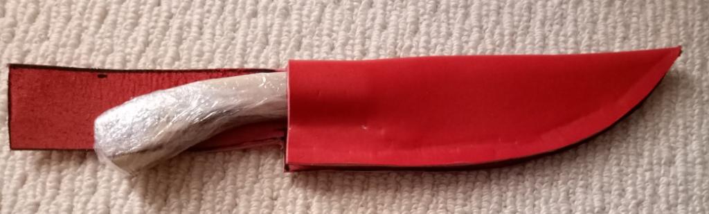

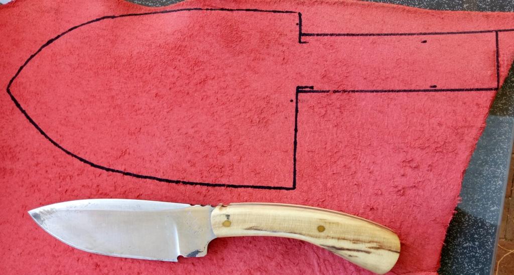

So old thread but thought Id show off what I have been doing. Obviously NOT professional.
A while ago Gwion was good enough to gave me one of his knives to test. So far Ive only scalped a couple of foxes, skun 1 rabbit and cut a few small branches with it off a sapling to create a hide. It looks like its going to be a great knife with terrific edge holding ability. So to save my fingers and look after it I decided it deserved a sheath.
Got some leather from the local tannery (very cheap at $11 for about 1/2 q sq meter.
here is a few pics in stages and final product, Not fantastic but happy with it as its my second go at leather work. The first was 25 yrs ago. :LOL:
Not as good as Noisy but worth the time.

Post by Daddybang » 03 Mar 2018, 5:34 pm
Nothing wrong with that OB. Looks like a good functional sheath. :thumbsup: :drinks:

Post by Noisydad » 03 Mar 2018, 6:44 pm
That’s the go! If you have a belt sander you can use that smooth of the edges level and even. Break the corners a little too. Once that’s done find a smooth tool with a little concave face on it. Wet the edge with spit and use the tool you found to rub the edges slick and smooth. This helps the appearance heaps.

Post by Oldbloke » 03 Mar 2018, 9:29 pm
Noisydad wrote:That’s the go! If you have a belt sander you can use that smooth of the edges level and even. Break the corners a little too. Once that’s done find a smooth tool with a little concave face on it. Wet the edge with spit and use the tool you found to rub the edges slick and smooth. This helps the appearance heaps.
Yep, plan on just using a cork block and sand paper. Then some neats foot oil.
