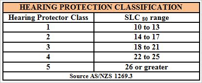

There is some good info at these locations.
http://www.howardleight.com/hearing-protection/articles
https://www.worksafebc.com/en/resources ... ring-video.
Chronos is correct the 3 ratings are all different. I found this at the first web site.
Ratings explained.JPG (88.66 KiB) Viewed 12154 times
If you had 3 sets of muffs and all were rated 33 dB attenuation then you would rate them likes this. 1 = best 3 = worst
1. SCL 80
2. NRR
3. SNR
So the muffs fpr $110 are SNR 33 dB are equal to about 26 dB they are a low end Class 5. Still good value but for serious target shooters probably not good enough. By wearing a pair of ear plugs under the muffs you will increase the protection by about 5 to 7 dB if worn correctly which few people do. Also generally speaking, due to the nature/physics of sound the higher the class/attenuation the bulkier they are. Hope this helps,

It helps a lot, thanks. The product specifications sheet that I downloaded shows SLC80@ 31db
Given that the price jump between these and anything that might be better quality is 4x, I think I'll buy a pair and see how they go. Worst comes to worst and they are too bulky for shooting they'll get used in the shed and when teaching my boy etc.
I'll let you know how they go
