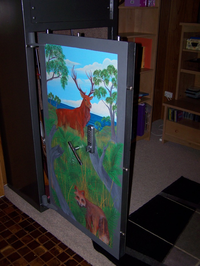

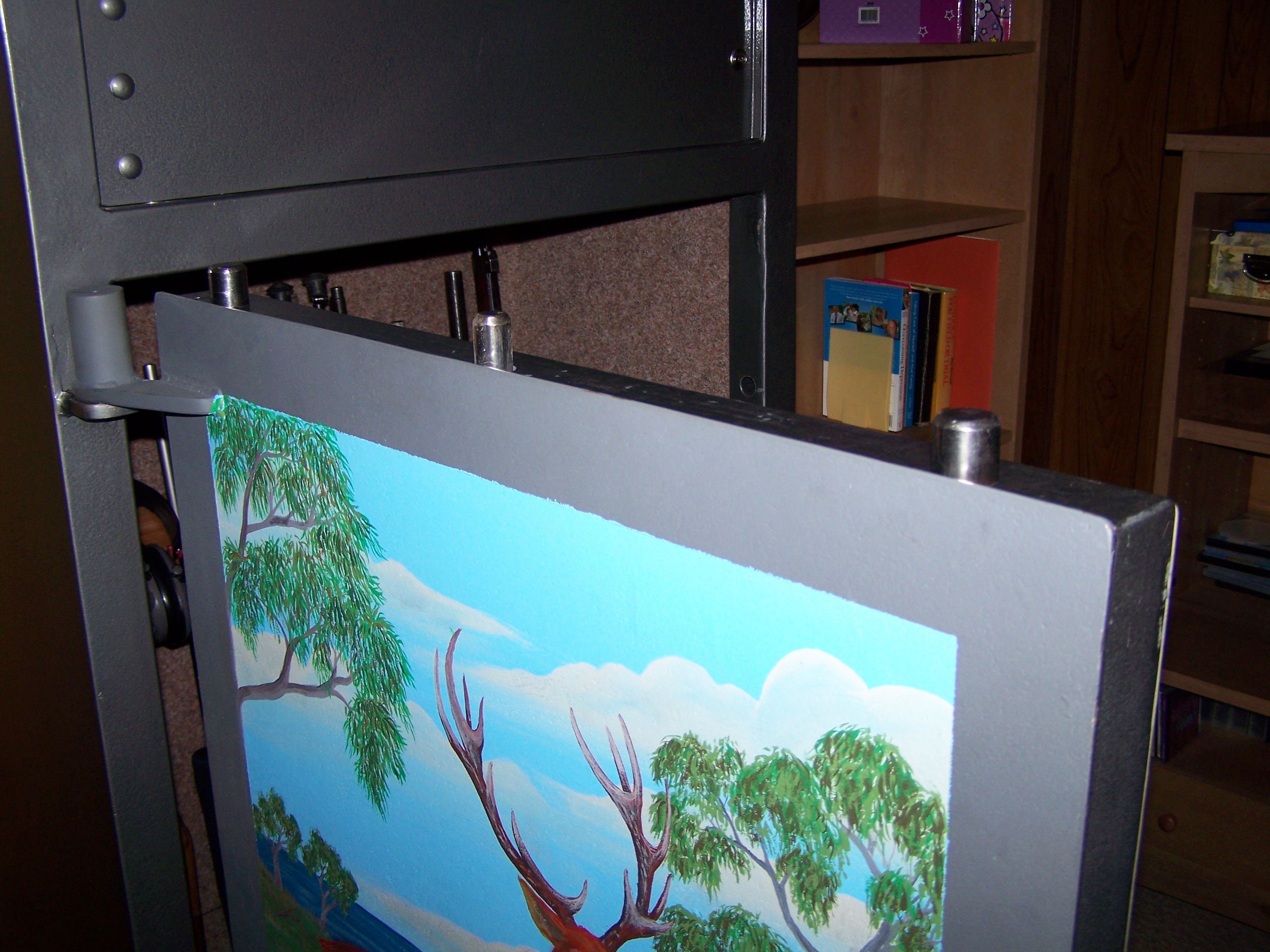

This isn't the 1st time I've put some of these pics up, but Hey, it saves time for other people searching.
I built this in 2007, and it served me well till I bought an American safe and bolted the two together from the insides.
And Gwion,, if you want to make your own,, here's an idea.
Use 100 x 100 x 6 or 8 mm angle iron.
Make three separate sides (a bit like door frames) and two separate top and bottoms.
Weld 6 or 8 mm plate across the frames.
Weld appropriately positioned bolts (in countersunk holes) into the sides and top, and then grind the surface flat so there is no visible sign of bolt heads.
By using other angle iron pieces, you can then bolt it all together from the inside. :thumbsup:
That way you can make each individual "wall" as heavy as you can manage,, and when its all together,, its certainly not able to be picked up.
Then in years to come if you shift,,,, simply unbolt it and move it piece by piece.

Nice safe build too :thumbsup: BTW. lock looks like an analogue keypad Lockwood ?.. They are quite a good lock and can be re-coded.
Also, who the hell painted the safe door ?.. And feel free to send them by to do some work for me..... :D Impressive work !
If you look closely at the last pic,, just to the right of the keypad latch lever (approx 3") you will see a key hole in the smaller vertical branch.
That is a manual "safe" keylock, that also locks the workings of the other lock.
Sort of a backup to the backup.
As for the artwork, I would love to be able to lay claim to doing that,,,,, but no it wasn't me.
It was done by my Tattoo man, "Bags" in Sth Aust.
All I did was show him the pic of the big red that appeared on the cover of an issue of Sporting Shooter magazine, and he painted it as you see it.
I always ask people that are looking at it if they can see the feral pig in it, can you ?
