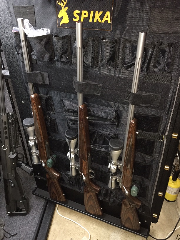

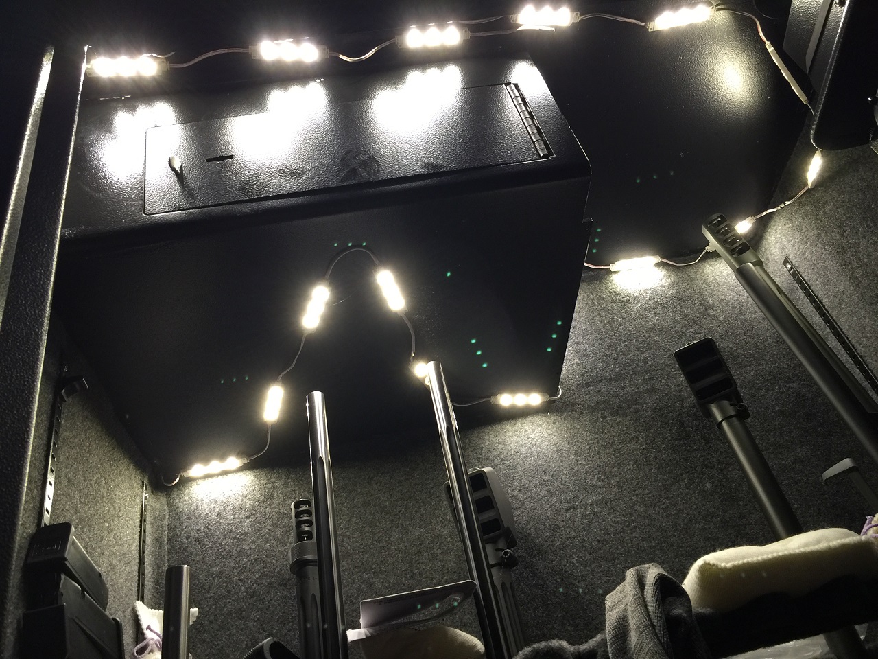

Post by brett1868 » 20 Sep 2017, 3:36 pm
I have a couple of LCH2's amongst others, I drilled a hole on the back and fitted a 12v socket Jaycar Part No.PS0522 and wired up some 12v LED lights on the inside. Add a 2A 12DC plug pack and lighting problem solved, I leave the lights on permanently as the little heat they generate helps prevent condensation and rust. For the door on 1 I removed the rack and fitted a large sized Spika safe door organiser.
Lights
Organiser

Post by TBJ » 20 Sep 2017, 5:54 pm
thanks for the pics looks good
