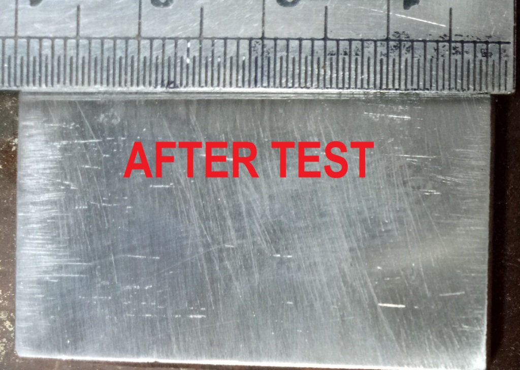

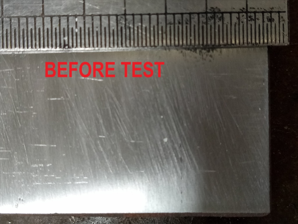

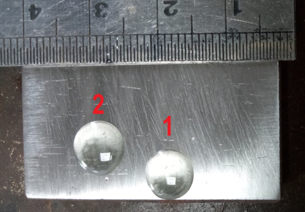

So today I carried out a basic corrosion test using Sweets 7.62 on mild steel.
The results I think speak for them selves. However it’s a short time frame test so leaving it in the barrel for a couple of weeks could give a very different result.
1 was left for 1 hour 2 was left for 3 hours. A picture tells a thousand words.

What are you using as a testbed? Stainless (416?), CrMo? Mild Steel? The most corrosive aspect of Sweets is ammonia's affinity for water, not adequately removed after use and the highly hygroscopic properties of ammonia residue will cause rusting in a humid atmosphere. I have seen the results of 12 month immersion of 440C in Sweets, nothing. Nothing at all. Don't mix with Shooters Choice, due to a chemical reaction between the 2 products that can promote rapid rusting. Enjoy your science, the Nobel Prize awaits!!
Posts: 2342
Re: Sweets 7.62 Corrosion test
Post by Oldbloke » 31 Jan 2018, 8:50 am
Mild steel. Letting one go for about 24 hours now. I expect the same result. We will see.

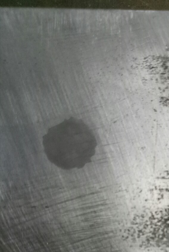

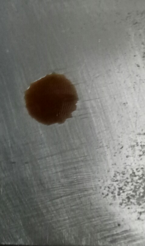

Post by Oldbloke » 02 Feb 2018, 9:08 pm
So these are 50 hours. Just a drop in mild steel. Looked like rusty liquid. Wiped it off and clearly there is at least "some" corrosion.

So pretty well as long as you give it a good wipe and re oil everything will be fine
This was actually supesuper helpful cheers OB
12G > Anything else
Bushie
Posts: 157
Post by Oldbloke » 02 Feb 2018, 9:31 pm
Yes. I'd say it would take 12 or more hours before you need to worry.
Leaving sweets to soak in the barrel for up to an hour should be very safe. Clean it all out then oil it.
