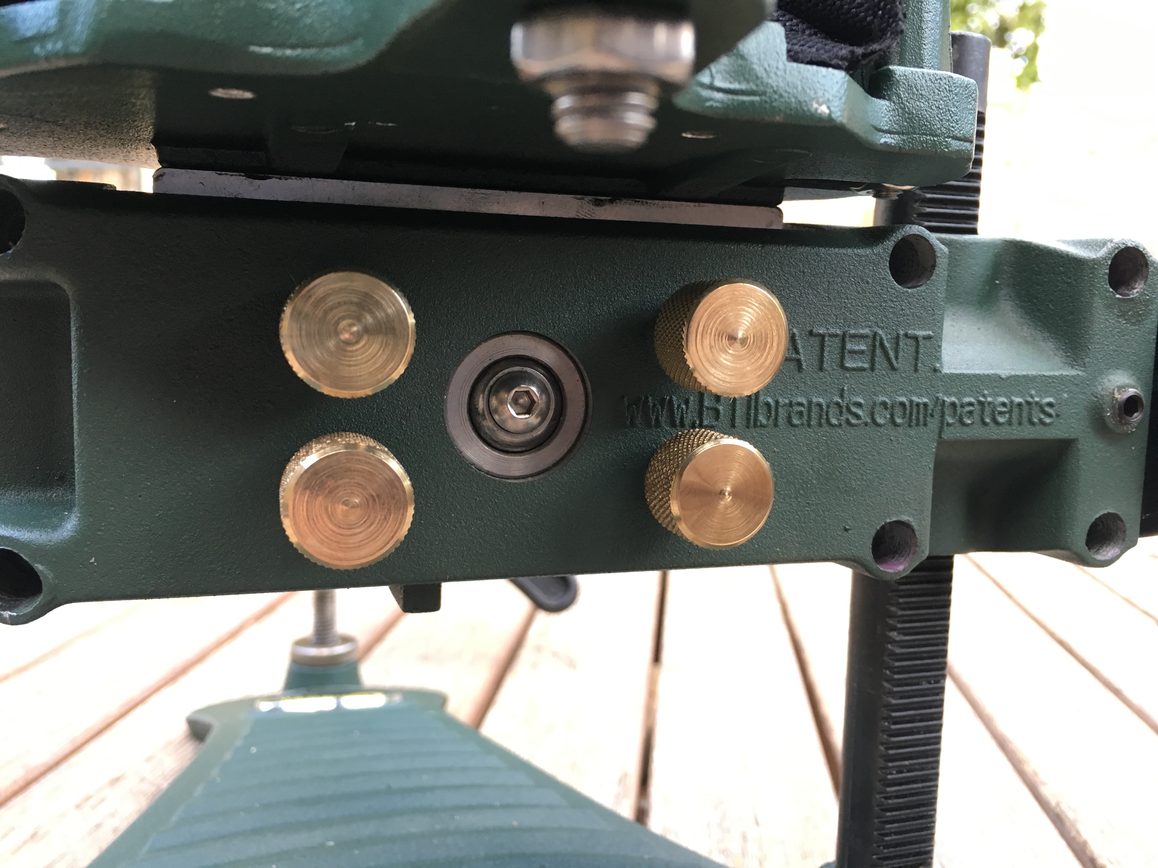

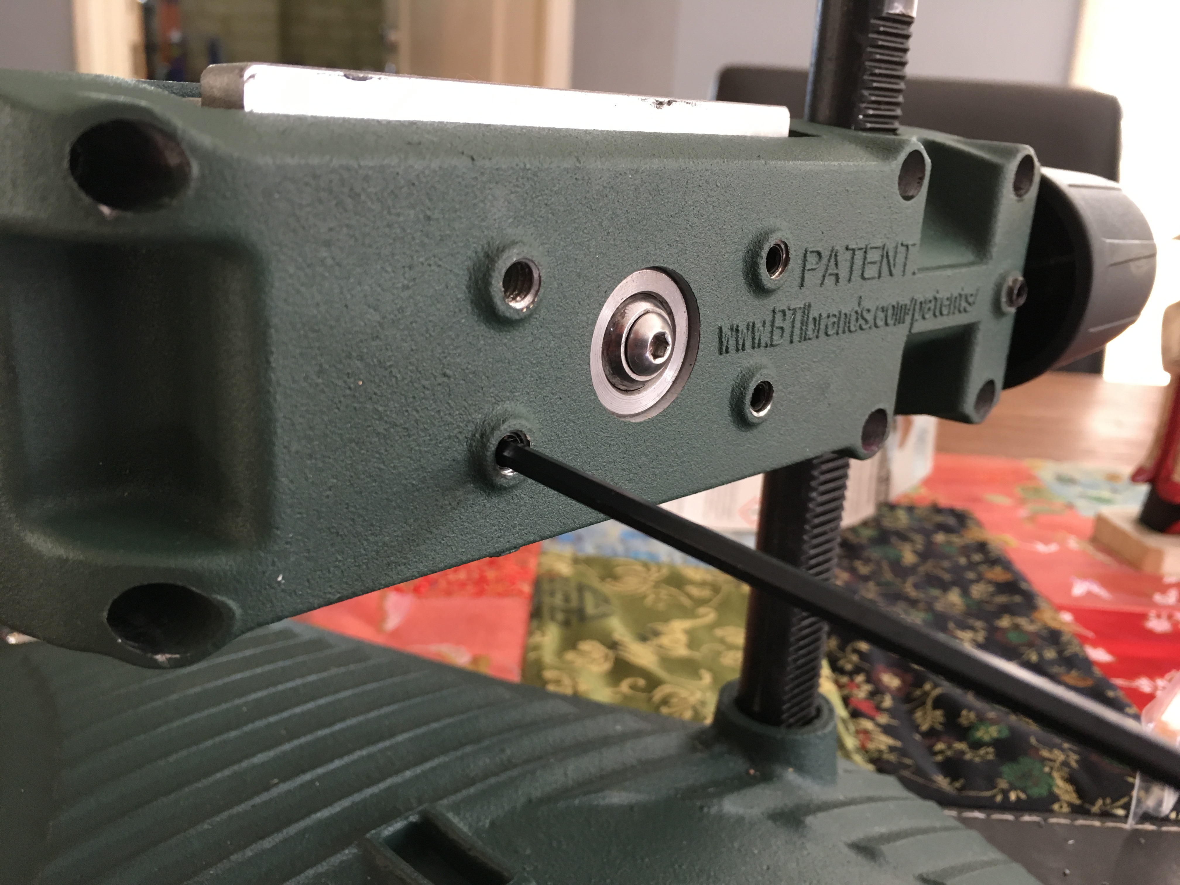

As this Rest is a Joystick Rest it has 4 tension screws on the front that require a Alan key to adjust , being a cheap rest constant adjusting is required for smooth operation with different guns of different weights , they can also vibrate lose in hte car ,, and if you forget the alan key well your gunna hate your day at the range
here is how it is adjusted stock

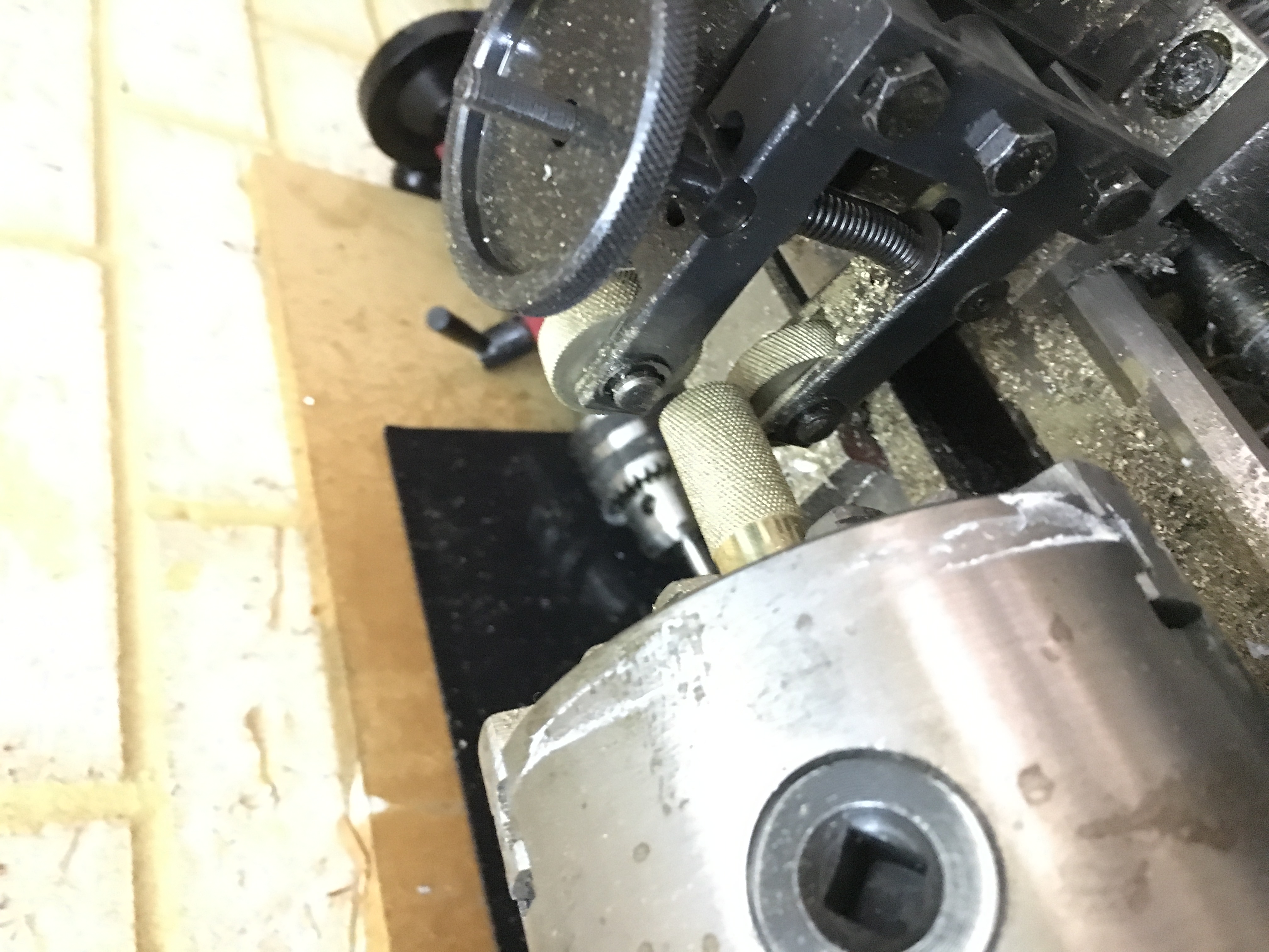

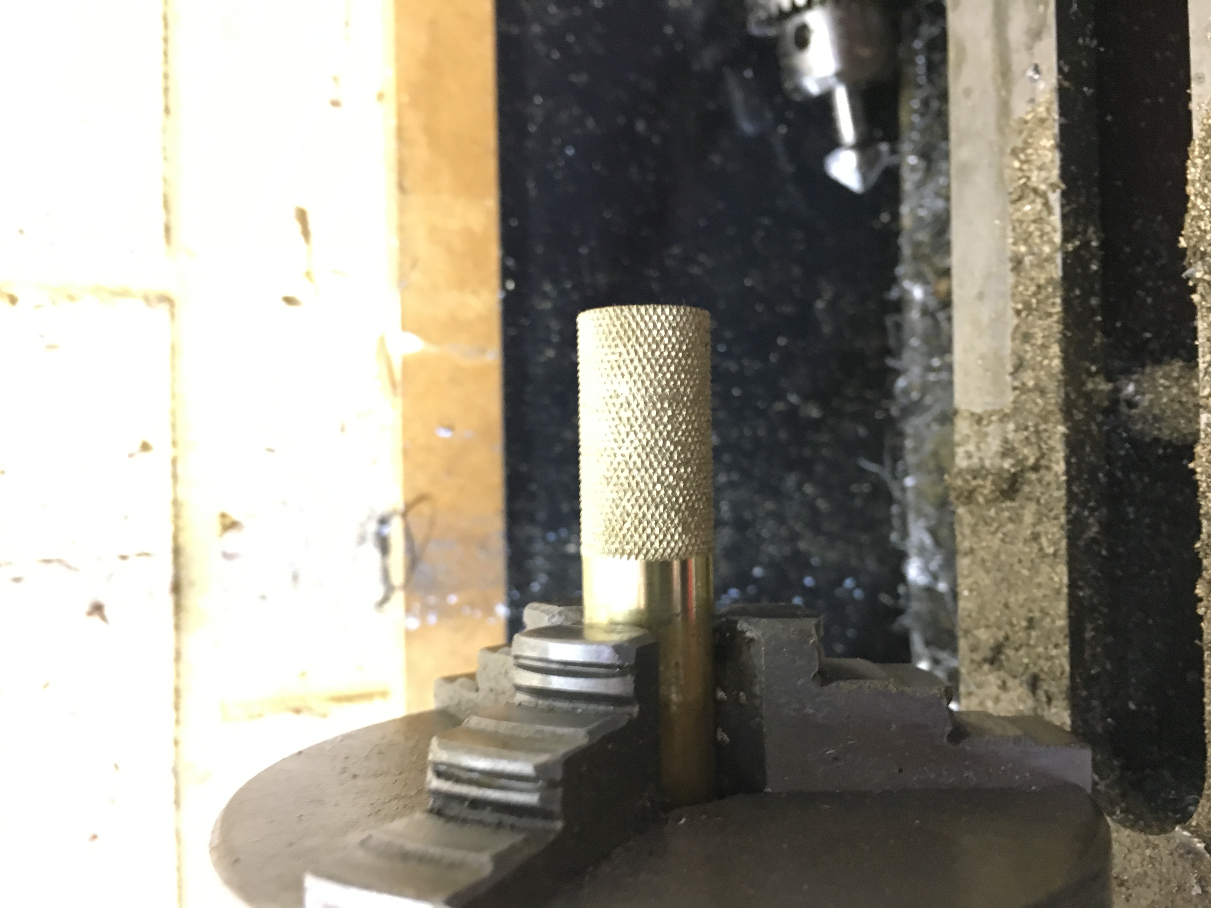

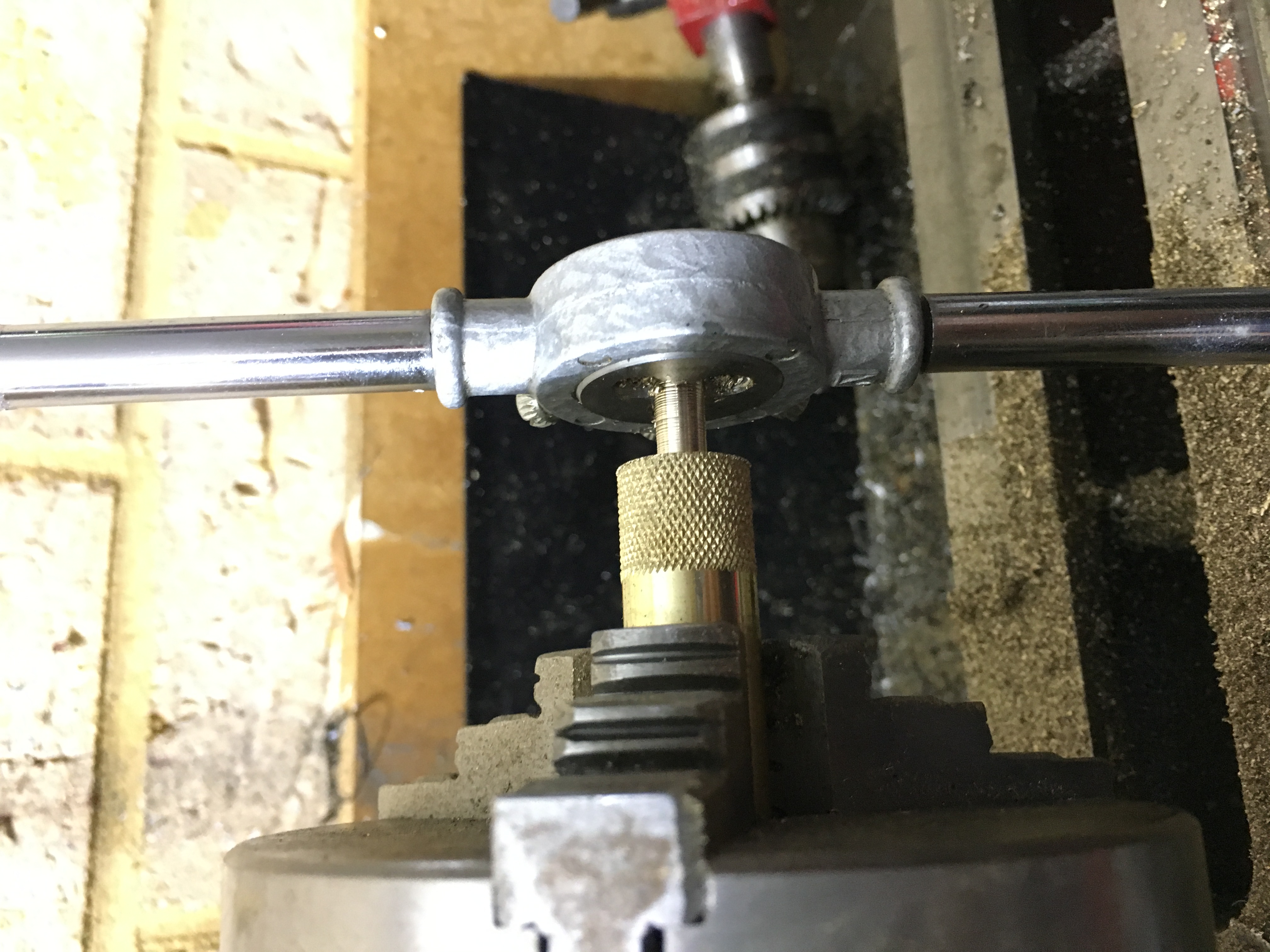

So i decided to use my mini lathe to turn up some Brass screws i could Adjust with my Fingers

Post by eddahenry » 02 Feb 2018, 9:20 pm
they cam up really nice and are very functional

Post by Mongrel » 02 Feb 2018, 10:01 pm
very nice, they came up a treat

Post by bigfellascott » 03 Feb 2018, 10:23 am
That's a ripper idea mate, if you make any extras I'm happy to buy em off you for mine. :D

Post by RoginaJack » 03 Feb 2018, 12:07 pm
Bloody marvellous!

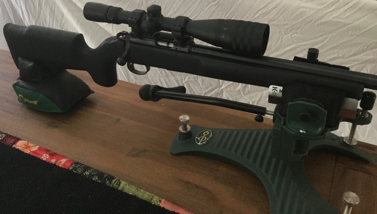

Tried it at the range today ..
Spot on
set up the rests and bags ,, put the rifle on it ,, tried the joystick ,,, mm needs a little more tensions ,, 2 seconds later done, Shoot
Funny thing Bigfellascott there where 3 guys at the range with them that said the same thing LOL

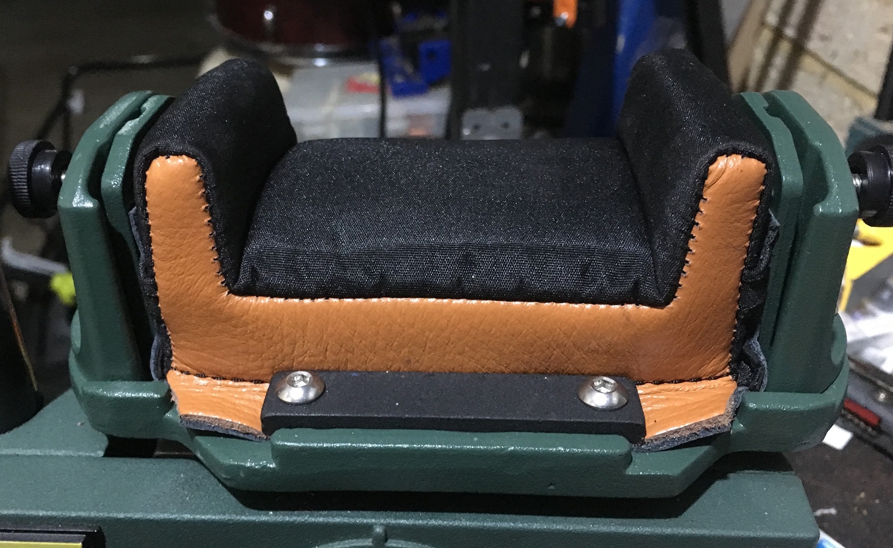

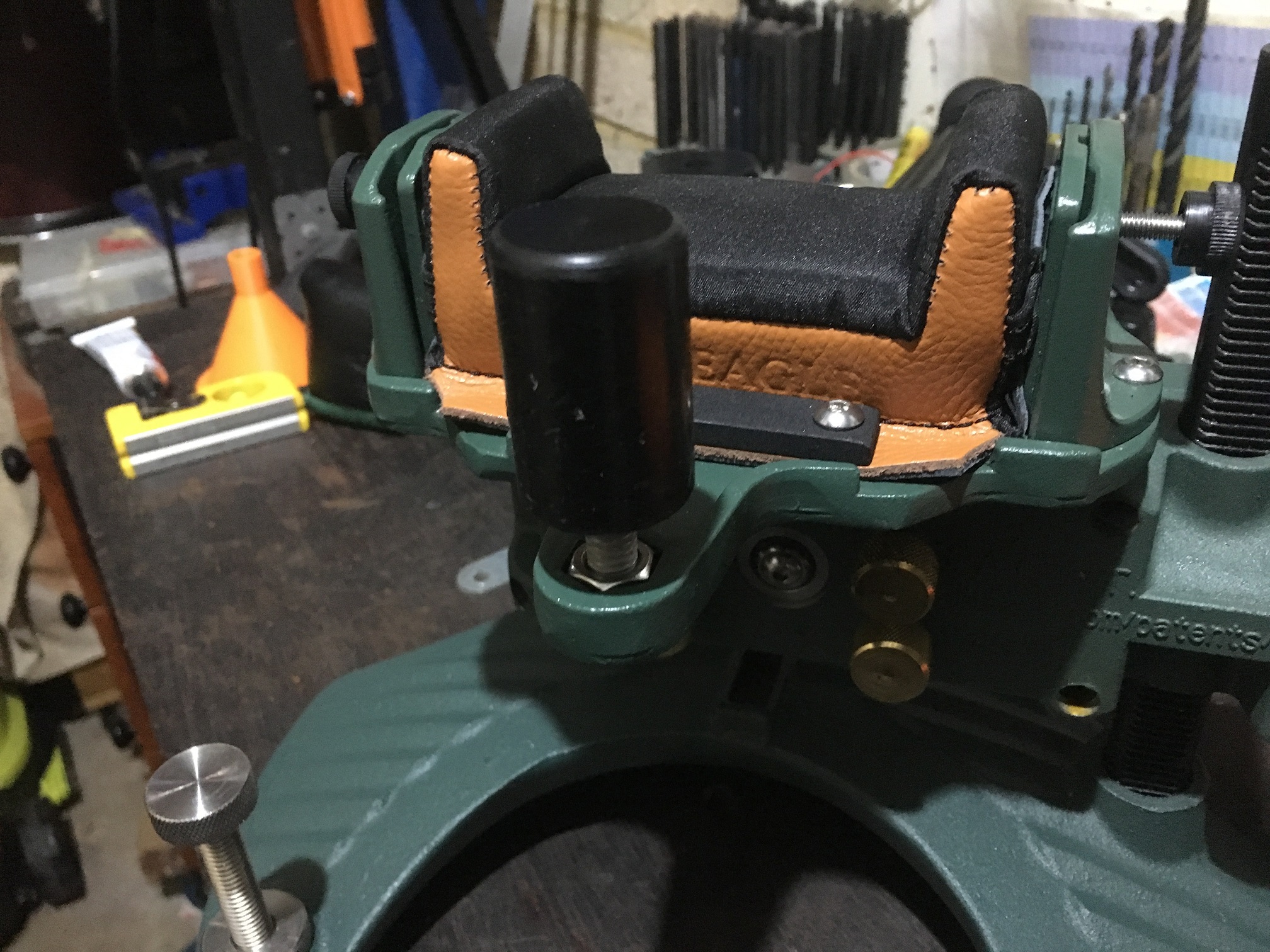

my 3 lob 3 inch bag split the other week ,, but no tears where shed as it was a massive pile of poo , looked high and low to find a bg that may fit ,, saw the Bald Eagle 3 inch bag and looked at the specs and went mmmmmm it ill be close
and it was but its fits ,, winning
also made a delrin front stop to replace the rubber one that was now to short

Post by bigfellascott » 24 Jun 2018, 10:15 pm
Very nice little mod mate, well done it looks fantastic. :thumbsup:
